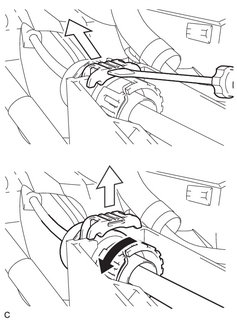

Using a screwdriver, pull out the stopper of the transmission control cable.
NOTICE:
Do not remove the stopper. If the stopper is removed, reinstall it to its original position.
Rotate the nut counterclockwise approximately 180°, and while holding the nut in place, disconnect the transmission control cable from the shift lever retainer.

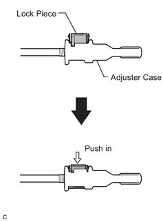

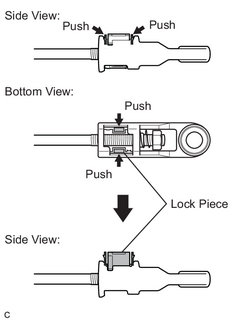

Push the 2 claws together at the top of the transmission control cable lock piece. While holding the 2 claws together, push the 2 lugs on the bottom of the lock piece toward each other and upward to pull out the lock piece.

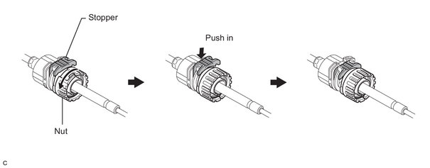

Turn the nut of the transmission control cable 180° counterclockwise. While holding the nut in place, push in the stopper until the stopper clicks twice.

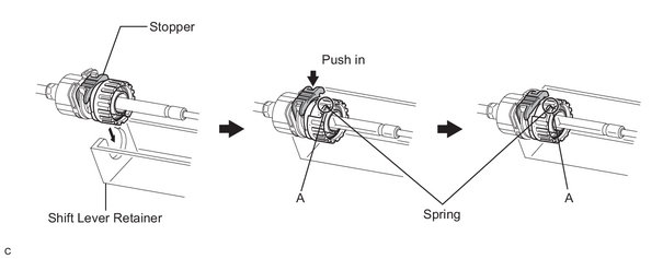

Install the outer part of the transmission control cable to the shift lever retainer. Check that the spring is positioned at "A" and push in the stopper.
If the stopper cannot be pushed in, slightly turn the nut clockwise and then push in the stopper again.

Push the lock piece into the adjuster case.
NOTICE:
Securely push in the lock piece until it locks.
