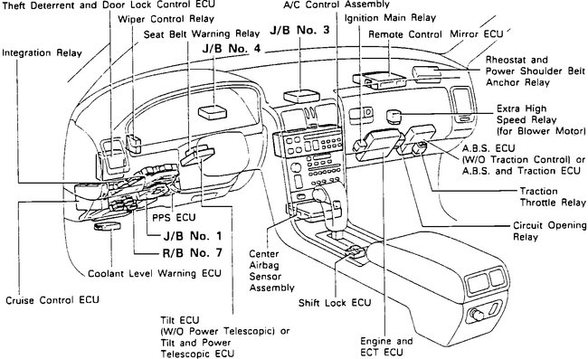

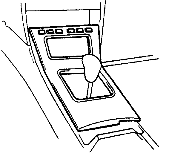

The shifter doesn't shift out of park without the override button which i wouldn't have a problem with except the override has become finicky and difficult to get it out of park even with the override. I'm told it's a relay in the shifter not letting it shift out of park and I'm trying to find out where that is.

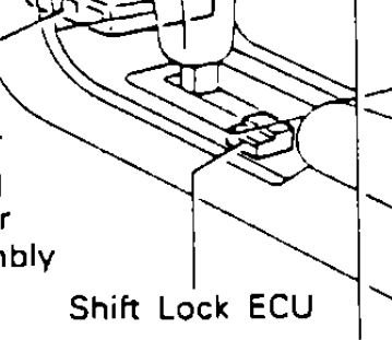

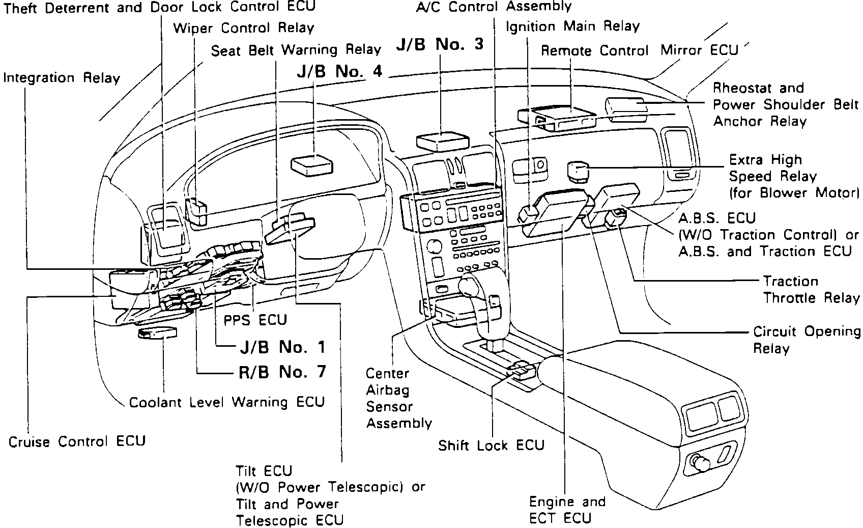

The shift interlock control module is in the center console. See the attached pictures.
Picture 3 is a wiring schematic of the system. I'm adding it in case it's needed.

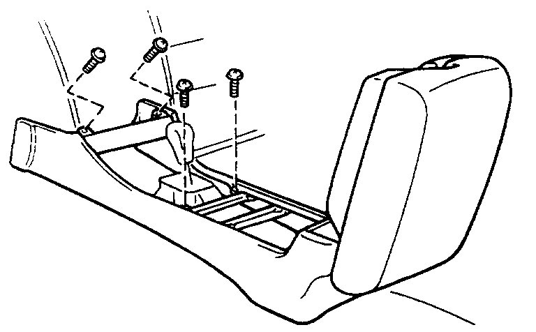

Here are the directions for removal of the console. The remaining pictures correlate with the directions,
PROCEDURES
picture 3
1. REMOVE CONSOLE BOX
HINT: Tape a screwdriver tip before use.
(a)Using the screwdriver, pry out the cluster finish panel, and after disconnecting the connector, remove the Panel.

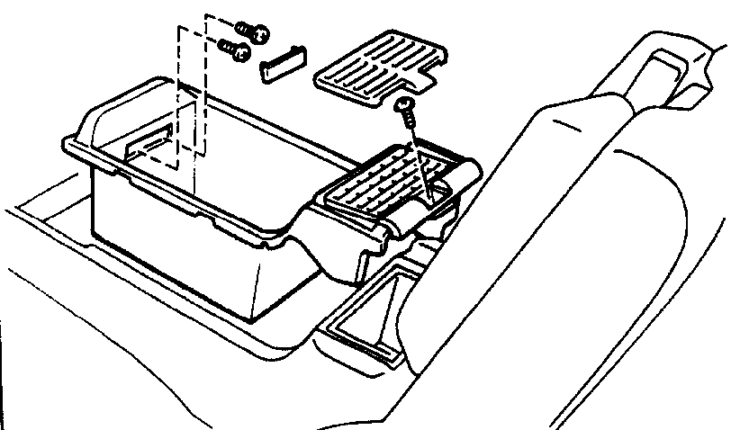

picture 4
(b)Using the screwdriver, pry out the lower console cover.
(c)Using the screwdriver, pry out the cover.
(d)Remove the 3 screws and lower console box.
(e)Remove the 4 screws and cup holder.

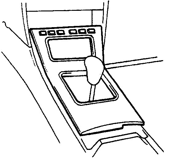

picture 5
(f)Remove the 4 screws and the console box.
Installation is in the reverse order of removal.
