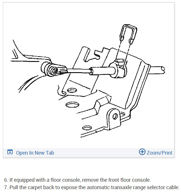

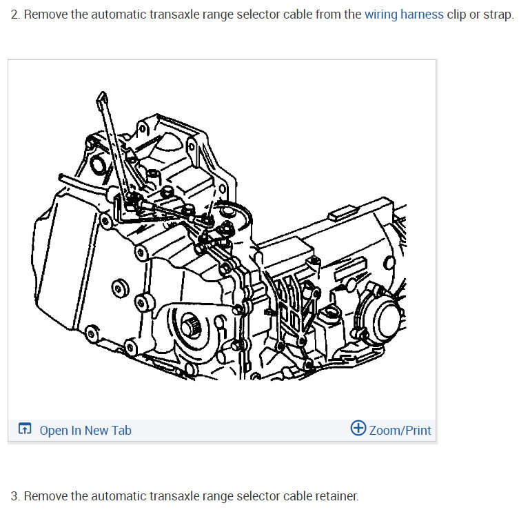

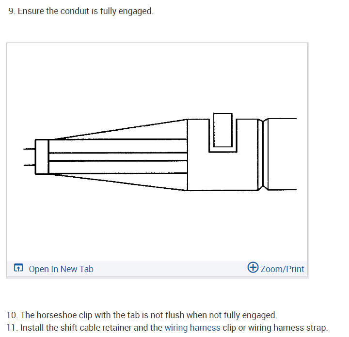

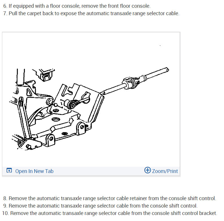

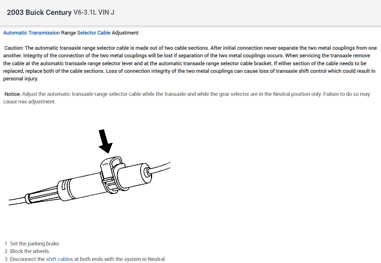

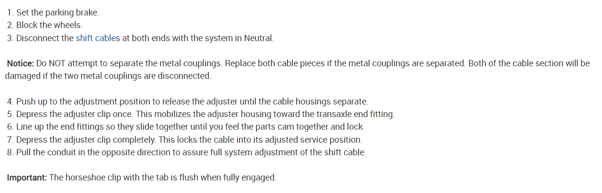

Where and how the shifter cables connect to the transmission?
175,000 MILES • 3.1L • V6 • 2WD • AUTOMATIC
VAL WENNERSTROM

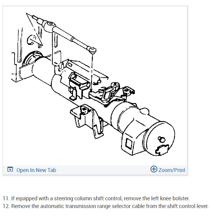

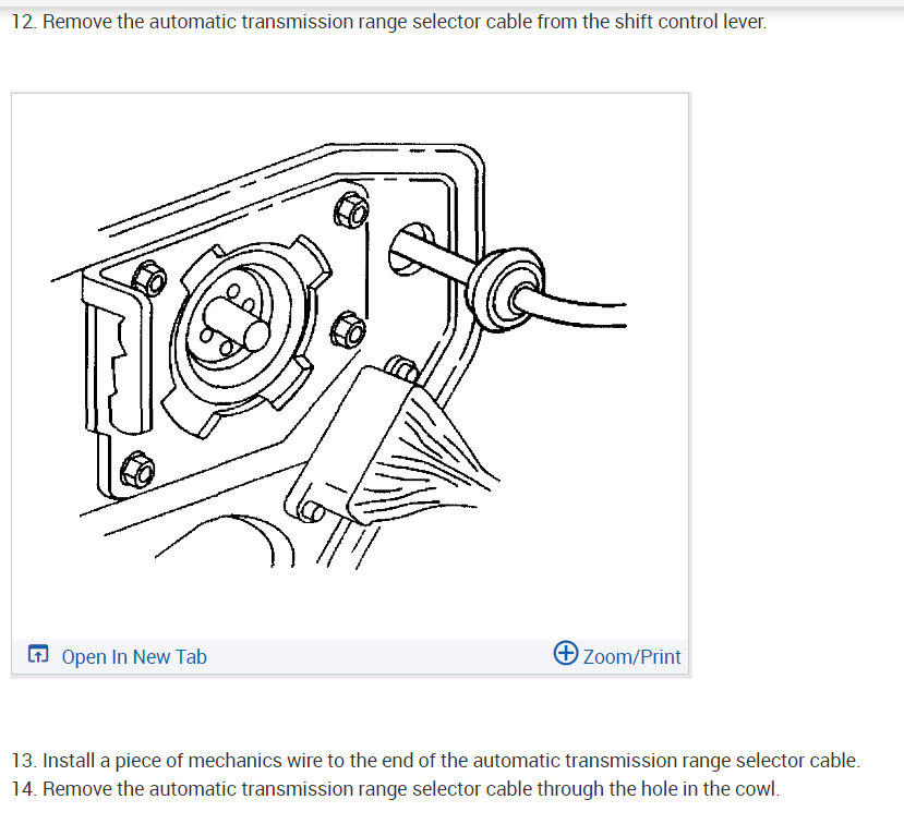

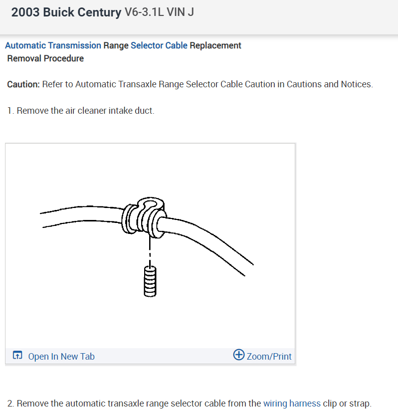

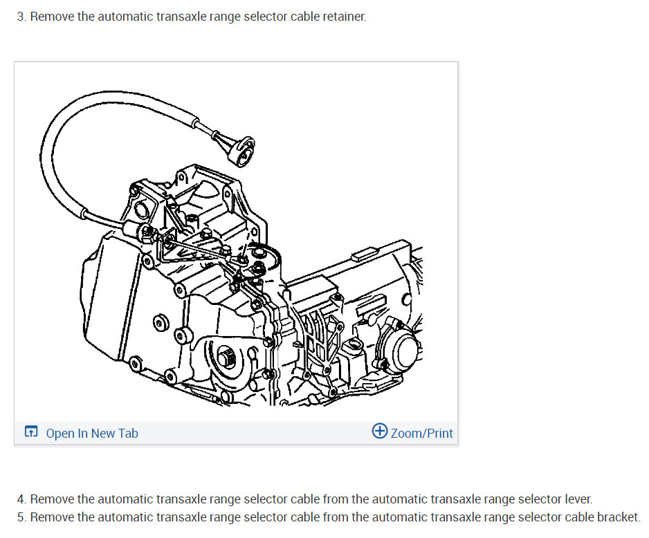

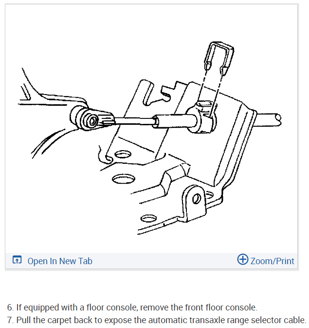

I need to know where and how the shifter cables connect to the transmission.
Sep 27, 2024 at 12:57 PM
  • 55,673 POSTS
Sure, here are the instructions for the floor and column mounted shifter cable replacement and I included how to adjust it as well. Check out the images (below). Let us know if you need anything else.
