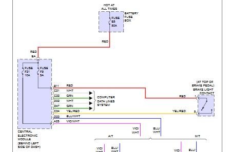

Check brake light switch and the three fuses as shown in the picture, start here and post back with findings if more assistance is required.

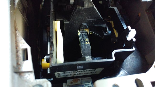

How do I remove the cover to get to the solenoid? My brake lights are operational. I am thinking the solenoid is gunked up.
Mar 6, 2017 at 9:32 PM
MSMCCORKLE
  • 33 POSTS
This is what it looks like under the cover.
Mar 6, 2017 at 9:47 PM
MSMCCORKLE
  • 33 POSTS
Okay, I was able to take everything apart and I got it to work. Problem is, now the shifter is loose and I can pull the whole thing up. How do I tighten it back the way it was before?
