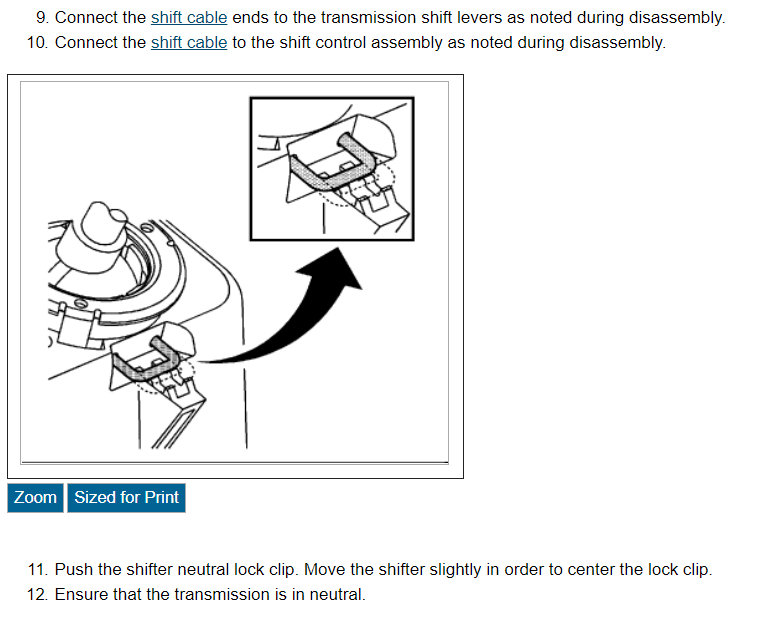

I have replaced the clutch in transmission and had to take shifter out of transmission itself I am trying to replace the shifter back in transmission but I cannot get it to seat all the way in. What am I doing wrong? It is the unit that the linkage is attached to on the bell housing.
Jun 15, 2018 at 2:52 AM
  • 55,224 POSTS

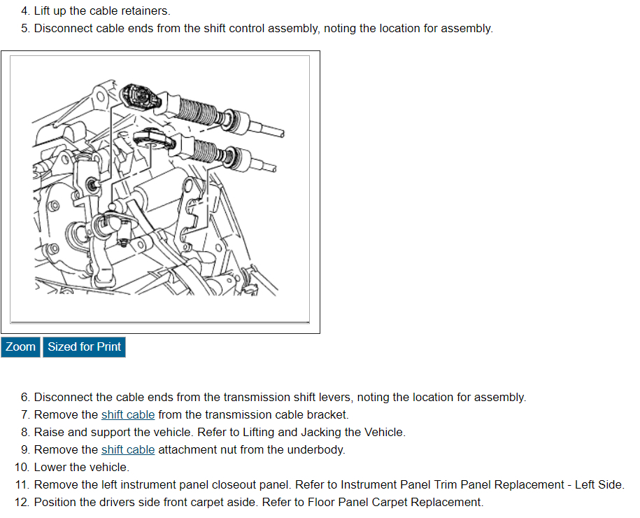

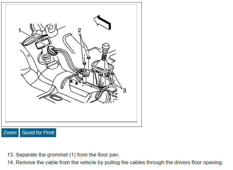

Hmm, this car has cables no shifter inside the transmission. Here is what I show. Can you send pictures of what you are talking about?
Check out the diagrams (below). Please let us know what you find.
