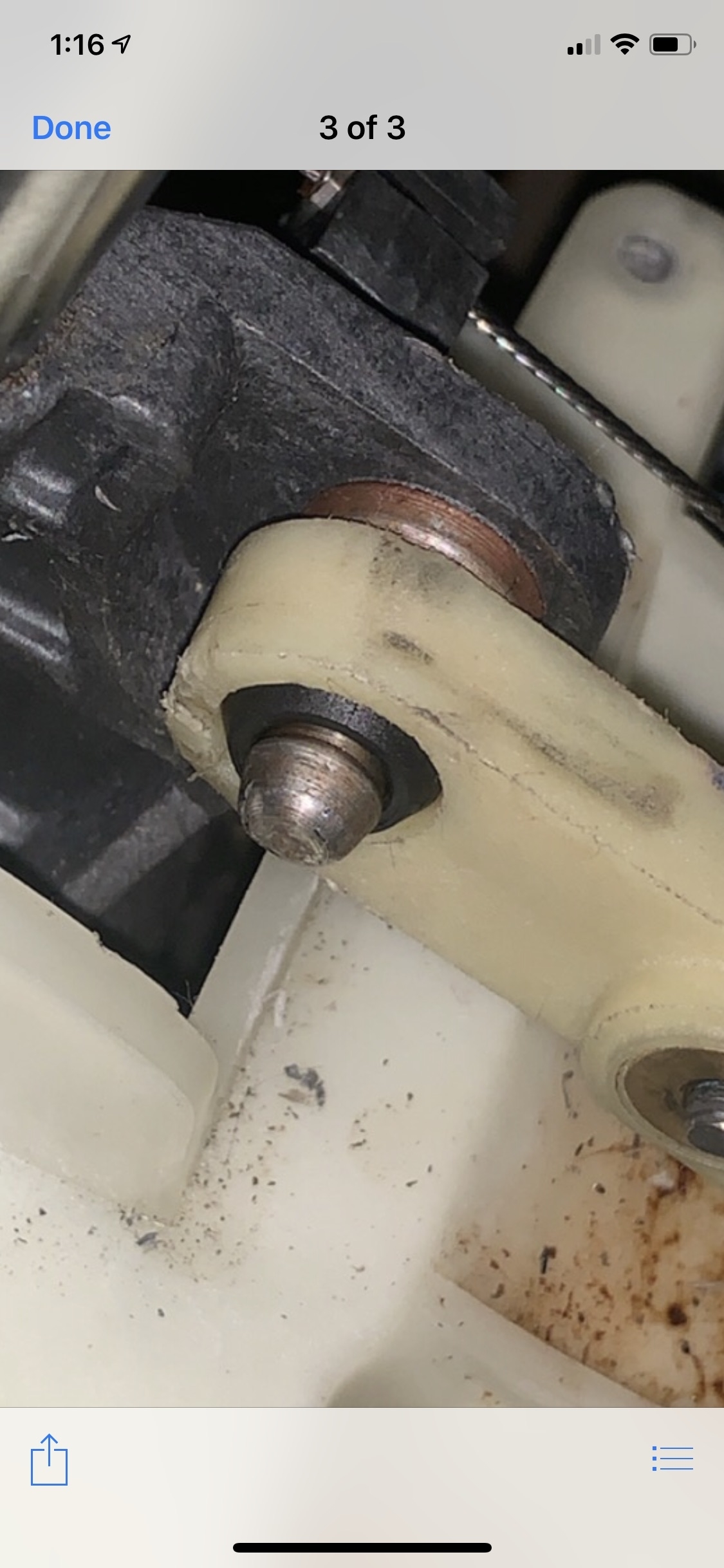

On the shifter cable connector inside the vehicle at the shifter is there supposed to be a small C clamp where the connector rod goes into shifter cable connector by the rubber bushing? Mine either fell off or did not have one. Trying to put back together. Thanks

I believe the rubber bushing holds it in place. However, this part is more than likely used in past products or other products and they use a c clip to hold it in place, which is why that notch is there. If you want to put one in, you are not hurting anything so if it were me, I would just put one on and cover all my bases. However, the service information just says to remove the cable and does not mention a c clip so I suspect it does not call for one.
Let me know if you have more questions. Thanks

Good afternoon,
Yes, there should be a C clip that will hold that shaft in place.
If you cannot find it, remove the shaft and go to a parts house and get a clip that will fit.

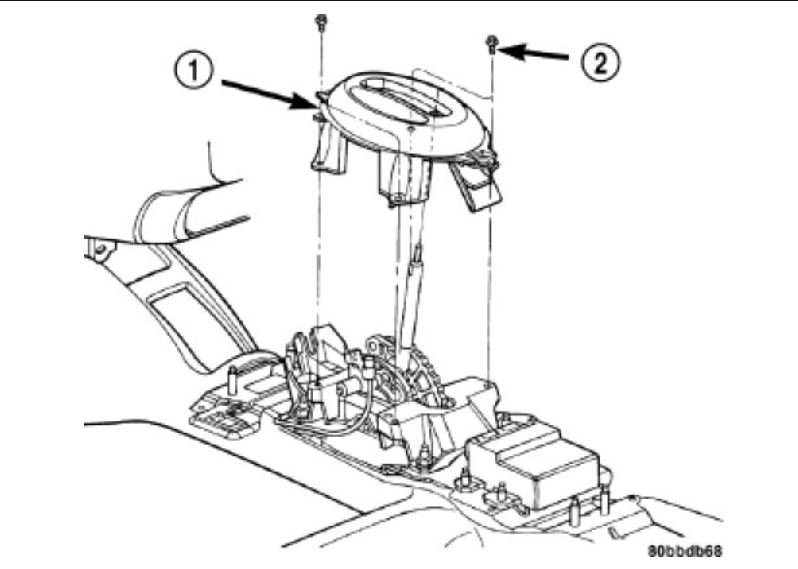

REMOVAL
1. Loosen set screw (2) and remove knob (1) from shifter handle.
ImageOpen In New TabZoom/Print

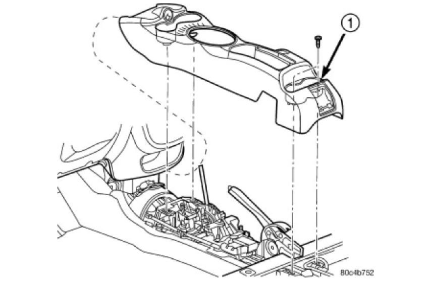

2. Remove the center console assembly (1).

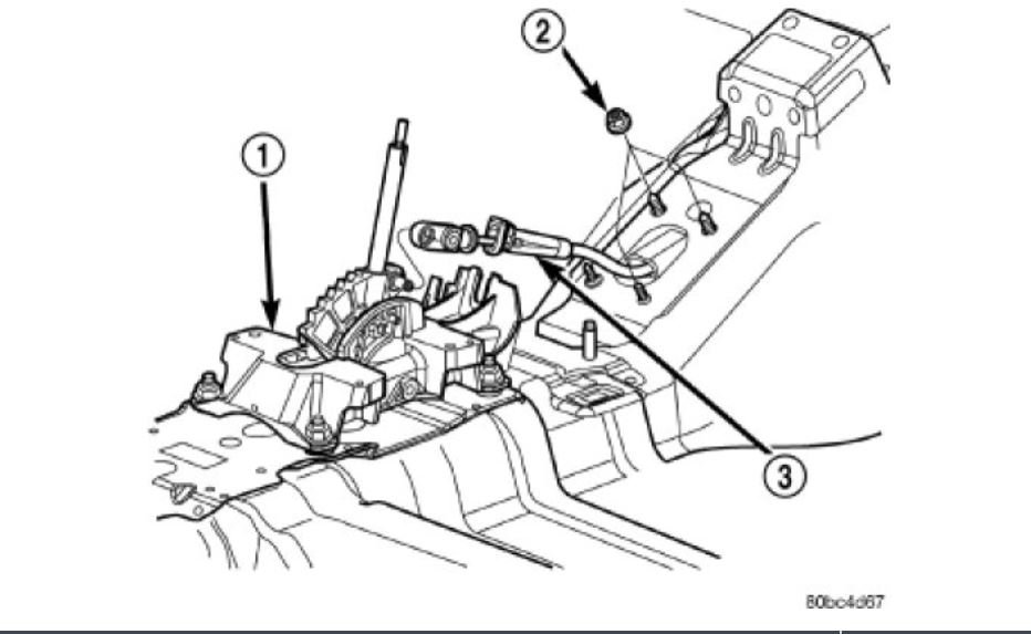

4. Disconnect shift cable (3) from shifter mechanism (1).

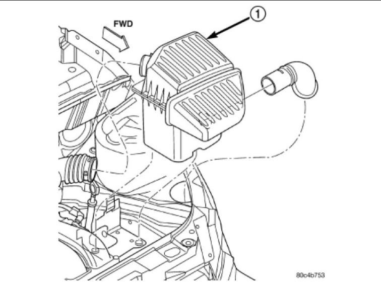

6. Remove air cleaner assembly (1).

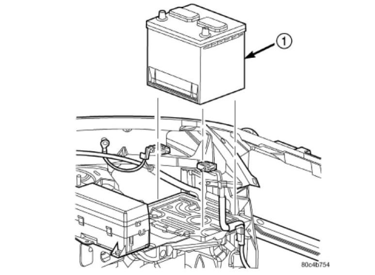

7. Disconnect both battery cables, remove battery hold down clamp and bolt, and remove battery (1).

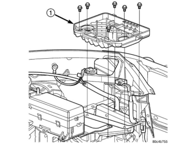

8. Remove battery tray (1) from bracket.

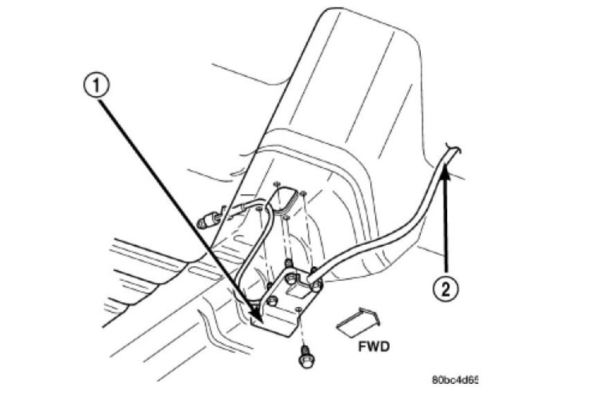

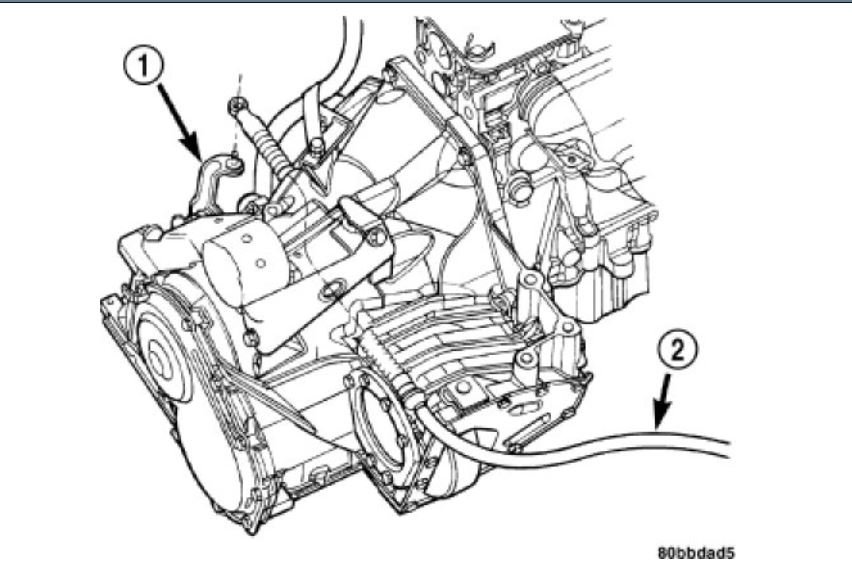

9. Disconnect shifter cable (2) from shift lever (1) and remove from bracket.
10. Raise vehicle on hoist.

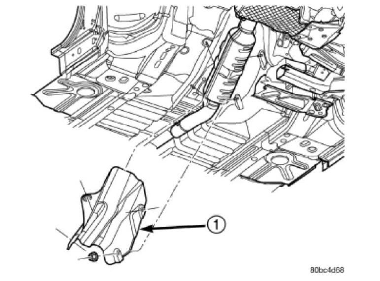

11. Remove catalytic converter heat shield (1).
12. Remove remaining grommet plate (1) screw and remove cable assembly (2) from vehicle.

Roy, there is no way to just lubricate the transmission arm where the cable attached on the transmission side? It just seems like the arm is slightly rusted. Its hard to move. I checked to see if the cable is binding and it appears not to be as far as can tell. I am a novice so I am not sure how a shifter cable goes bad. Forgive me. It just feels like the arms on the transmission is super stiff.
Thursday, August 22nd, 2019 AT 1:40 PM
  • 52,797 POSTS
No there is not. The rust has invaded the cable inside the casing. It is a long cable and you can not get any lubricant into the inner cable.
You need to replace the cable to get it working smoothly.
