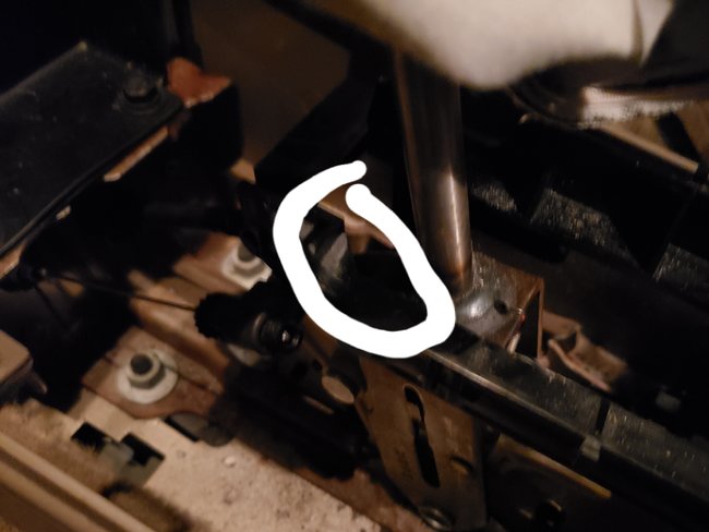

By chance, do you see the part in the attached pic? If not, could you take a pic of it and upload it for me to see? It shouldn't be bending, whatever it is.
See pic below.

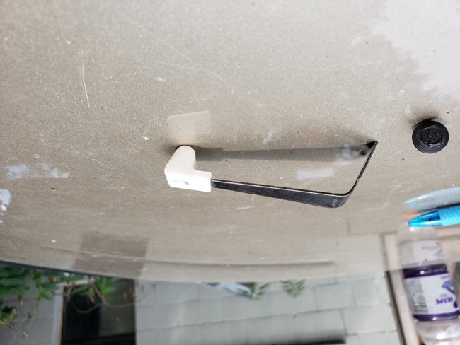

This is the piece. The picture is upside-down. Flat pc screws in right in front of the shifter rod. Then it bends down and is by the teeth. If it's screwed in can't go to park. Take it out, no problem.
Jun 28, 2022 at 6:12 PM
  • 110,248 POSTS
Looking at the pics, that appears to be what holds the shifter in a specific location. If it's installed, the shift lock is stopping it from going to park. If that is the case, the shift lock is preventing the key from coming out.

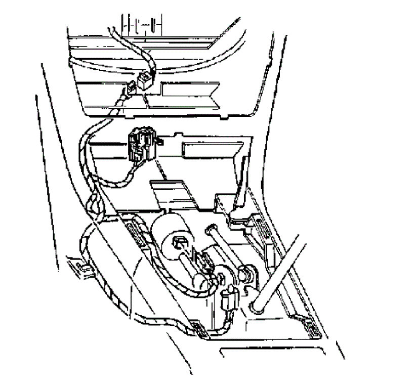

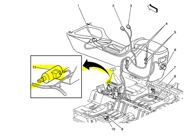

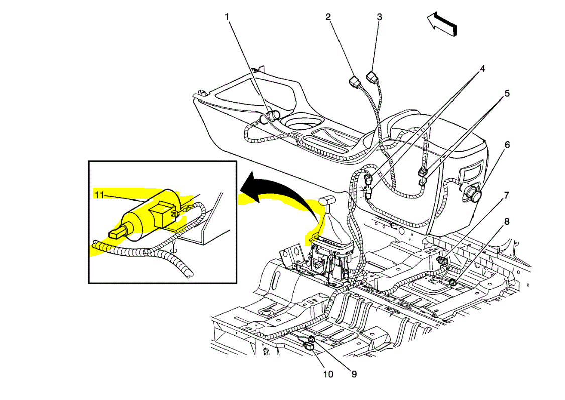

Try this and let me know what happens. With the key on, press and release the brake pedal a few times and see if you hear the shift interlock actuator clicking.
Let me know. Also, let me know if the key stuck in ACC is still happening.
See pic below for actuator location.
