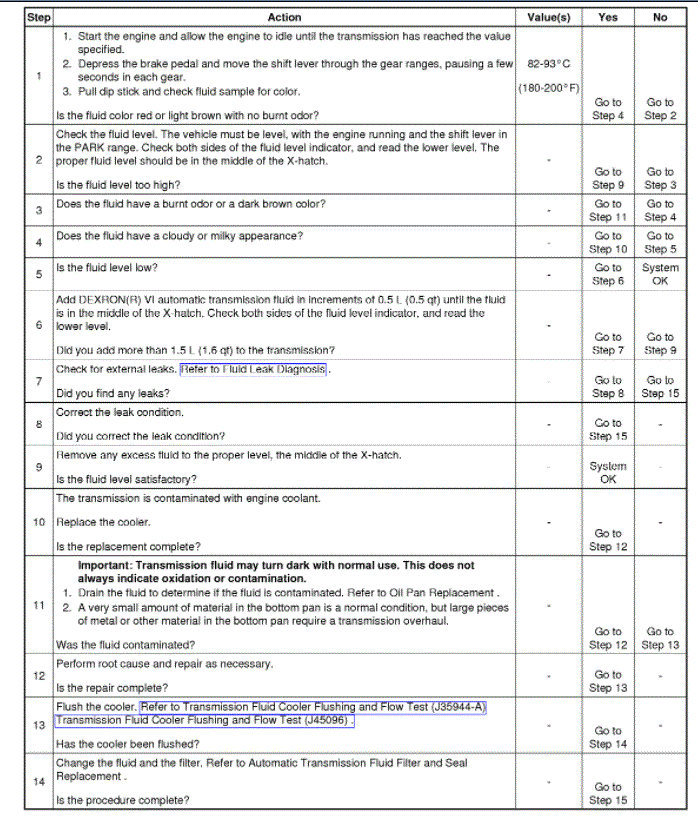

Have you checked the transmission fluid level and condition? If not, do this first. See pics below for directions.
Next, if the fluid is in good condition, then we should scan the can-bus to see if there are diagnostic transmission codes. CAN stands for controller area network. Basically, all the modules/computers are tied together via a few wires. This type of scan will identify codes regardless of the module/computer storing them. Here is a quick video showing how it's done.

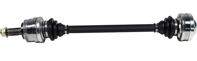

Have you checked to make sure one of the CV joints has broken? Try this. Have a helper place the transmission in reverse while you watch the axles under the front of the vehicle. Make sure the parking brake is on and the helper has his foot firmly on the brakes.
There are two axles. See pic 1 below to see what they look like. If one of the joints breaks on either of the axles, the car won't move.
Also, if you are uncomfortable performing the aforementioned test, place the vehicle in park with the parking brake off. See if the vehicle can be moved as though it was in neutral.

That’s not it either.

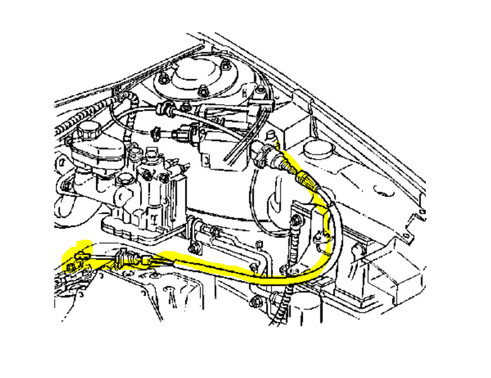

You are very welcome. I wait to see the video. Also, let me know if the gear indicator is accurate. For example, if you have it in drive, does it show drive? Also, follow the shift cable from the firewall down to the transmission. Have a helper shift through the gears while you watch to make sure the shift lever is moving. See pic 1
See pic below.
Oct 30, 2021 at 2:40 PM

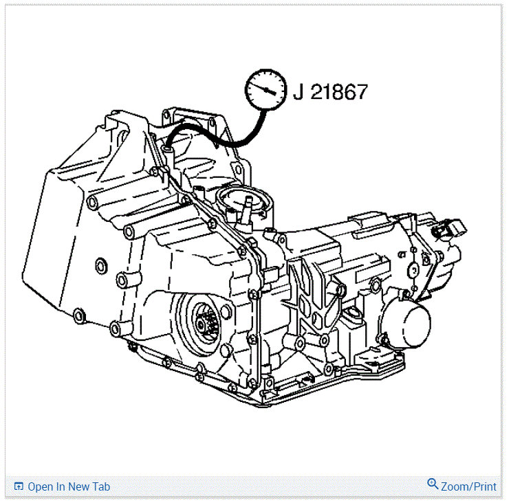

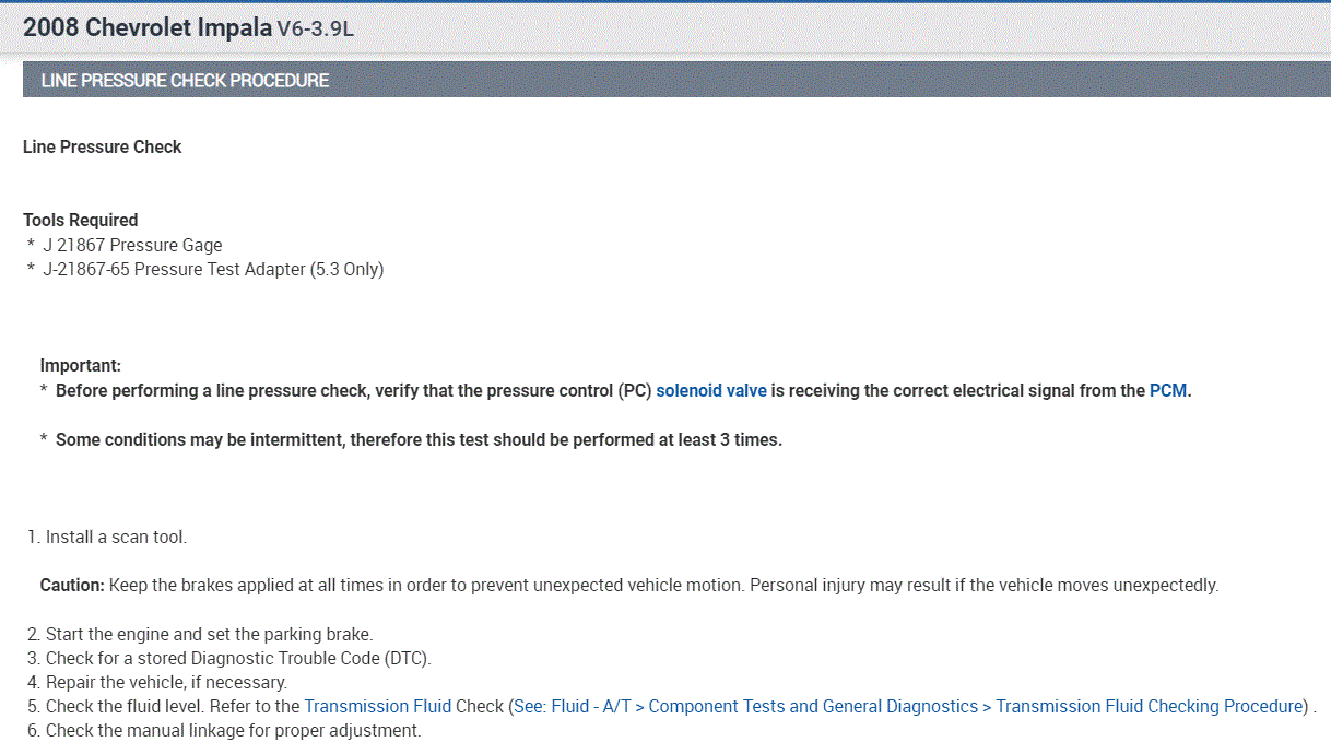

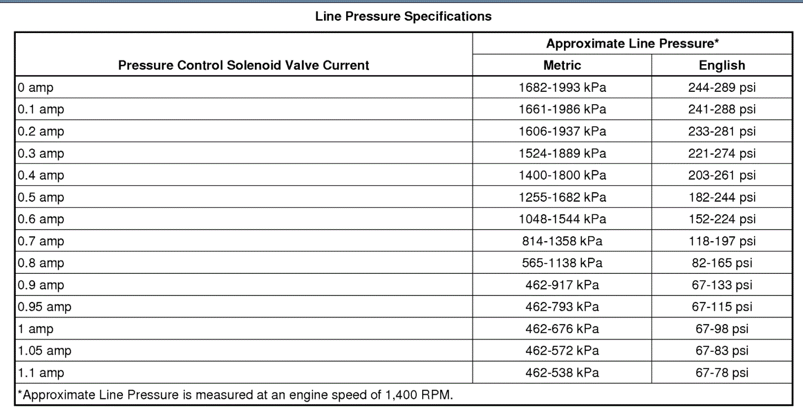

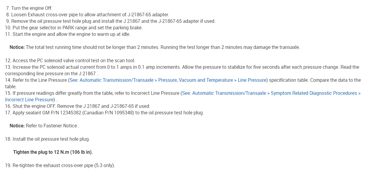

Thanks for the video. I can see the range sensor is working. That's a good thing. LOL As far as the issue, I noticed the engine light is on. At this point, we really need to scan the can-bus as I mentioned above. That will let us know if there is an electronic issue with the circuit. Other than that, line pressure will need to be checked to see if it is low.
I know it feels like I'm walking you from one thing to another, but without scanning for codes, it is a guessing game. Also, I know you may not be able to scan the can-bus. If that is the case, then we need to see if the transmission line pressure is within spec. Since nothing happens when shifting and this happened suddenly, there is a good chance there is a problem with the pressure solenoid in the transmission. So, we have two ways to identify if pressure is an issue, scan, or pressure test, which includes the use of a scan tool.
I attached the directions below for the pressure test. Also, I read through a few technical bulletins regarding line pressure issues related to a plugged cooler. That's one of the reasons asked about the fluid condition. However, based on what you said, it sounds like that isn't an issue.
Regardless, let me know what I can do to help. I wish I could just say replace a part, but it's never that easy.

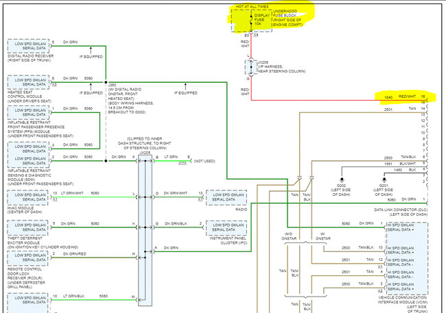

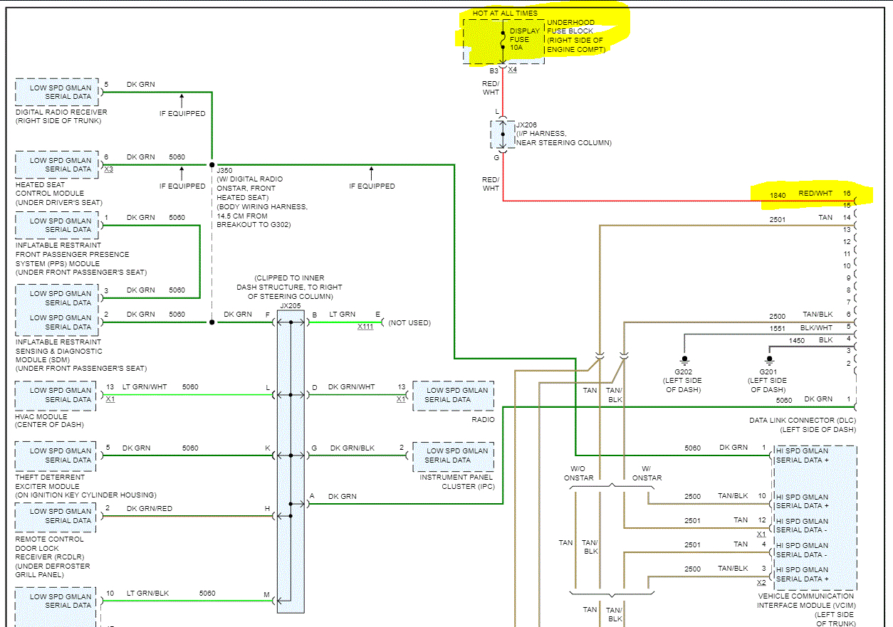

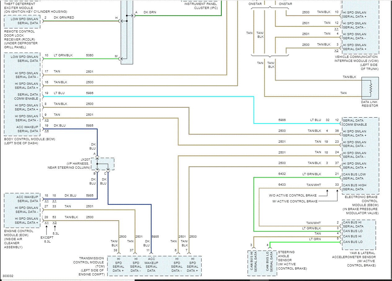

I do have a obd 2 scanner but it is coming up with an error not sure on how to use it any steps to take? And thanks a lot really!!
Nov 2, 2021 at 12:25 PM
  • 110,244 POSTS
Does the scan tool power on?

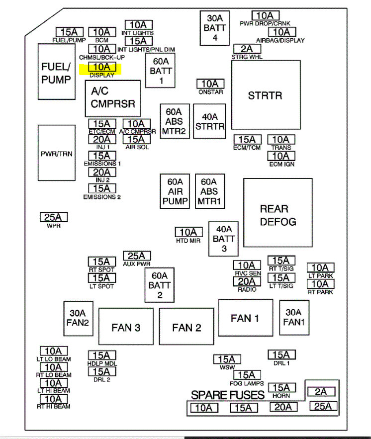

Do me a favor. If you look at the attached pic, I highlighted pin 16. That pin should have 12v at all times with the key on or off. Check that for power.
With the key on engine off, check the following pins for power. They both should show 0v. Anything above a 0.25v indicates a short.
Keep in mind, you can also check pins 4 and 5 for continuity to ground. Whichever is easier for you. However, the voltmeter/DMM will tell us if there is a short.

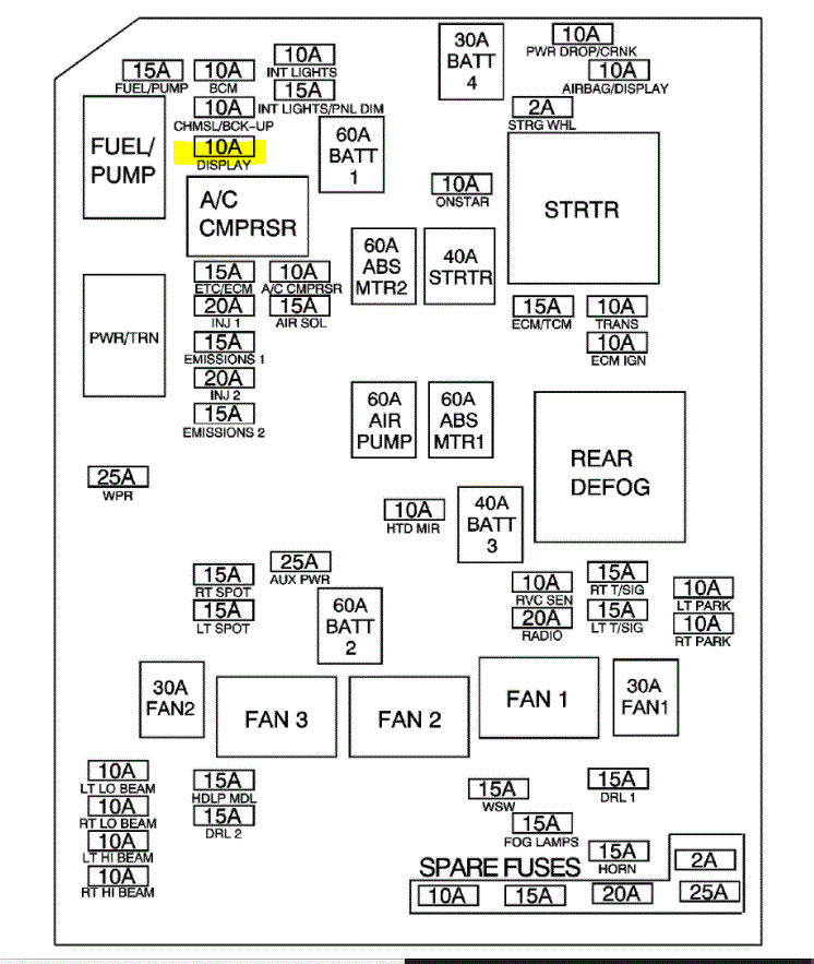

Also, I attached a wiring schematic below showing the power supply to pin 16. It is powered by the display fuse in the under-hood fuse box. So, if there is no power to the pin, check that fuse. In addition to checking the fuse, confirm there is power to and from it.
Here is a link you may find helpful with checking it:
Let me know what I can do to help.
See pics below. Note: Pics 2 and 3 are from one page. I had to cut it in half to make it readable for you. I did overlap it so you can follow from one to the next. Pic 3 shows the fuse location in the fuse box.
