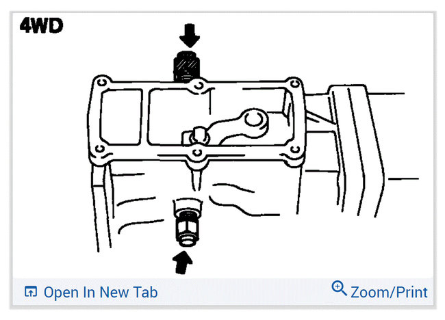

Installed new clutch package, master and slave cylinders, went to install shifter and have 1-4 and fifth is a fight but do not have reverse or neutral. I am assuming I didn't start with in neutral but I don't know the configuration of the linkage. Someone explain the proper positions of the linkage and which spot to stab to correct the problem. The transmission is a W56 only one bushing for transfer case. What position should the transfer case be in 2H or 4H?

Joe, you're right if that was the the case but, it is a manual 5 speed 22re. The 22r is 2wd and it is a W56 with no external adjustments. If the clutch was not installed right could that cause a problem cause this should be straight forward, so easy even a cave man can do it.

If the clutch is working other than neutral and reverse, something isn't together right with the linkage. The clutch wouldn't prevent you from getting neutral. I have the info on the W56 for rebuilding, but nothing showing linkage.
You seem to know what you're talking about, so I have to assume you rechecked the linkage. Could the restrictor pin be causing the issue? See pic 1.
