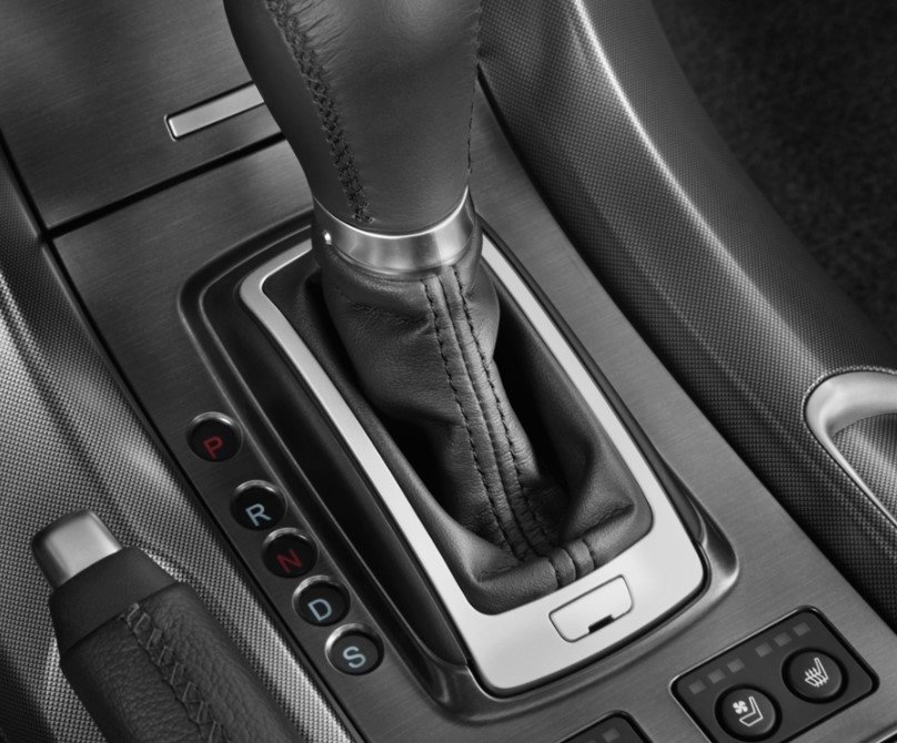

I am wondering if at night when you have your lights on, what the shifter should look like and how it should be lit up. Most cars light up which gear you are in but mine doesn't, the P and N are always red.

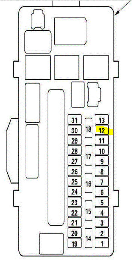

However, before we jump to conclusions, is the vehicle shifting normally? Are the correct gears indicated when the lights are off? One last thing. I need you to check a fuse that could be causing issues as well.

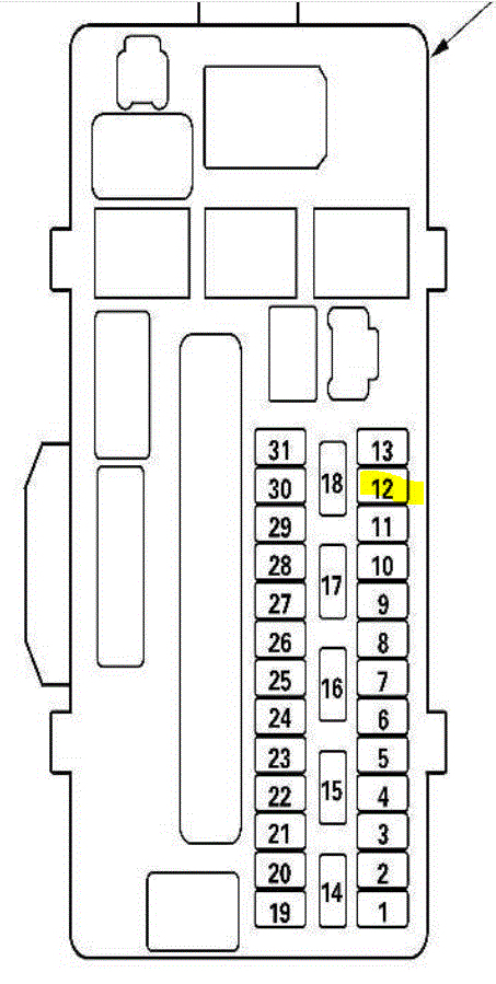

The fuse is number 12 in the fuse box under the dash on the left side. See pic below. Also, when you check it, first make sure the fuse is good. If it is good, then it's important to check for power to and from the fuse. Note: the key will need to be in the on position. The engine doesn't need to be running. Here is a link you may find helpful:
If you look at the pic below, I highlighted the fuse to check to help locate it.
See pic below.

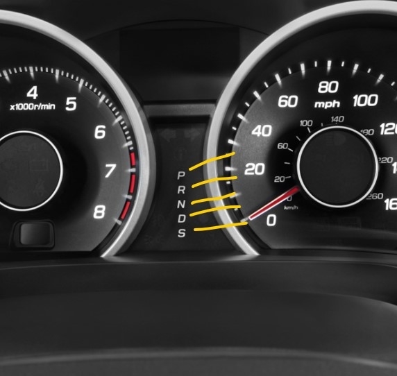

Which indicators are you talking about? The one on the console only lights up with the P&N positions in red and the others in white or blue depending on the options. You can visually tell by the position of the stick next to the gear. They are lit from below with the red made into the plastic windows for park and neutral gears. The actual gear you are in should show in the middle between the gauges as in the second image.

The last car I had the color in the 1st pic would change depending on what gear it's in. I thought maybe this car was the same.
Dec 27, 2021 at 5:24 AM
STEVE W.
  • 15,344 POSTS
Okay. No, they just light up in that car. The indicator in the dash does the rest.
