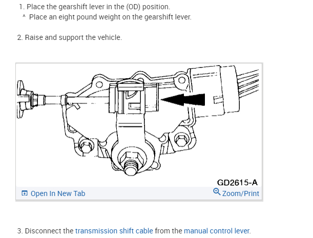

Unable to put in park.

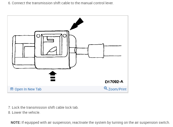

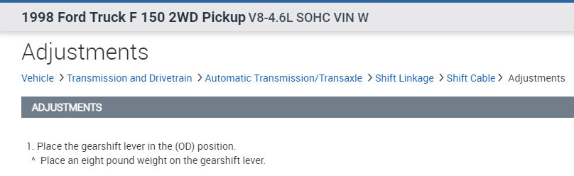

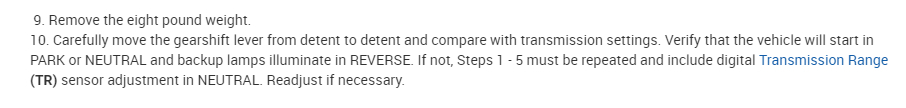

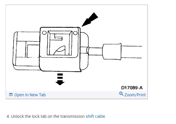

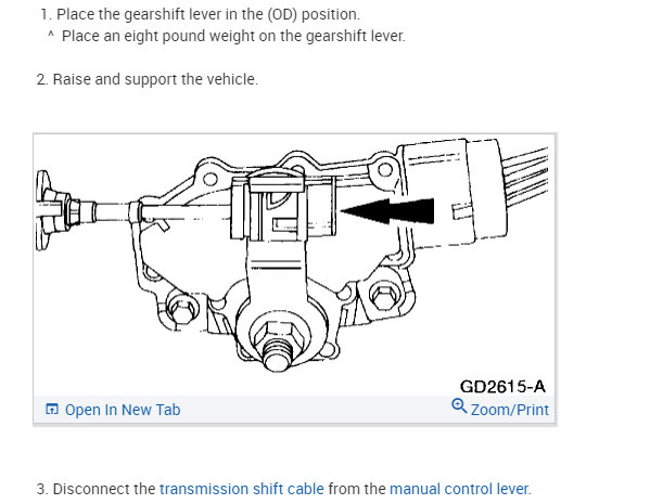

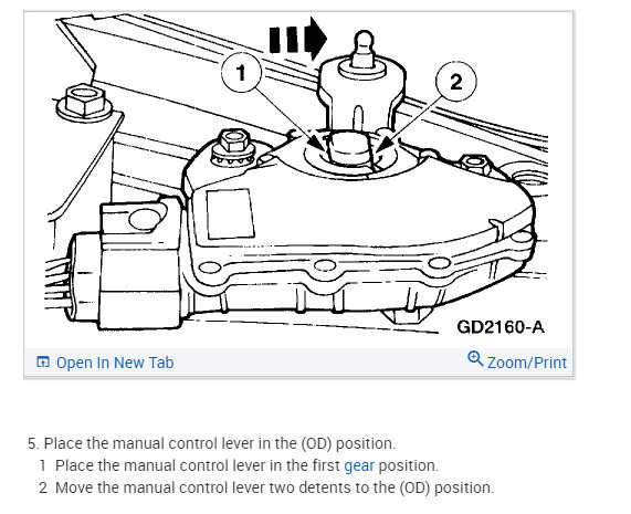

The truck has a shift cable that is adjustable. I'm not sure if you have already checked it, but you may want to see if it is an adjustment issue.
If you look below, I attached the directions for adjusting the cable. Take a look through them and let me know if you are comfortable performing the procedure or if you have already done it.
