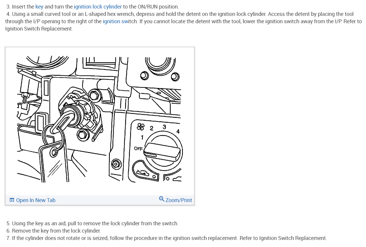

Can't get car in park key is stuck in acc position.

This may require a new tumbler. Before jumping to that conclusion, take a look through this link and let me know if it helps.
https://www.2carpros.com/articles/ignition-switch-wont-turn-stuck
Also, let me know if you noticed anything prior to this happening that may indicate a possible other issue.

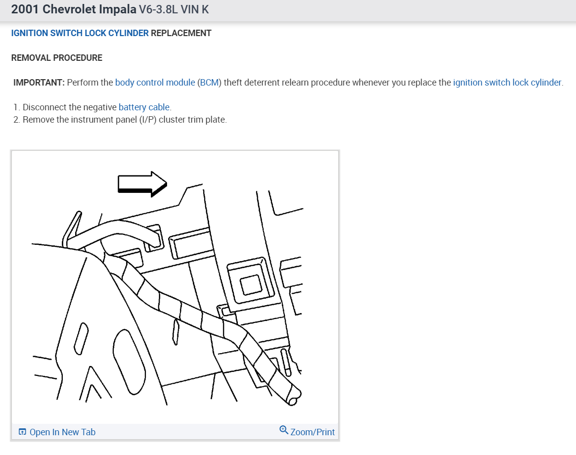

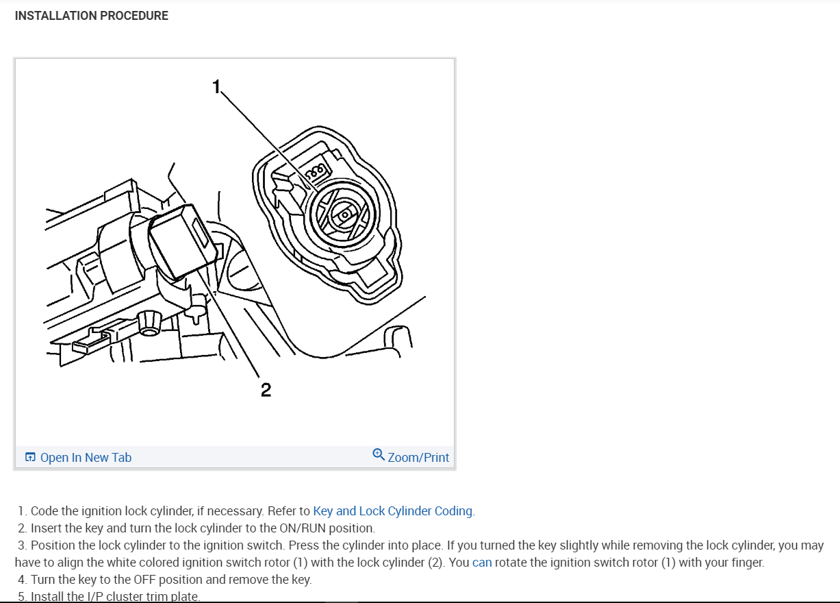

Here is how the tumbler is changed out. Check out the images (below). Let us know how it goes.
