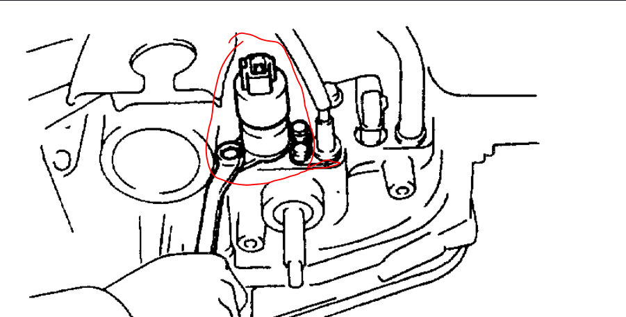

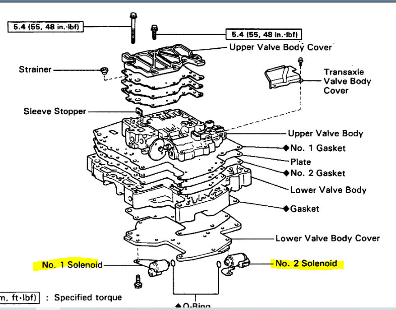

Shift solenoids, are the solenoids exposed when taking off the transmission oil pan?
1999 TOYOTA CAMRY
200,000 MILES • 2.2L • 4 CYL • 2WD • AUTOMATIC
GCAM22
From my understanding for my car listed above, the solenoids should be attached to the valve body. Are the solenoids exposed when taking off the transmission oil pan?
Aug 17, 2023 at 4:39 AM
  • 110,236 POSTS
The shift lock solenoid is on the exterior. See pic 1. Also, if you remove the pan, you should have access to both shift solenoids one and two. See pic 2
