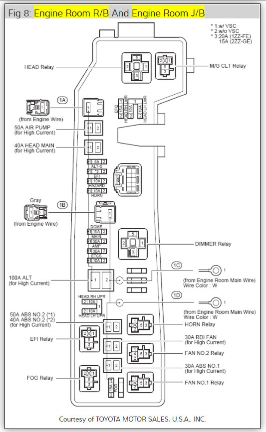

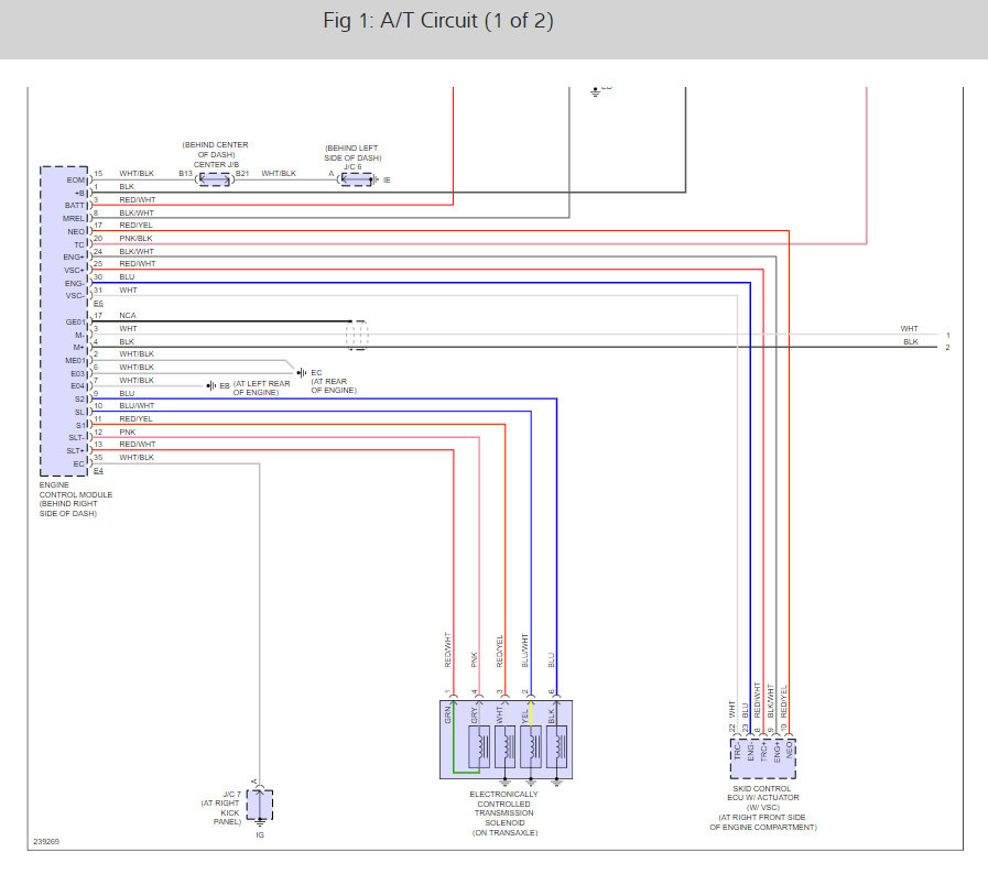

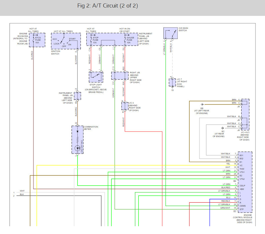

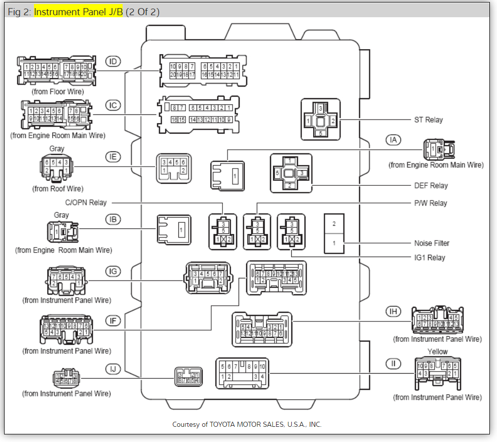

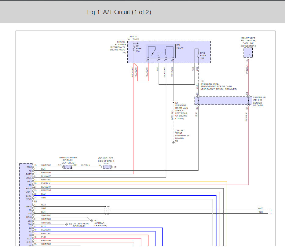

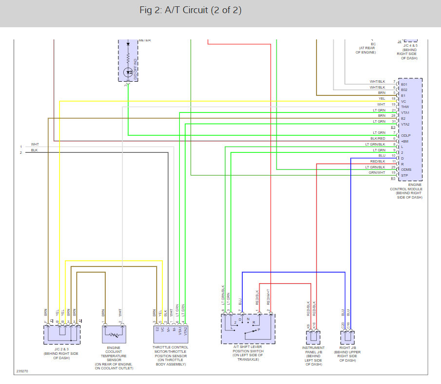

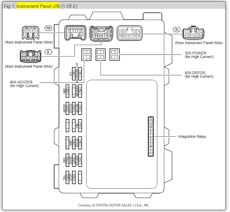

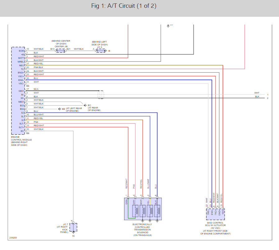

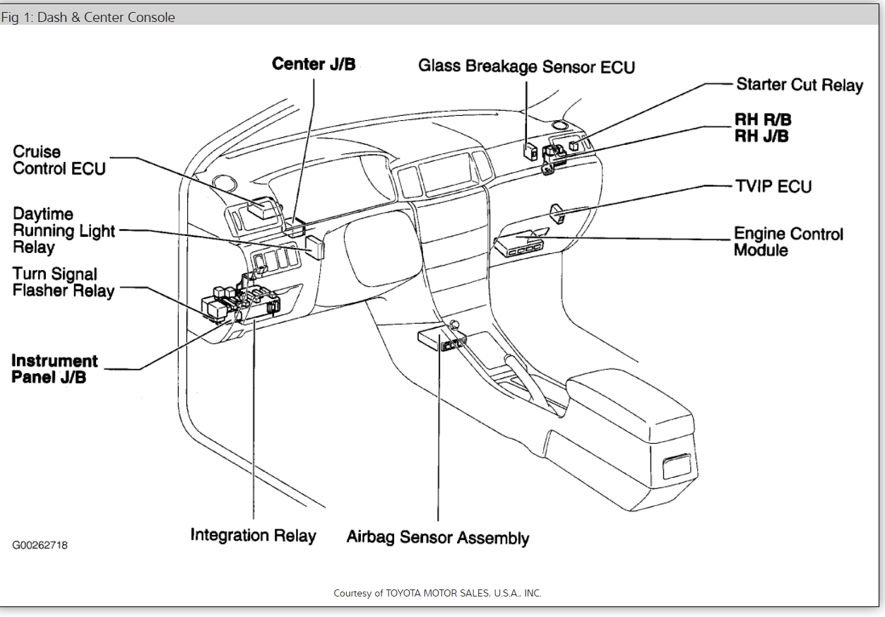

What fuses go to the shift solenoids in my car listed above CE model.
Oct 17, 2018 at 9:10 AM
  • 55,433 POSTS
No solenoid has its own fuse, but there are five fuses that run the transmissions system which you need to check. Here is a guide to help you and the fuse location along with the transmission wiring diagrams so you can see how the system works:
