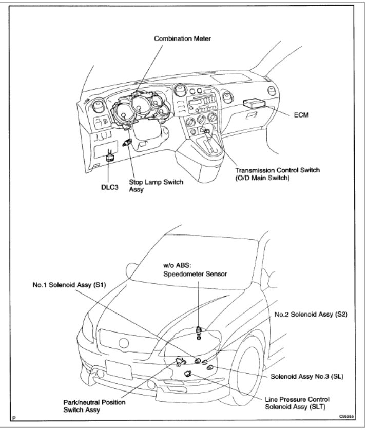

Hey my name is Jorge, I was looking for some help on finding the location of the shift solenoid e on the vehicle listed above four wheel drive or at least maybe seeing what solenoid number it is. It is making the car run super bad the whole engine and transmission is shaking. it was leaking oil from torque converter but I switch it out and no more leak, but I still need to find out where this solenoid is. Thank you.

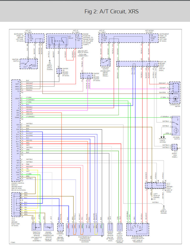

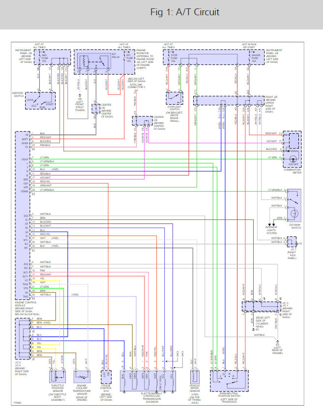

Not to sure about the "E" but here are the solenoid locations and the transmission wring diagrams so you can check out which solenoid you need to replace.
You will need to drop the pan this guide will show you how.
