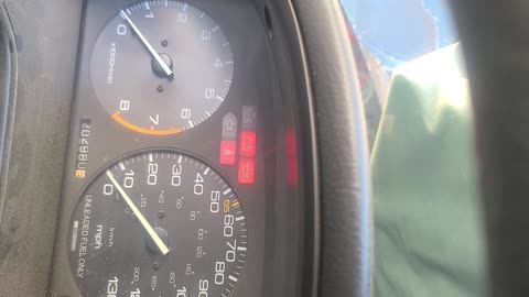

I have been getting that shift solenoid issue even after removing and replacing the part. The transmission shift when cold but when driving temperature, it loses power and shifts hard on the gear esp 3 and 4 so i was able to go to gear 1 to be able to move.

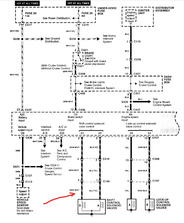

Circuit open means there is no connection from the shift solenoid and the automatic control unit, here is the wiring diagrams for it and a guide to help you with the testing.
Check out the images (below). Let us know how it goes

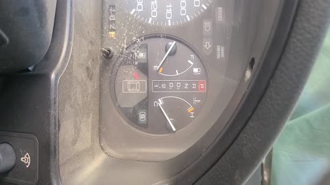

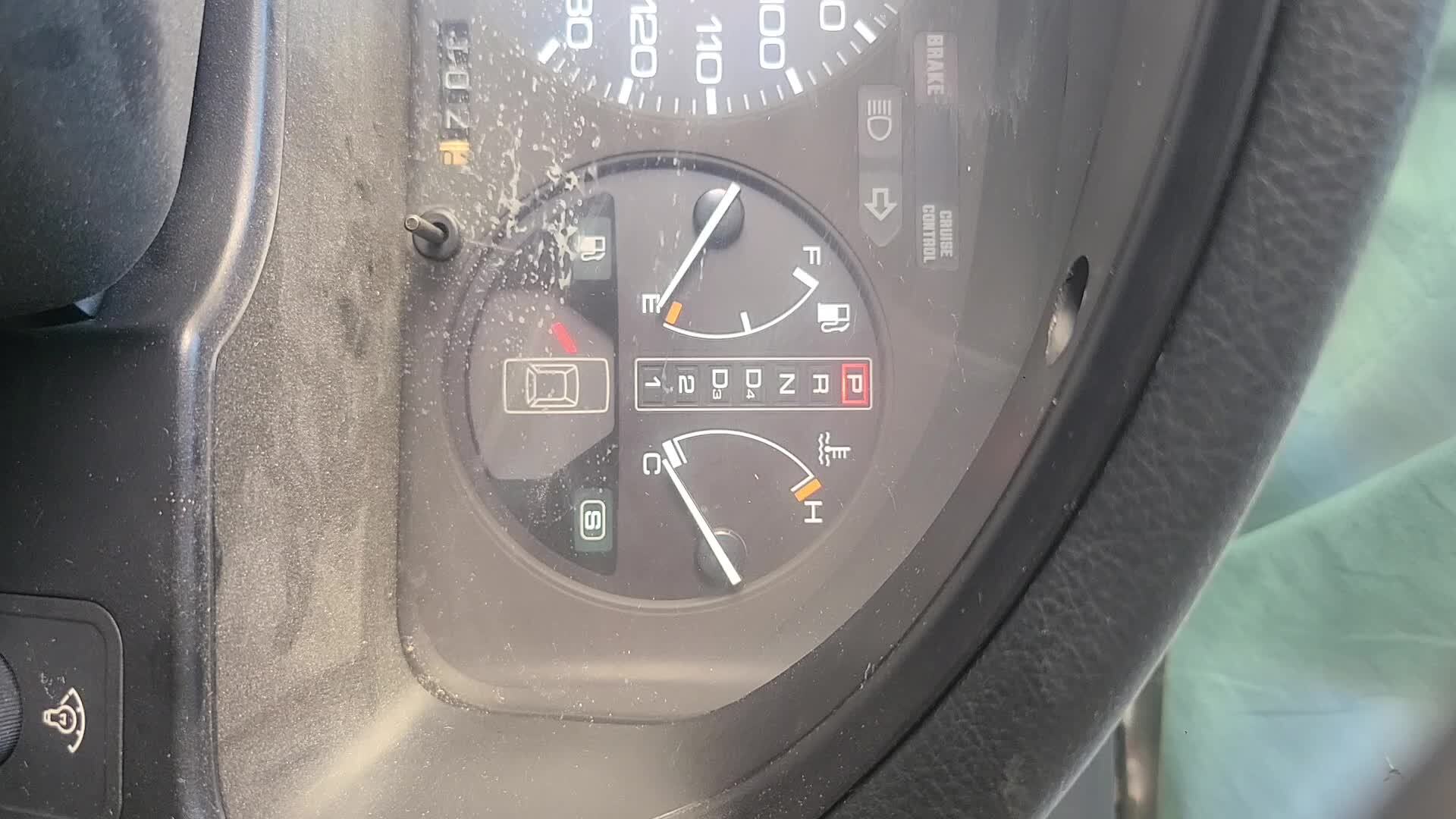

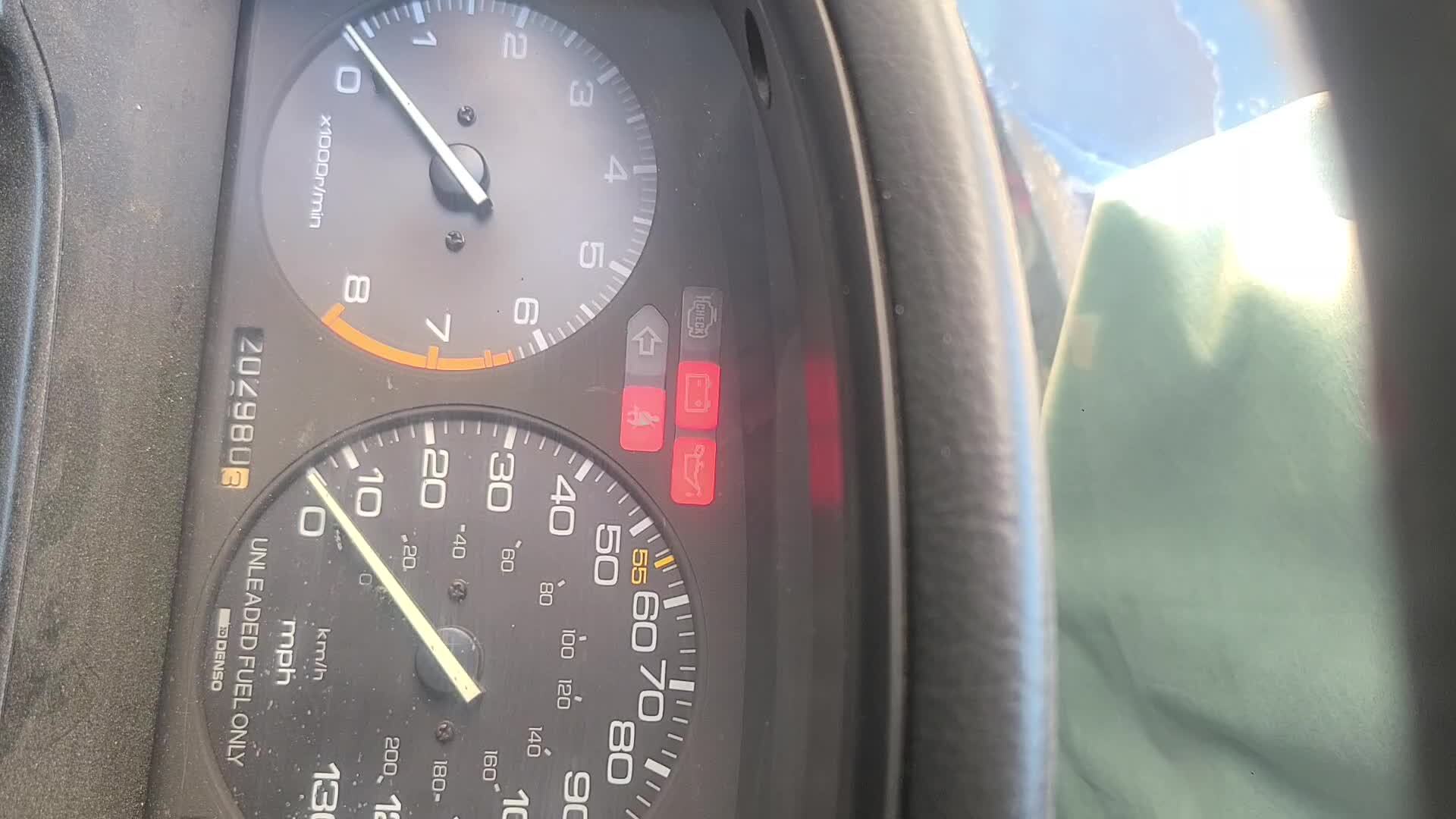

I have replaced the solenoid and the coolant sensor but i still have the egine lights and s lights 6 check engine and 8 on the s lights

So we need to check the wiring from the solenoid to the ECU, use the diagrams above and this guide to help check the wiring, grn/wht and blu/yel
Please go over this guide and get back to us.
