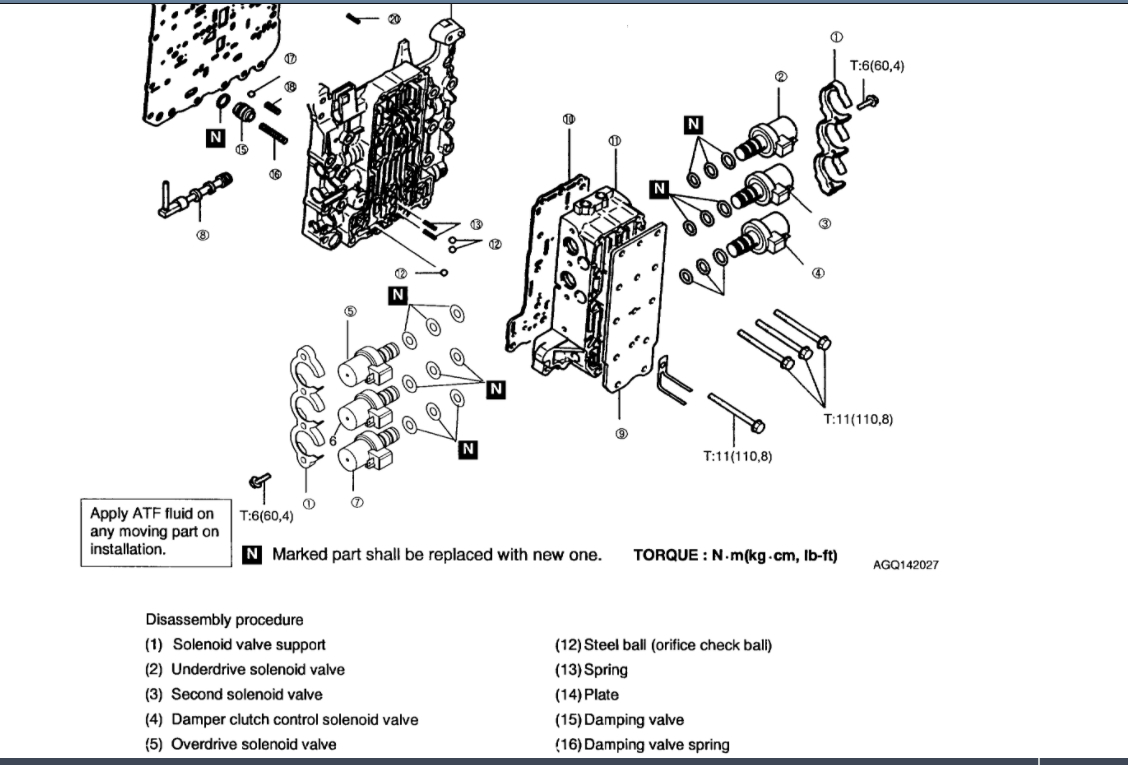

Which solenoid controls the D or drive?
The problem is that when I shift to reverse it shifts normal but shifting into drive it jerks or slams too loud, it is scary.
Dec 8, 2020 at 7:46 AM
Good afternoon,
There is no solenoid for engagement into drive at all. It is all handled by the valve body itself.
Have you changed the fluid? That is where I would start.
There are 6 solenoids on the valve body for all the shifting.
I attached pictures for you of the solenoids.
