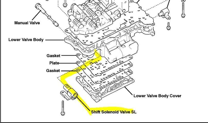

I got code p0770 they say shift solenoid e where is the location of shift solenoid e? When shifting is very rough.

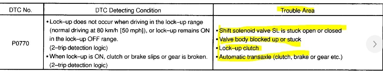

The solenoid E is the SL solenoid and is located on the valve body. There can be other issues causing this code. See picture 1
Picture 2 shows the location on the valve body for solenoid SL.
Let me know if you have questions.
