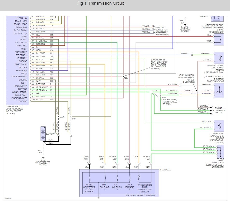

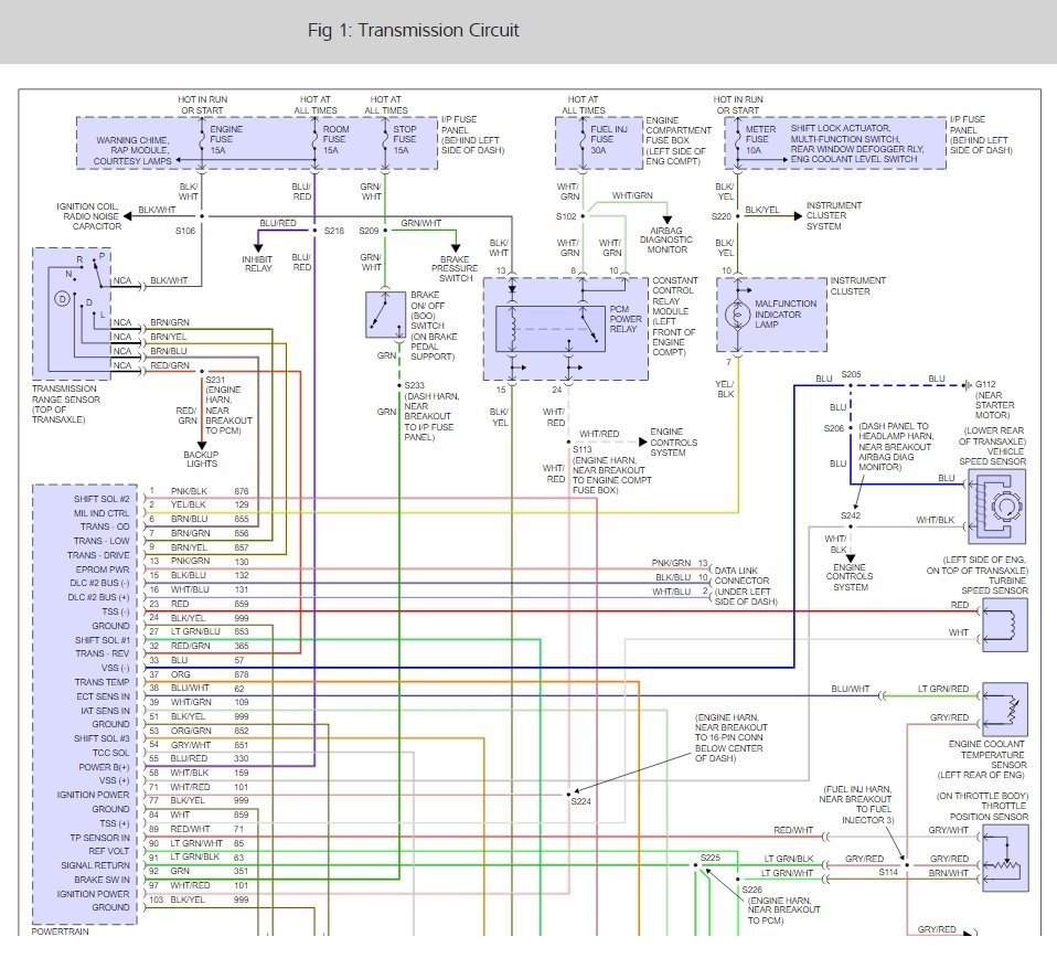

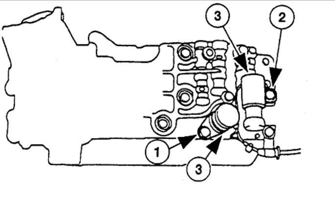

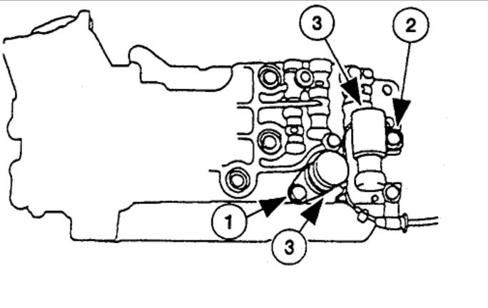

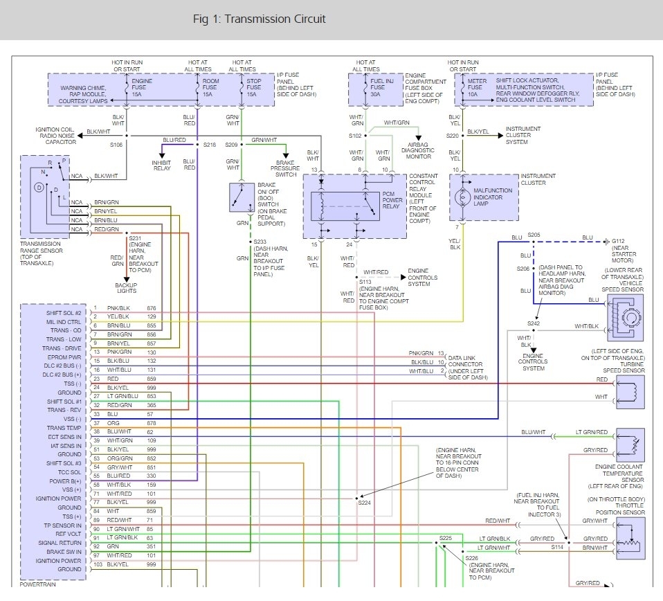

The shift solenoids are located in the transmission pan. If you don't have a pan then the transmission needs to come out and the side cover must be removed.
Here is a wiring diagram and a guide to show you where it is.
