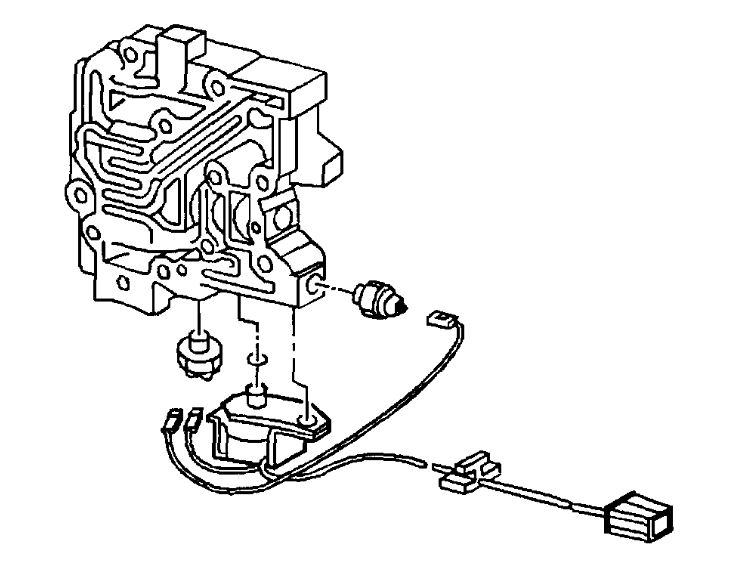

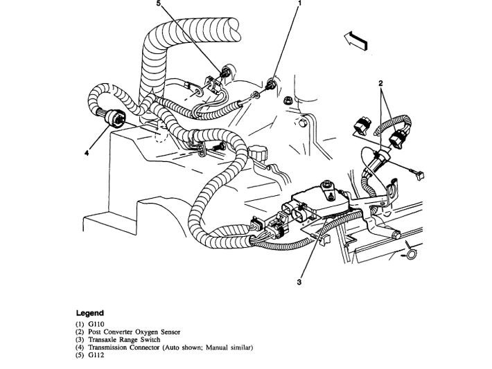

Good afternoon,

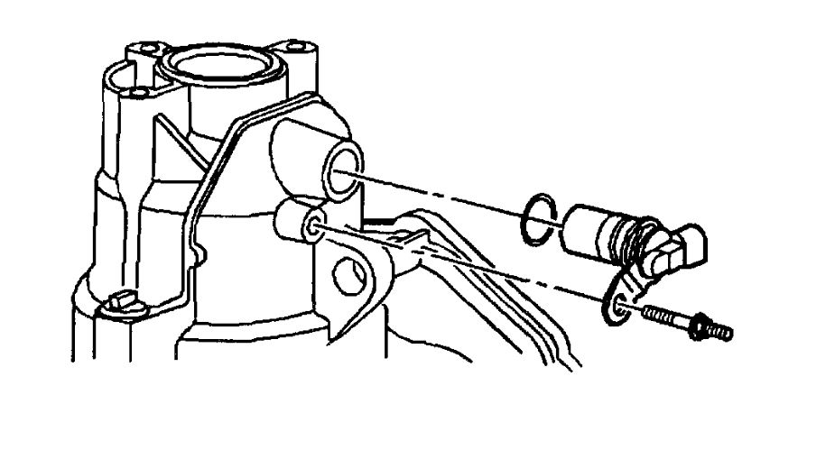

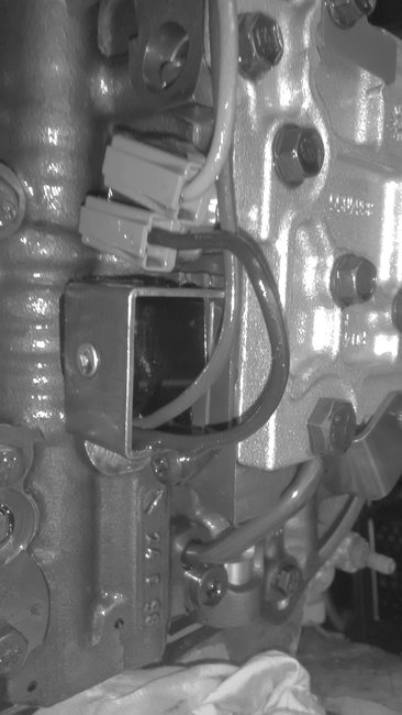

I am not sure what you mean here. I have posted a picture of the park/neutral switch and the transmission speed sensor.
Can you clarify which one you mean?

I need to know step by step how to get to that to remove that.

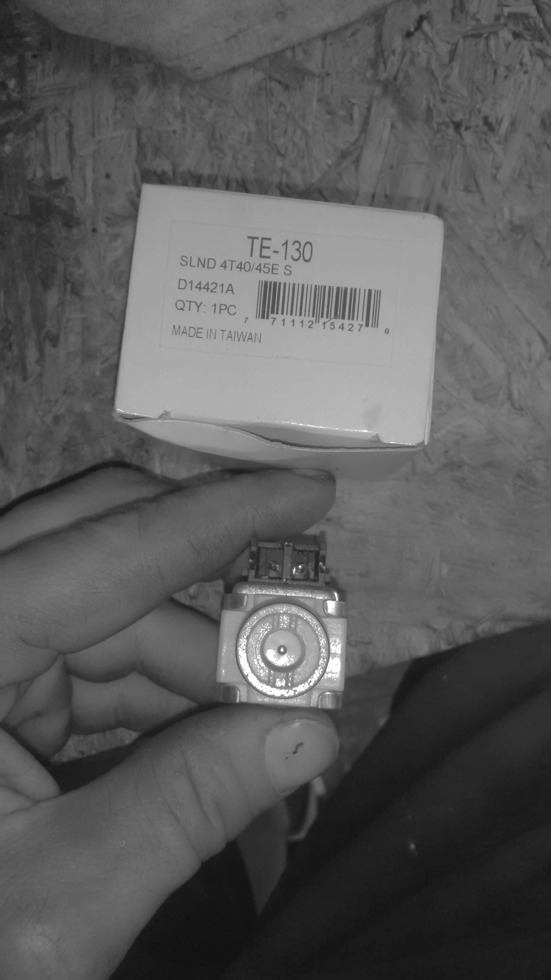

That is a shift solenoid.
Which one?
Do you have a code for the solenoid? If you do, can you give me the code?

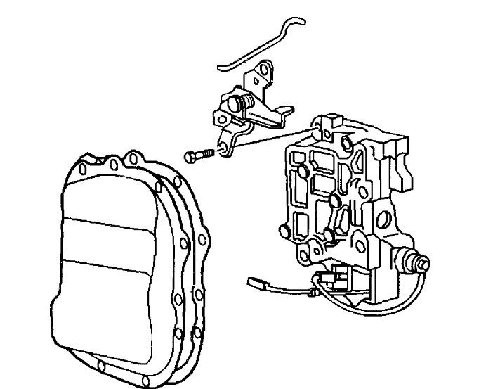

THOMAS1234418
  • 17 POSTS

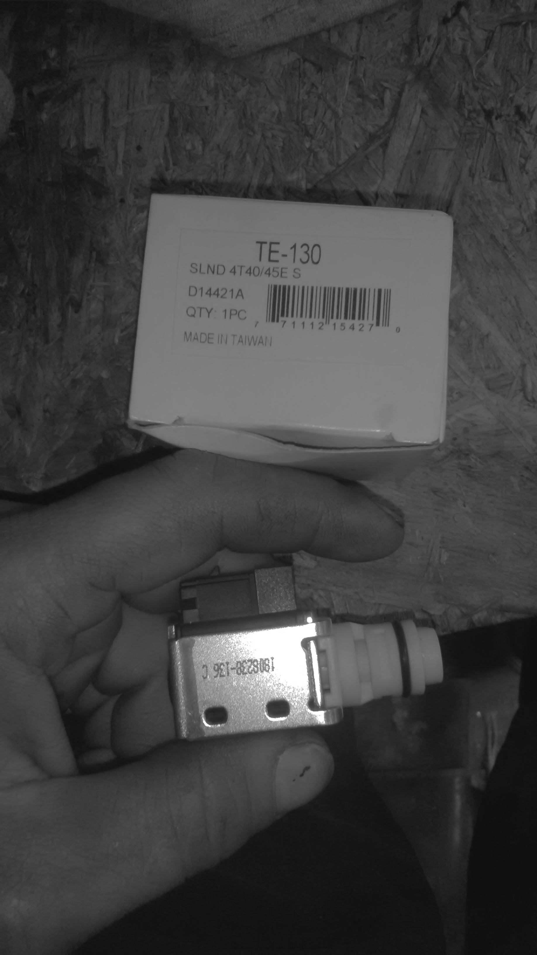

So is this picture the shift solenoid? If so it doesn't in plug the wires go straight to it.

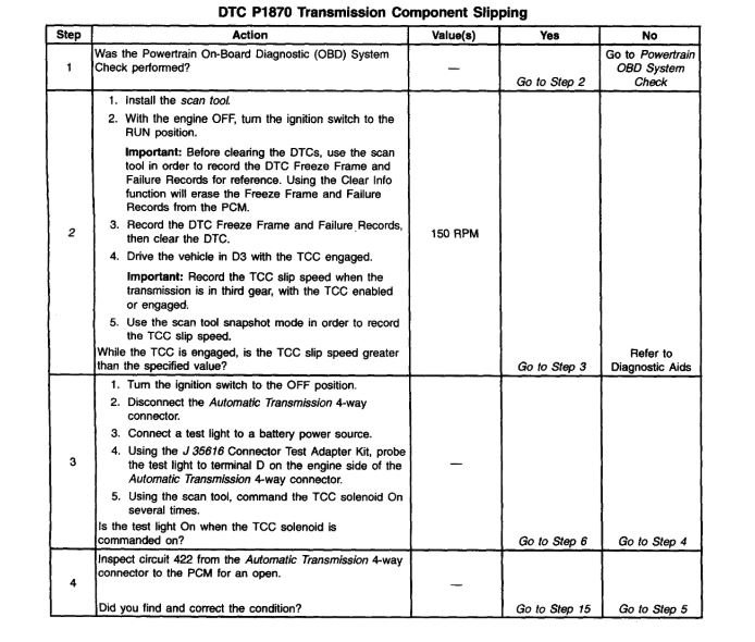

P1870 is the code. I think it's in limp mode. when it does work it shifts one time and goes right back to not shifting. Before you could manually shift it now it stuck in first.
Apr 5, 2020 at 7:30 AM

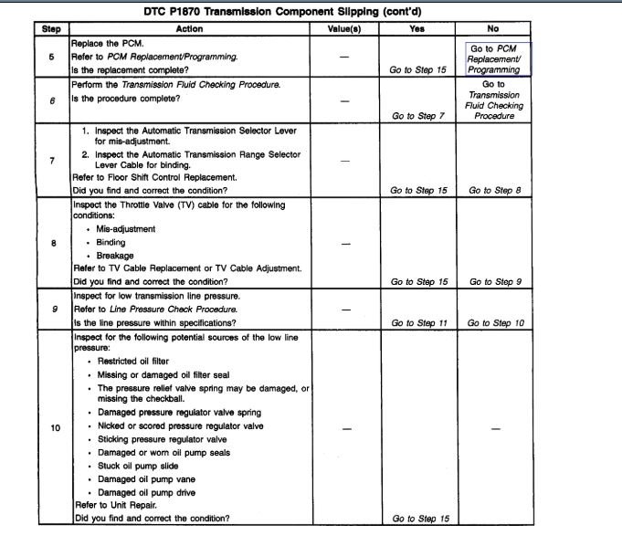

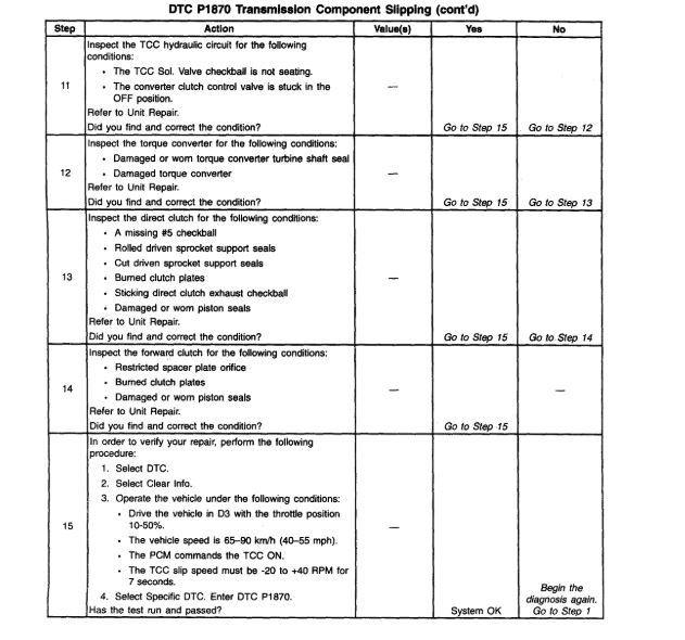

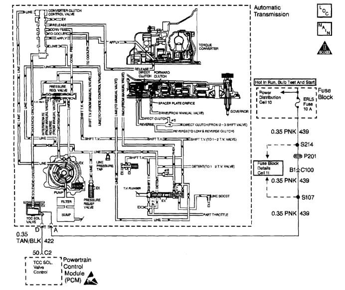

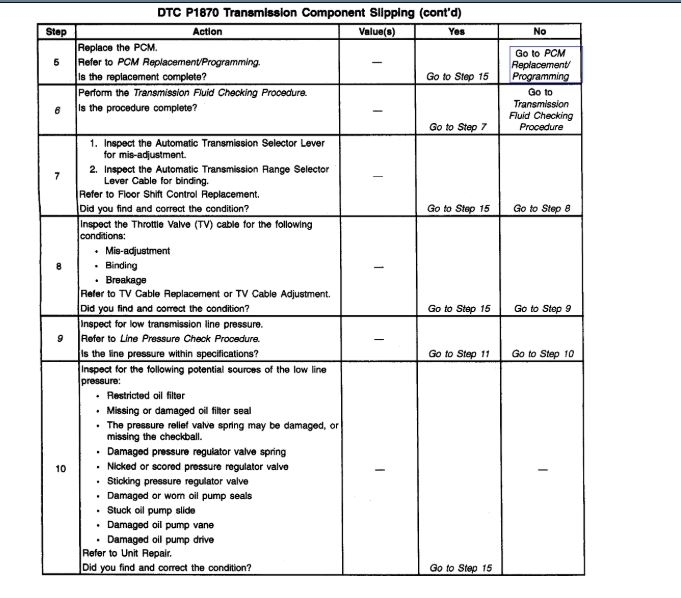

Okay, I attached a flow chart that you need to follow to determine the failure.
Codes rarely identify failed parts, just failed systems.
Let me know what you find.
CIRCUIT DESCRIPTION
The Powertrain Control Module (PCM) monitors the Torque Converter Clutch (TCC) slip speed. The PCM calculates the difference between the engine speed and the transmission output speed. In D3 drive range with the TCC engaged. the engine speed should closely match the transmission output speed. When the PCM detects excessive slip of the TCC, the forward clutch, and the direct clutch when the TCC is engaged in 3rd gear, then DTC P1870 sets. DTC P1870 is a type B DTC.

TEST DESCRIPTION
The numbers below refer to the step numbers on the diagnostic table.
2. This step tests for excessive torque converter slip while the TCC is engaged.
6. Low fluid level may be causing the slipping.
9. Low line pressure may be causing the slipping.

I doubt it is the solenoid as all the indicators in the flow chart point to a wiring issue. You will be doing a lot of work for nothing if you do not do the proper diagnostics.
You already have the cover off from the picture you sent me.

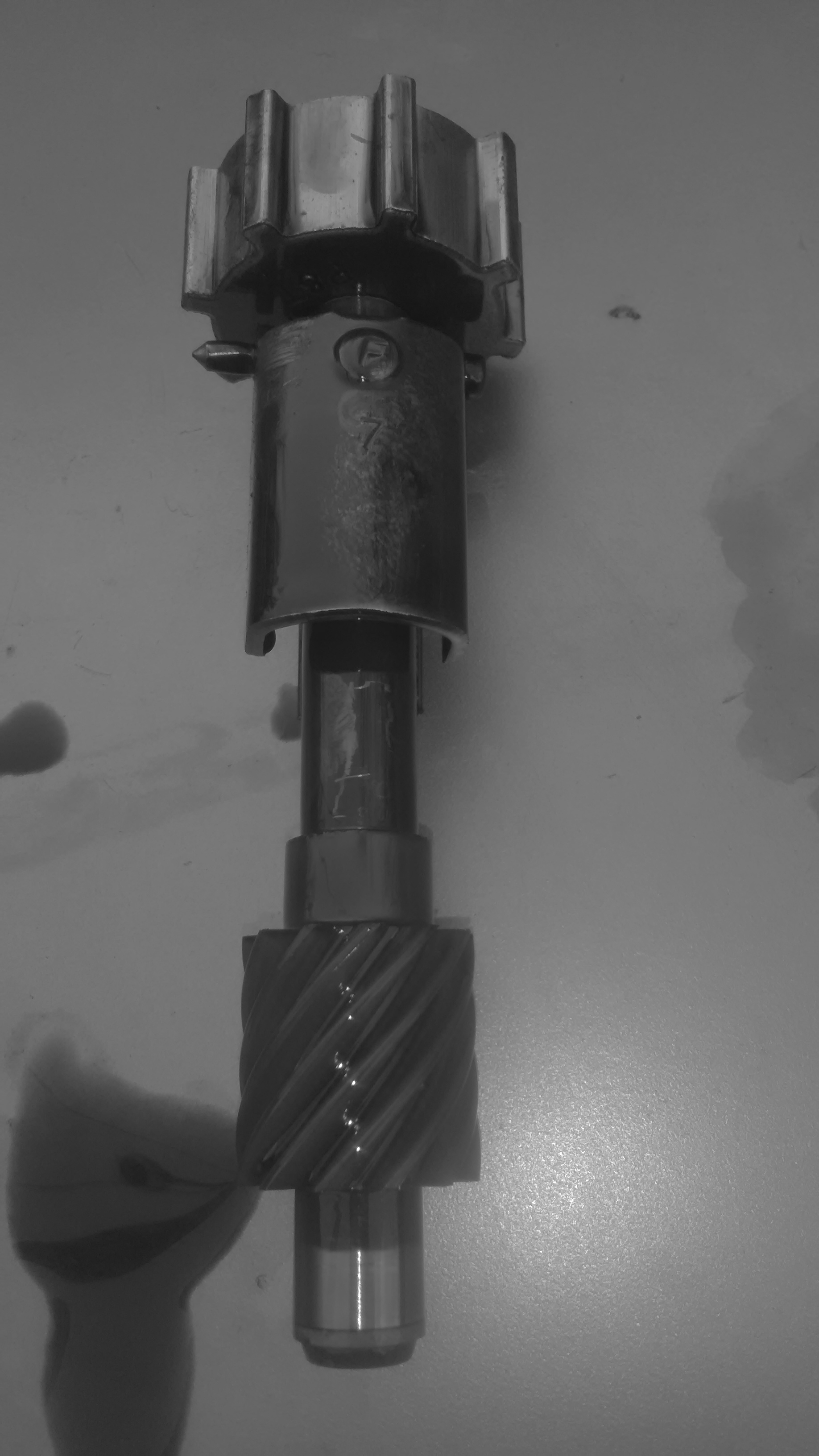

As I stated, it looks to be a wiring issue to the solenoid or control of the solenoid but not the solenoid itself.
That is why you need to follow the flow chart and not guess.

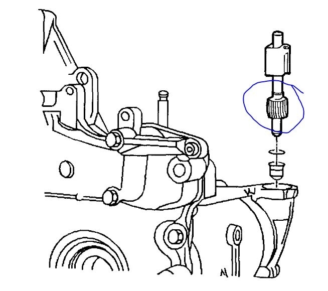

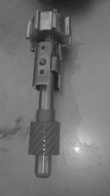

As far as the not shifting, that could be the governor. that is what controls the shifting.
I attached a picture of the governor. The gear I circled is a common failure for dishing out and not turning causing no throttle pressure which means no shifting.

Okay, that is this right i have got the transmission up on its side, but it's right by the passenger side axle got two 10 mm bolts holding it on and has a wire plug that plugs into it.
Apr 5, 2020 at 7:53 AM

Pull it up and see if that gear is stripped out.

It looks fine i am going to check the wires.

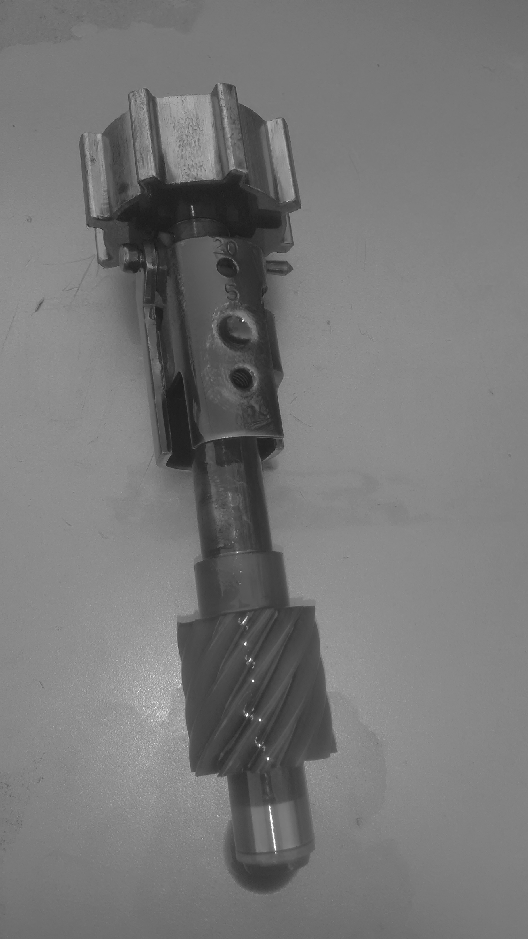

Here's the picture of the one out of the good transmission.
Apr 5, 2020 at 8:38 AM
Okay, that looks good.
That leaves either a valve body issue or internal failure such as clutches, seals, pistons or cracked drum.

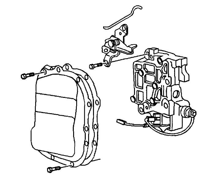

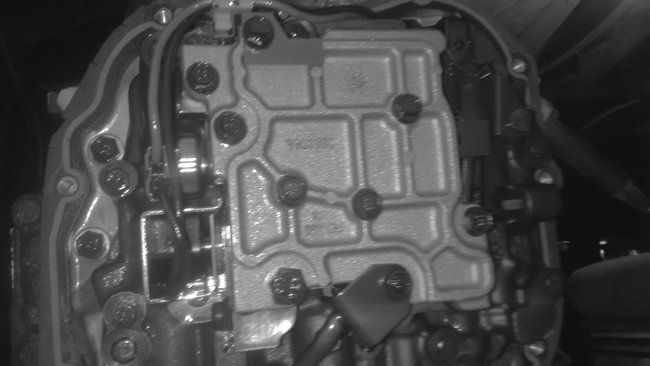

The valve body is that where the shift solenoid is? just tell me how to replace that. please I need the picture from where you take the cover off. is it under it on the side?

It is under the side cover. That is where the torque converter shift solenoid is located. It is installed in the valve body.
It contains the front pump as well as the valve body. I already attached a picture of the valve body a ways back in my responses.
Apr 5, 2020 at 8:46 AM

So do I take this off that first plate or?
