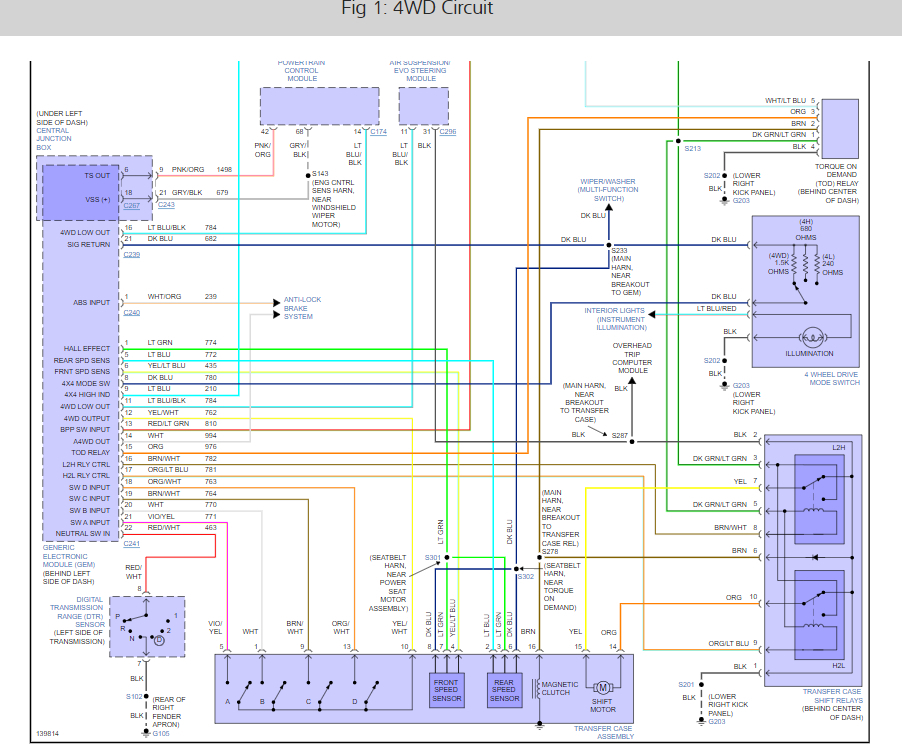

Shift motor wiring diagram needed?
150,000 MILES • 4.7L • V8 • 4WD
BEEPERPA
Replace the shift motor on the transfer case and I guess I messed up the wires where they go.
Jan 20, 2023 at 12:18 AM
  • 55,612 POSTS

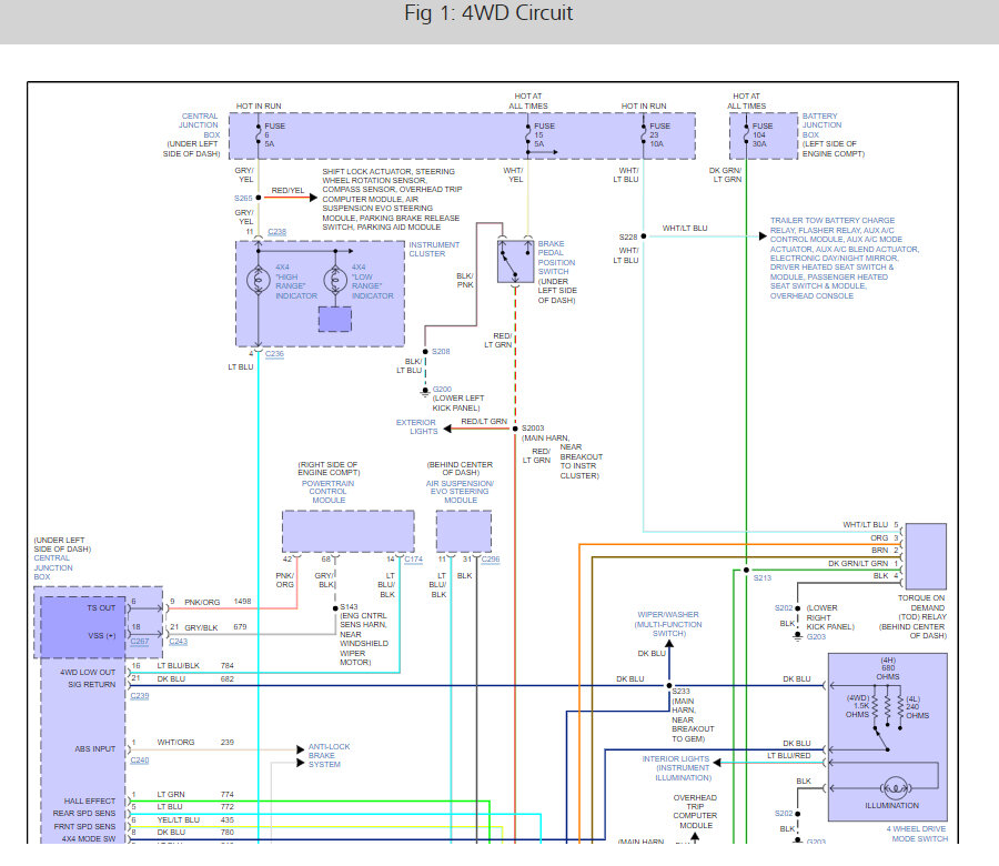

Here are the transfer case wiring diagrams so you can do the repair and I have included the wiring repair guide that will help you test the connections.
Check out the images (below). Please let us know if you need anything else to get the problem fixed.
