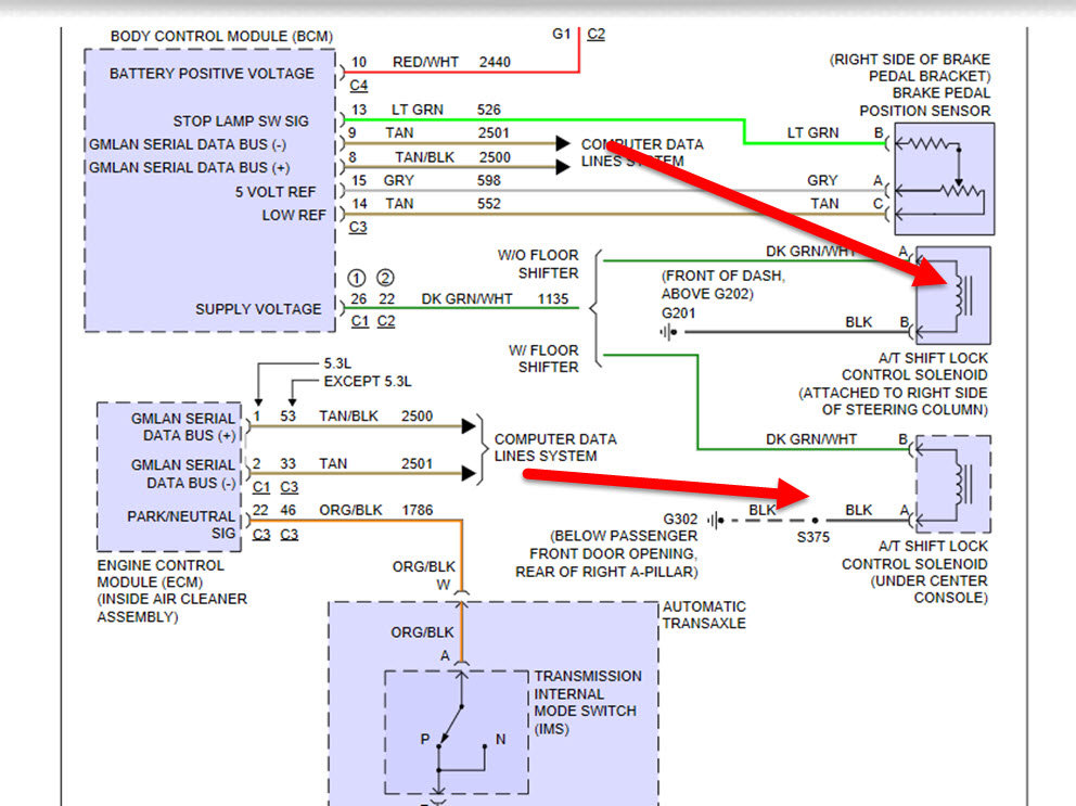

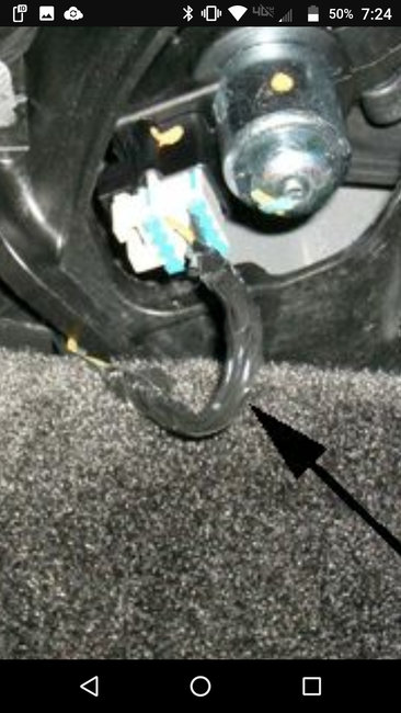

I cannot find where the color wires are supposed to be in which socket of the solenoid, previous person that worked on that part did not keep a diagram of which place the wires are supposed to be connected back together in. sent picture of the part I am working on , but it is not the exact one (found the picture). I am just trying to find which color goes in where on that solenoid.

see picture connector will be marked a/b put wires to that connector which will only go in one way. for some reason I cannot load picture have to send in another post.
May 31, 2017 at 11:31 PM
HMAC300
  • 48,601 POSTS
okay loaded this time.
