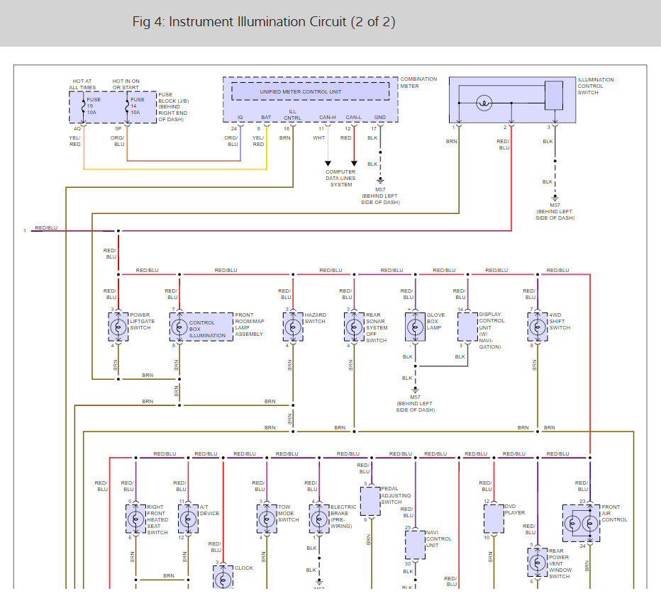

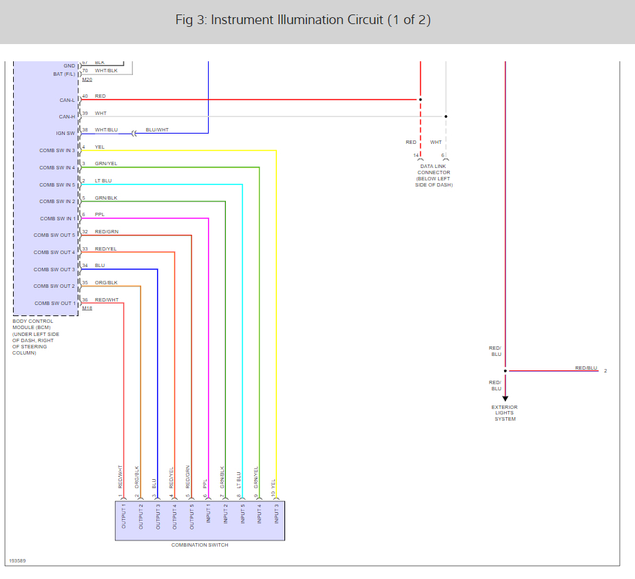

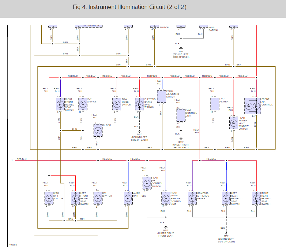

I no longer have back lighting for my shift controller or my heating and air controller system. I want to know if this is a fuse or a light bulb problem? And the simplest way to repair them.
Feb 12, 2018 at 10:10 AM
  • 54,832 POSTS

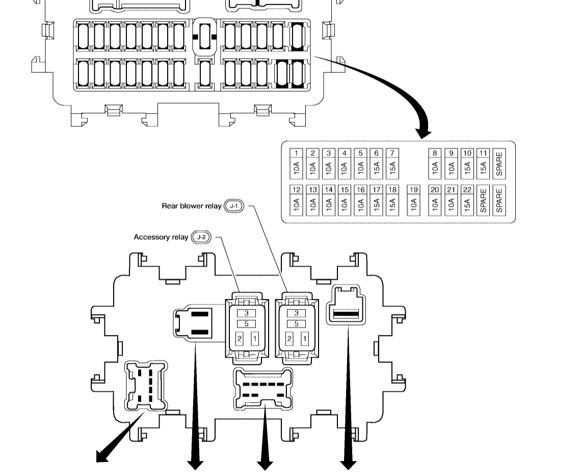

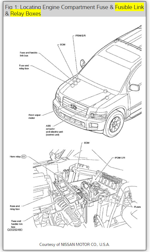

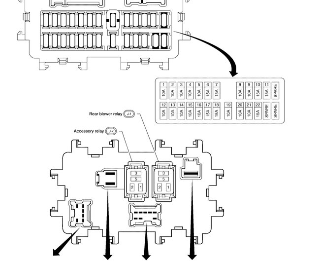

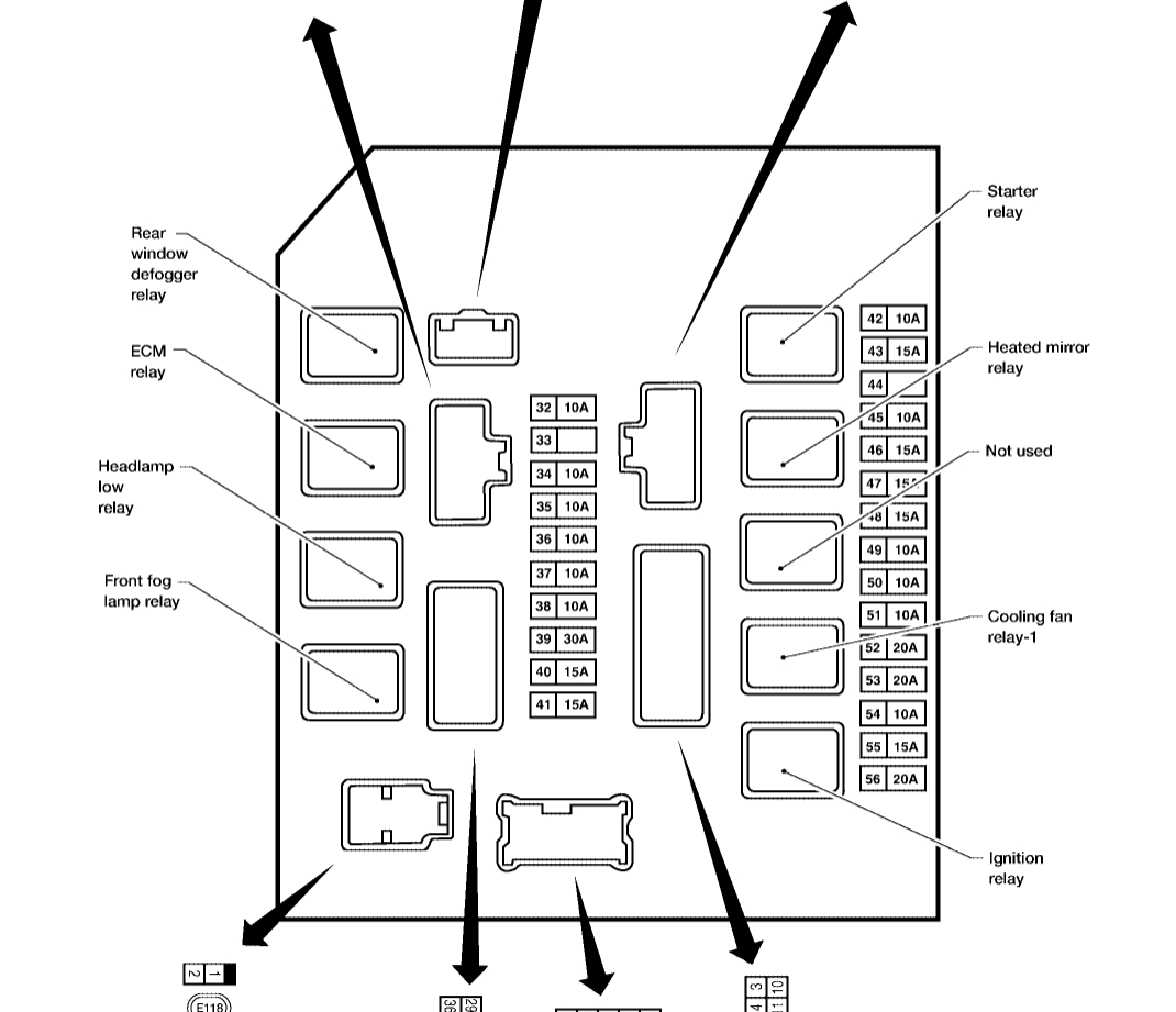

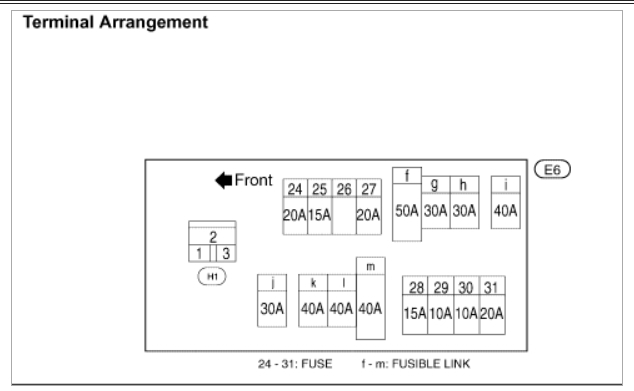

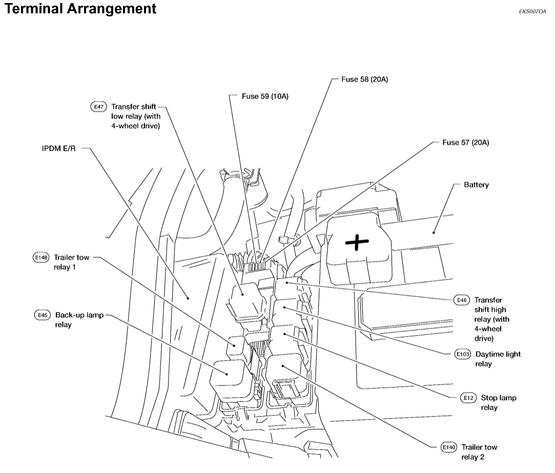

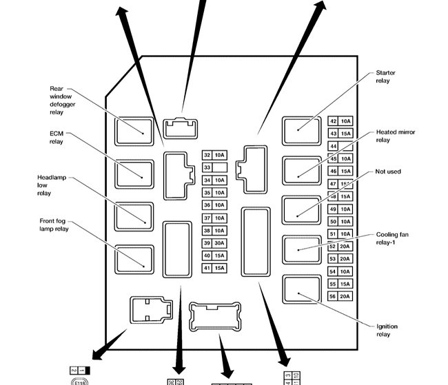

Yes there are four fuses that runt the system we should check first. Here is a guide to help you see what you are doing. Check # 59, 37, 36, 19, and 14.

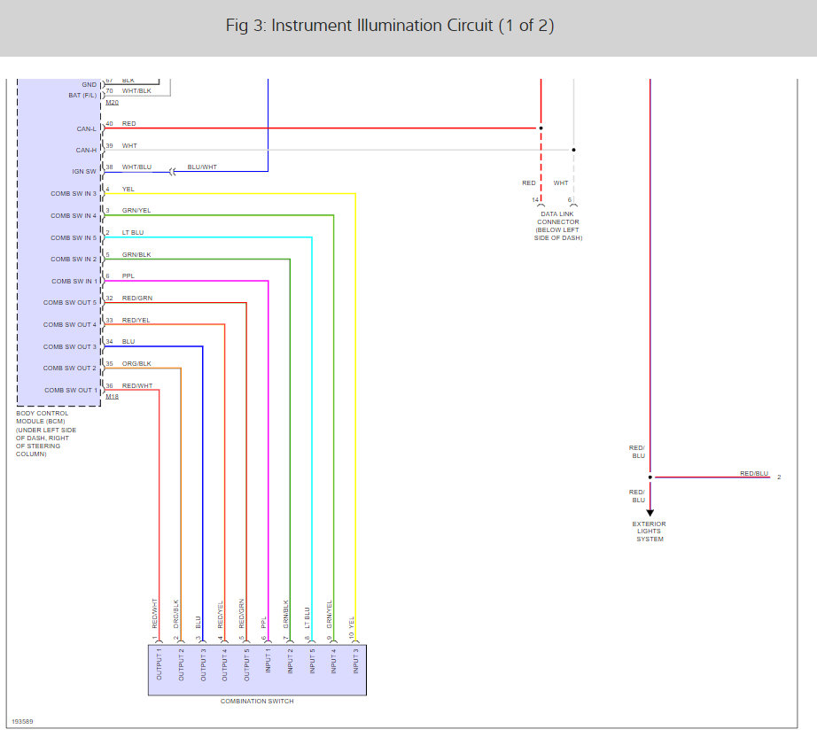

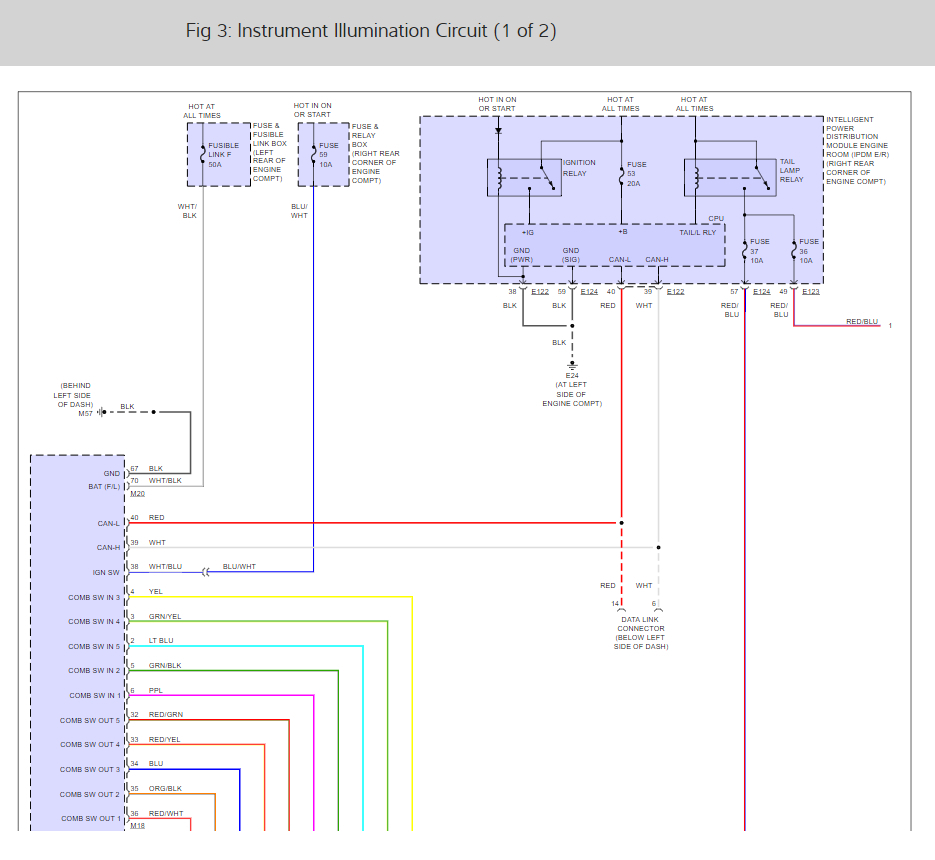

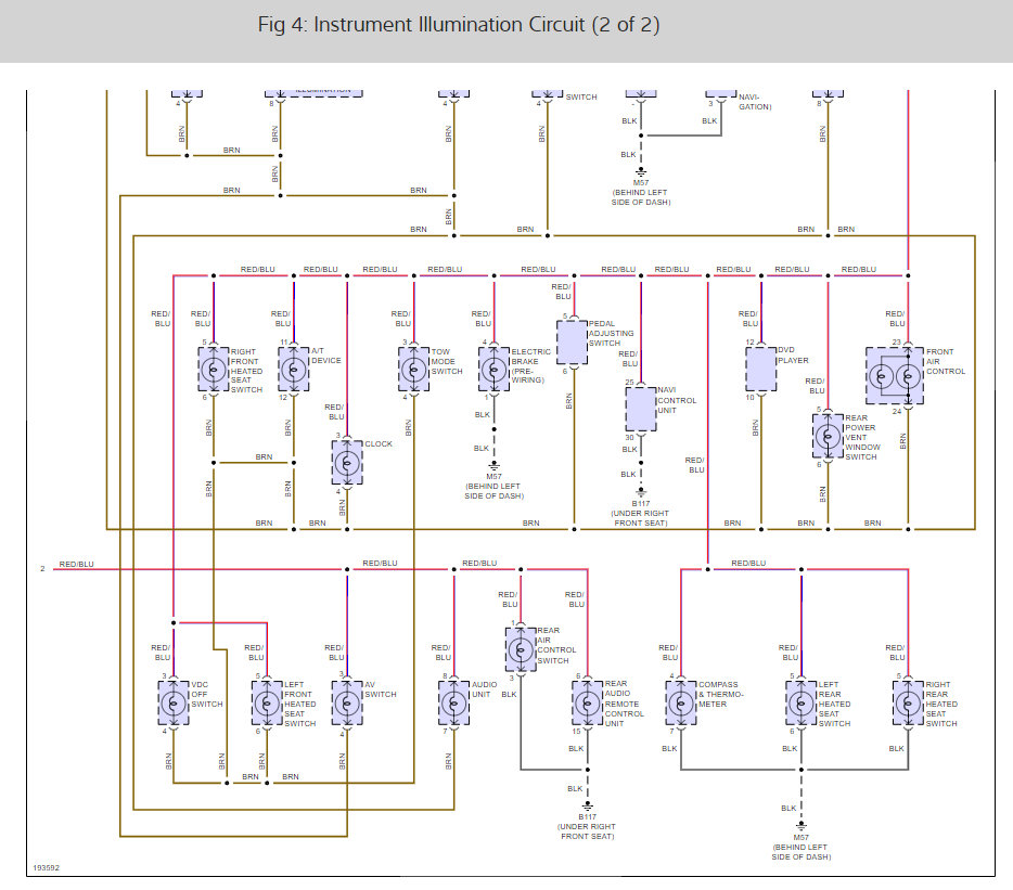

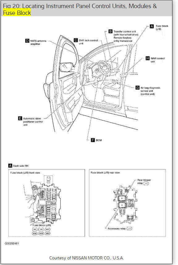

Here are the interior illumination wiring diagrams so you can see how the system works and the fuse panel locations.
