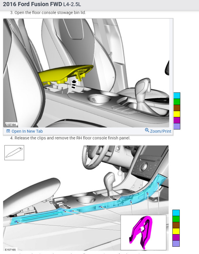

Car runs fine. Unable to shift.
Aug 3, 2022 at 8:33 AM
SQM
  • 6,383 POSTS

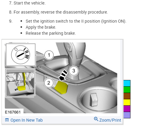

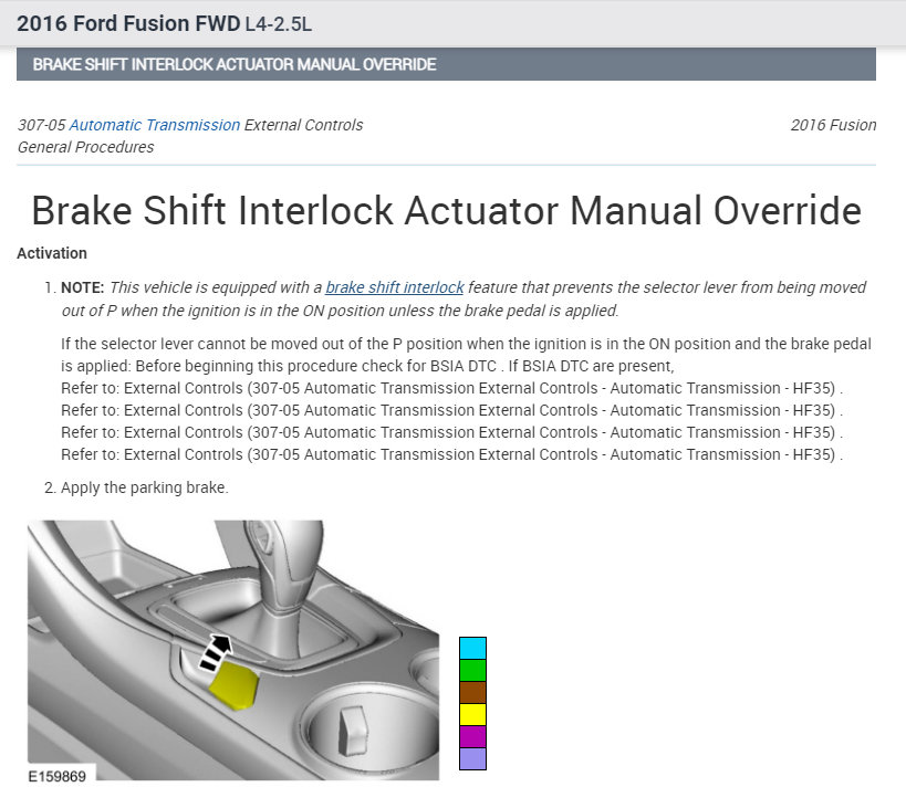

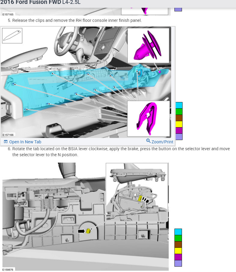

This could be due to the shift interlock. When the brake pedal gets pressed the solenoid releases the lock and allows you to shift out of park.
I have attached the manual override for the interlock below.
Let me know if you are able to shift out of park.
