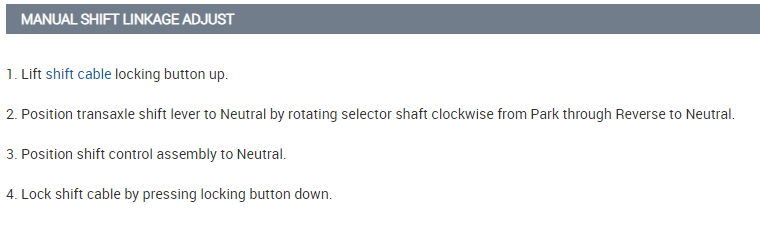

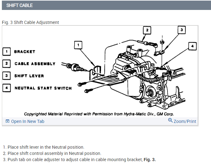

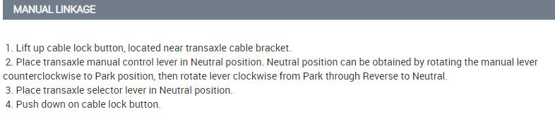

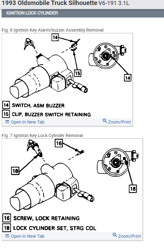

Key was lost and needing to move vehicle a short distance (will tow it). Having trouble finding it. If not, suggestions for how I can get it into neutral so I can move it. Thanks!
Jul 16, 2021 at 9:49 AM
SQM
  • 6,383 POSTS
Here is a link to the owners manual of this vehicle.
You should be able to find the instructions.
https://my.gm.com/content/dam/gmownercenter/gmna/dynamic/manuals/1993/oldsmobile/silhouette/1993_oldsmobile_silhouette_owners.pdf
Also see attached for some insights.
Any questions please let me know.

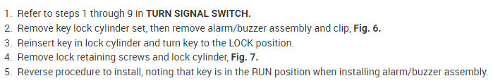

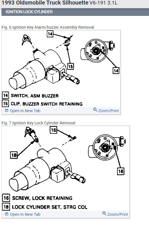

Thank you! So it appears the shift lock is in in the engine compartment near the shift linkage then-correct? I had actually looked in the op manual but could not find this info. Is there anything similar I can do to unlock the steering column as well?
Jul 16, 2021 at 10:11 AM
SQM
  • 6,383 POSTS
You possibly have to remove the lock cylinder in order to access the pin that locks the steering wheel. Let me know of any questions.
