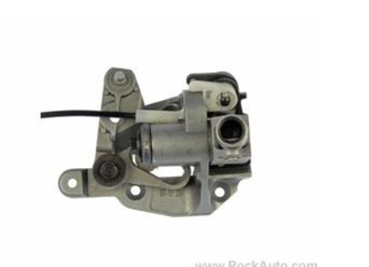

My shift lever and cable were working fine, when recently the pot metal on the shifter assembly on the side of the steering column cracked and I had to replace it. I replaced it with a Dorman after market assembly. After it was installed, it would no longer allow me to shift into low 1 (although I can pull the cable manually from below the steering column and it will go into low 1).
Two Questions:
1.) Is there an adjustment that I could tweak that would allow it to go into low 1 without keeping it from going into park on the other end of the scale?
2.) Which is more likely - that the Dorman part isn't quite to spec and isn't allowing the proper range of travel, or that the shift cable has stretched and needs to be replaced (although it did work OK before the original shift assembly broke)?
Thank you in advance for your help.

OK. I made the adjustment per your instructions. Here's the problem - If the cable is adjusted so it goes into park, it won't go into 1st. If it is adjusted to go into 1st, it won't go into park. Seems like there's not enough travel somewhere.
Do you think it is more likely a problem with the new Dorman shifter assembly, the cable, or something else entirely?

it may be the dorman assy that is not allowing you to shift correctly.or it was installed wrong but I kind of doubt that did you match it up with the one you replaced ? i'm sending a pic of the dorman part I looked up.
May 8, 2013 at 1:02 AM
MADMOOSE
  • 18 POSTS
Yes, that's the one. It does match up with the old one.
I suppose its possible I installed it wrong, but it's pretty straight forward - 3 torx screws to the column, shift cable and switch control snaps in the lever, and the ignition switch lock cable snaps into the ignition.
Anything I should look for on the Dorman that would be a problem?
