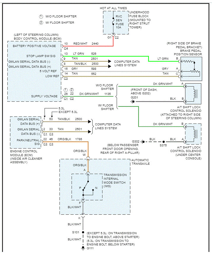

All my wires to my shift interlock solenoid have been severed and I'm having trouble finding a color coded wiring schematic/diagram online for free. Any help would be much appreciated.

I attached a pic below for both column and floor shift. Let me know if that helps and is what you needed. Check out the diagrams (Below). Please let us know if you need anything else to get the problem fixed.
