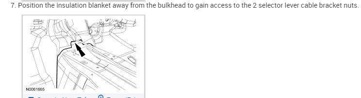

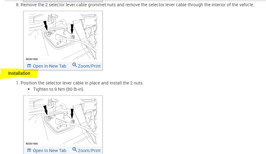

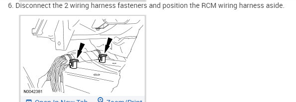

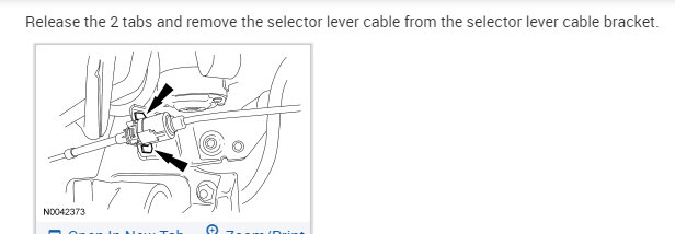

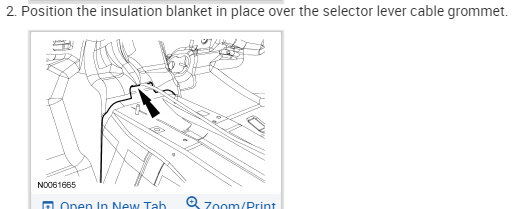

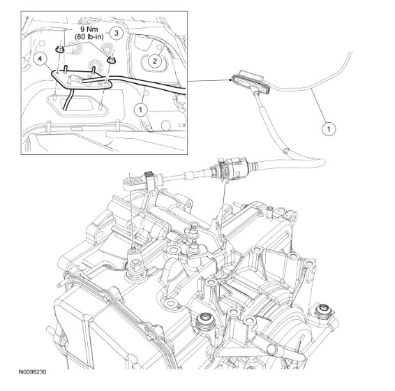

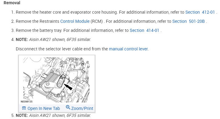

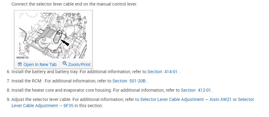

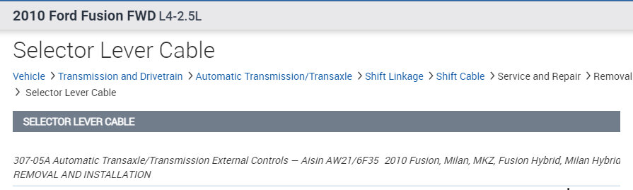

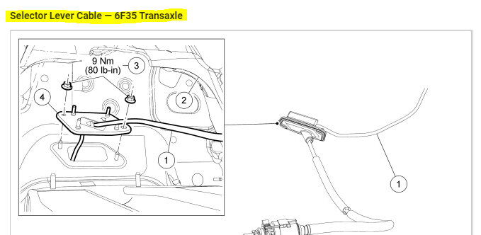

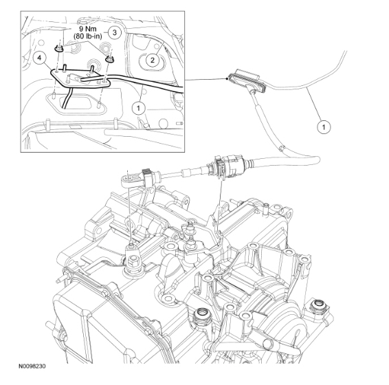

Need to know step by step how to replace shift cable.
Oct 24, 2022 at 4:46 AM
  • 110,244 POSTS

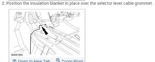

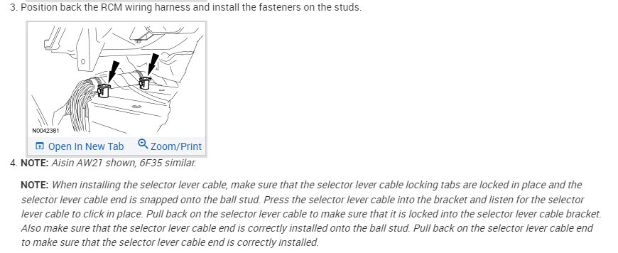

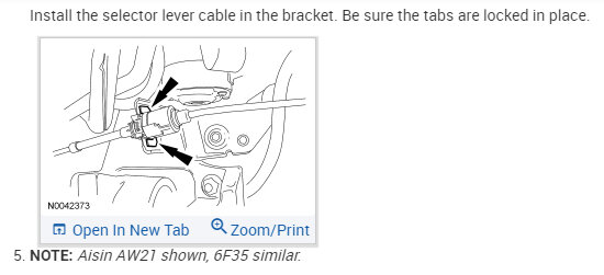

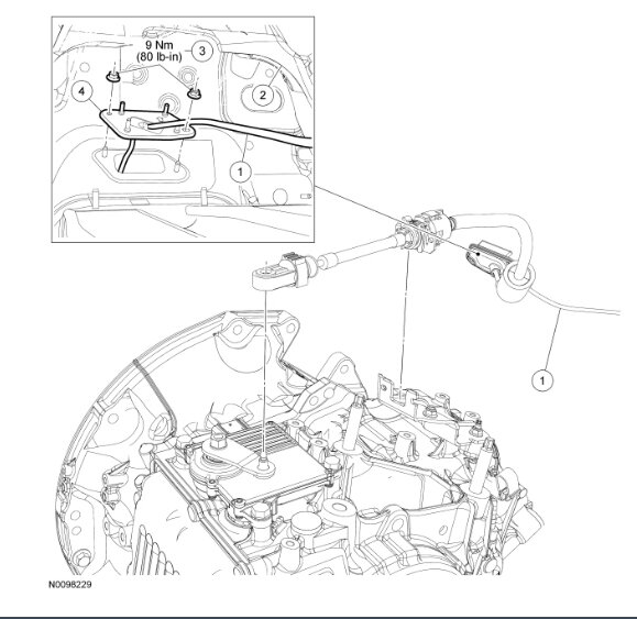

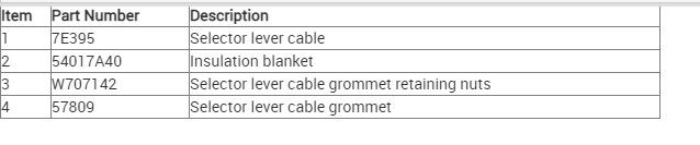

There are two different transmissions that were used. I attached the directions for the removal and replacement of the cable, which indicate both.
Also, let me know which one you have so I can get you the correct adjustment directions.
