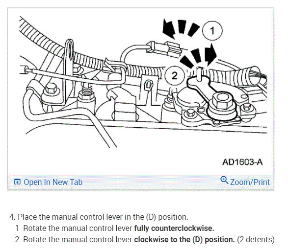

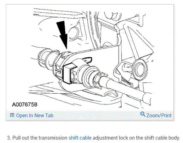

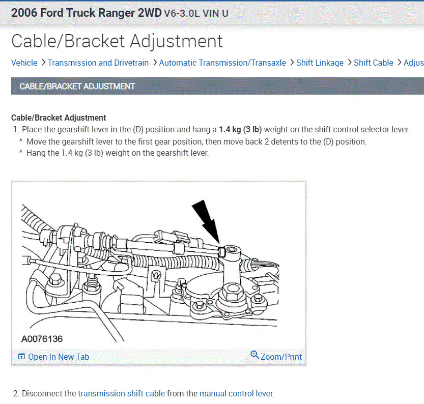

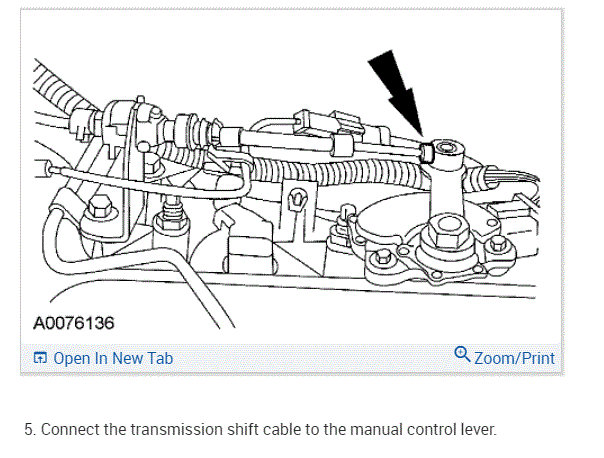

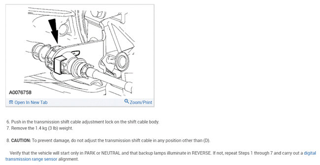

Is there a way to adjust the shift cable or a certain gear you should have it in when you hook it up? I recently swapped out my transmission and can't put it in park or first unless I manually do it on the transmission. I've already tightened up the shifter torx bolts so it's not a loose shifter.
Dec 2, 2021 at 6:20 AM
  • 110,244 POSTS
As far as adjustment, there is an adjustment procedure at the transmission shift cable bracket. I attached the directions below.
Take a look through them and let me know if it helps.
