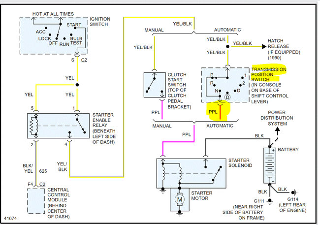

Yes, I have the car listed above ZR1 Corvette and I have replaced everything in it and it cranked a couple times. But it got too cold to work on during the winter months. But one day when I was trying to get it off the ramps I put it in reverse and it popped pretty hard. And every since I did that it wont crank. The dash lights keep reading shift. Which i'm sure relates to the park neutral safety switch and the gear shift linkage. I have checked that and it's fine it shifts just like it's supposed to but it's not registering what gear it is in in order for it to crank. So with that being said do you have any idea what would cause the shift light to come on and no crank no start. If you know of anything that might help me get my beautiful car cranked I will be forever grateful to you sir. Thank you and God Bless. I just want to drive it again it has been over 6 months. And a lot of money on her.

If you are not seeing a gear indication, chance are it is related to the transmission position switch. It is located at the base of the shifter in the console. Is that the one you checked?
If you look at pic 1 below, I attached the wiring schematic for the starting system. I will need you to check for power out from the trans position switch (purple wire) when trying to start. If there is no power, go back to the yellow wire with the blue tracer and confirm there is power.
If there is no power at that point, then the starter enable relay needs checked. It is located under the dash on the driver's side. If you have a different relay with the same part number, switch them to see if it makes a difference. If you don't have one, here is a link you may find helpful. It explains how to test a relay.

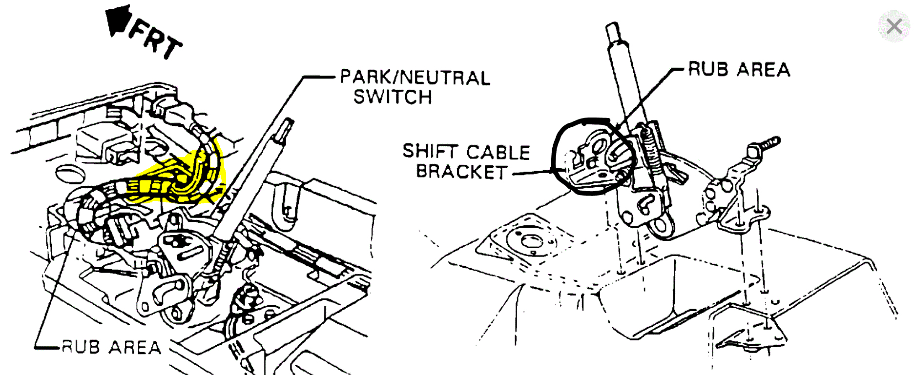

One last thing. When you check the switch, check the wiring near the shift cable bracket. I remember there being issues with the wiring rubbing against the bracket and causing damage. See pic 2 below. I circled the bracket and highlighted the wiring harness.
Try this and let me know what you find or if you have other questions.

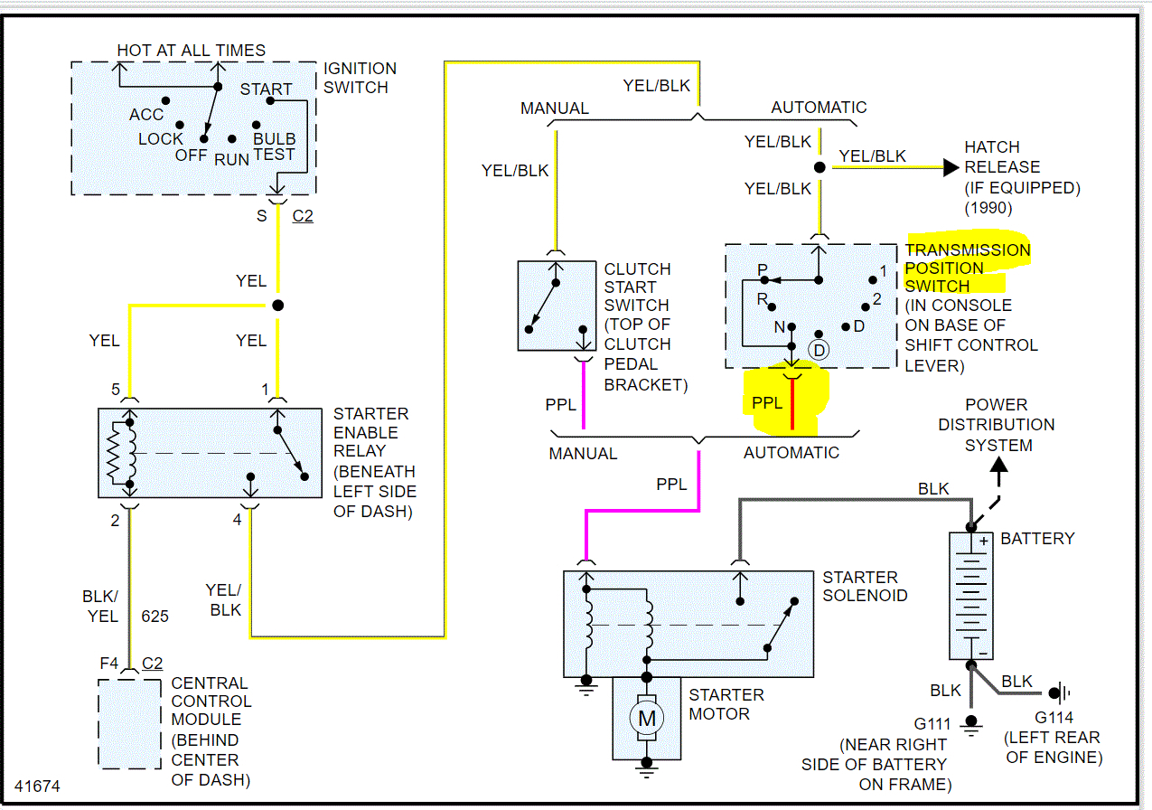

See pic below.
