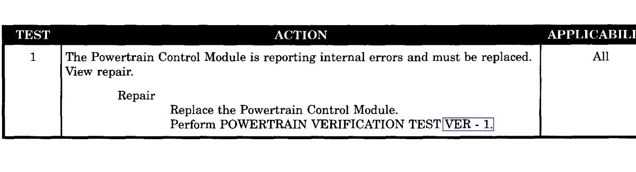

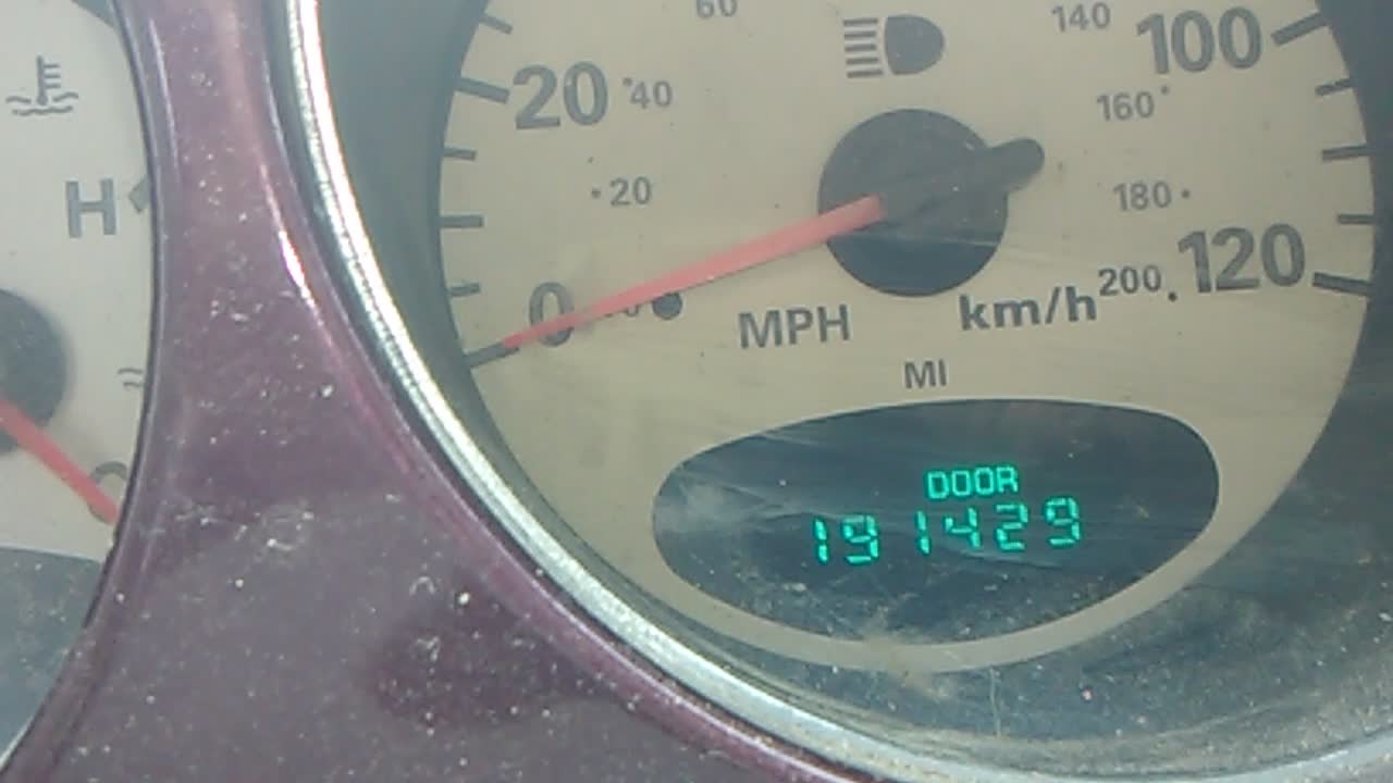

The car stalled while I was driving home from work and would not restart. The battery is still strong. Did the key test and where you turn the key and it shows code p0600.
Jun 20, 2018 at 7:03 PM
Good morning.
The code indicates a PCM failure. The PCM has failed and needs to be replaced.
Symptom:
P0600-PCM failure SPI communictations.
When monitored:
Ignition key on.
Set condition:
Internal Bus communication failure between processors.
Possible causes:
- PCM (Internal or SPI)

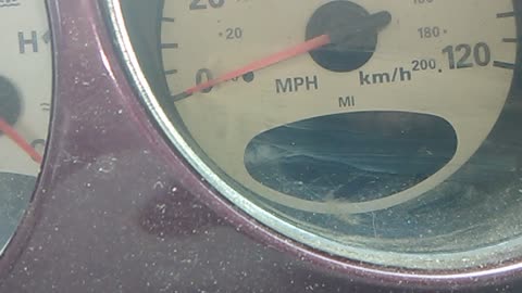

What does this mean? This time I hit odometer button first then turned key on. Sorry to monopolize your time. Will also add a picture of the key on off on off then push odometer.

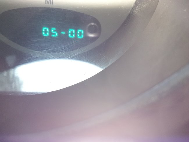

Okay, when I turned key on off not hitting odometer button code said p0320. When I did it with button in it read 05-00. I know I am a pain. But so appreciative of you. Thanks to Roy for his patience.

Okay, it does not show p0600. It appears as 05-00 another code showed as p0320.

Okay. When I turned key on off not hitting odometer button code said p0320. When I did it with odometer button in it read 05-00, then went through 000000 999999. I know I am a pain. Had to put my glasses on to see it. So no p before that 05-00. Temporary dingbat mode, lol. So appreciative of you. Thanks to Roy for his patience. Will post picture of 05-00 reading. And what is p0320?
Jun 23, 2021 at 9:17 AM
PT_MAMA
  • 8 POSTS
This is turning key twice with odometer pushed in if I turn key three times it reads the p0320. Above is video and more information. And huge thank you Roy. And I am such a girl I know "no crying in baseball "or mechanics.

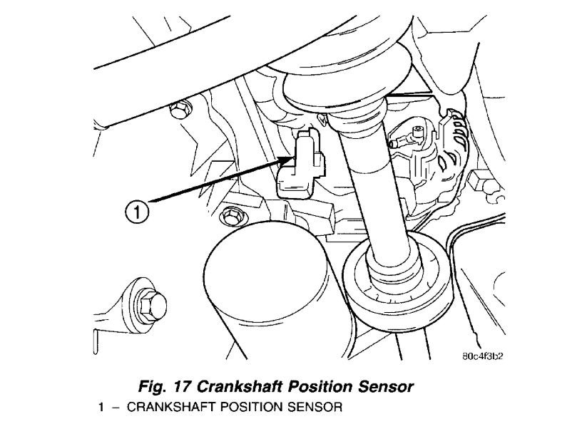

Okay, the 320 is most likely a crank sensor failure. Common issue. That would explain why it stalled.
Symptom:
P0320-No crank reference signal AT PCM
When monitored:
With the ignition in either the start or run position and battery voltage between 4-15 volts.
Set condition:
No signal from the crankshaft position sensor is present when engine vacuum is present or cam signals are present.
Possible causes:
- CKP signal circuit shorted to voltage
- 8 volt supply circuit open
- 8 volt supply circuit shorted to ground
- 8 volt supply circuit shorted to CKP signal circuit
- PCM (8 volt supply)
- Sensor ground circuit open
- Irregular lab scope pattern of CKP signal
- Stray signal from the camshaft position sensor
- Wiring harness intermittent
- CKP signal circuit shorted to ground
- CKP signal circuit open
- CKP Signal circuit shorted to sensor ground circuit
- Powertrain control module (CKP signal circuit)
Removal:
1. Remove the air cleaner lid, disconnect the inlet air temperature sensor and makeup air hose.
2. Remove the negative battery cable.
3. Raise the vehicle and support.
4. Disconnect electrical connector from crankshaft position sensor.
5. Remove sensor mounting screw. Remove sensor.
Installation:
1. Install sensor and tighten the screw to 13 Nm (115 ± 15 in. lbs.).
2. Connect electrical connector to crankshaft position sensor.
3. Lower vehicle.
4. Install the negative battery cable.
5. Install the air cleaner lid, connect the inlet air temperature sensor and makeup air hose.
