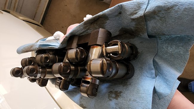

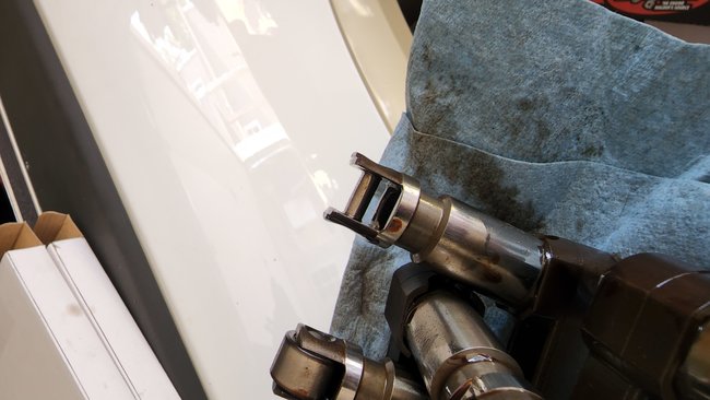

I had the hemi tick and after pulling the lifters I found my number three cylinder lifter roller was shattered, and the pieces did not come out with the main body.
What are my next steps? Is the engine a loss, can I fish it out with a magnet, is it in the oil pan, or do I need to dismantle the engine?

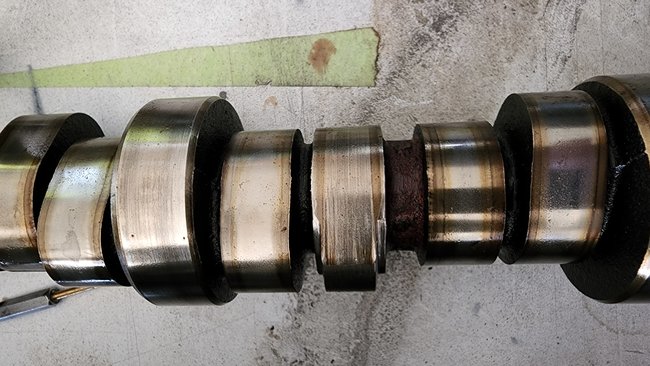

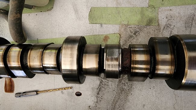

BOSTER281
Here are a few pics.
May 23, 2022 at 11:56 PM
  • 110,241 POSTS
It appears to need a new cam as well. I would try to get as much as you can out, and it should be okay.
