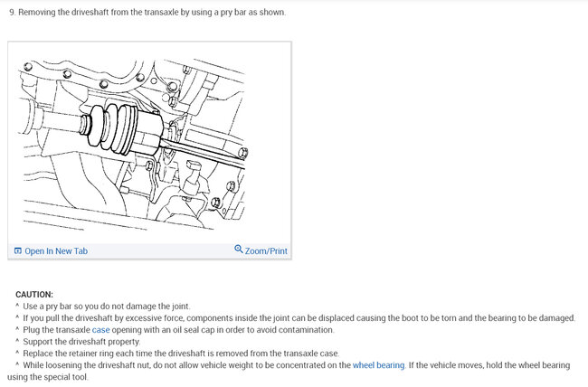

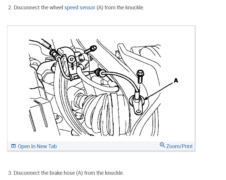

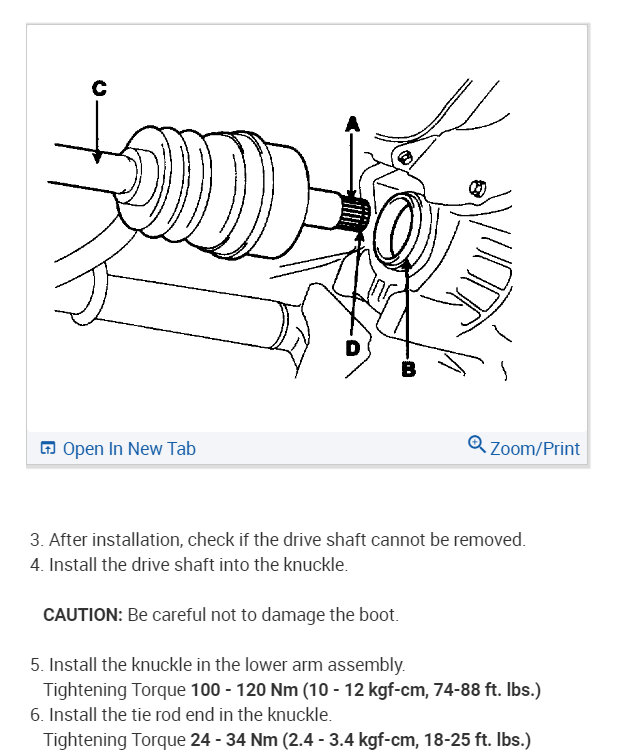

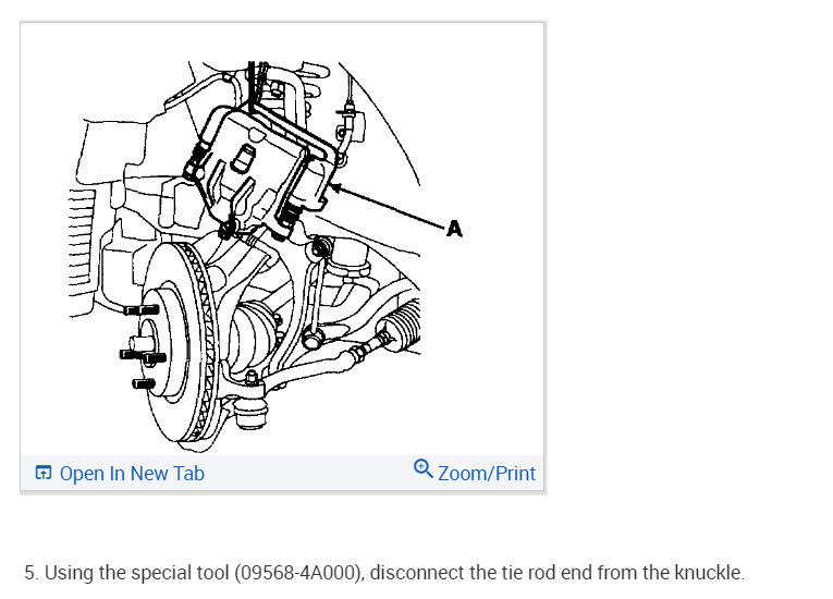

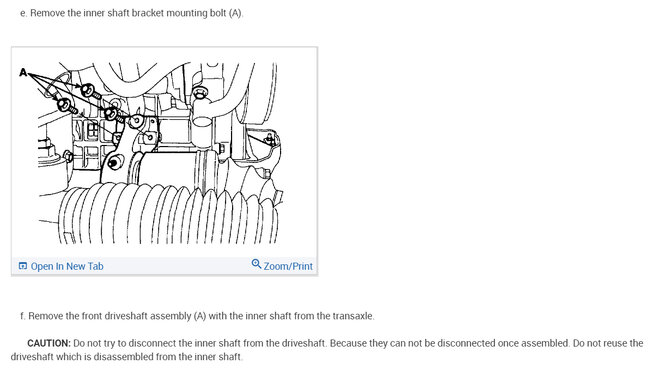

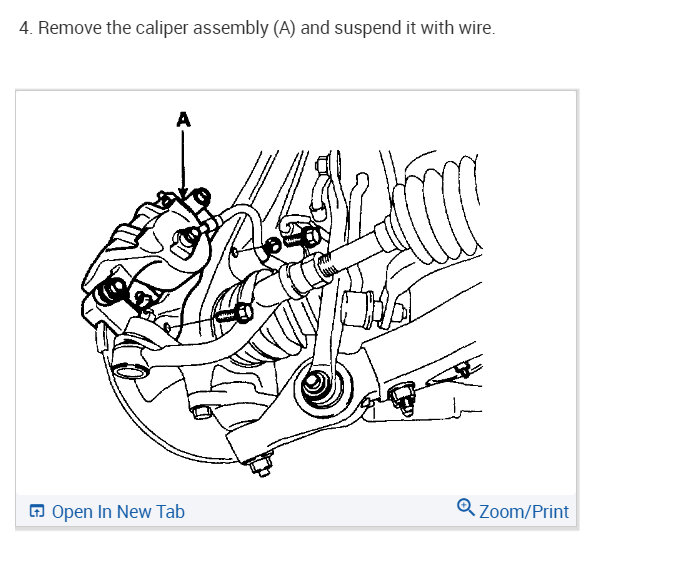

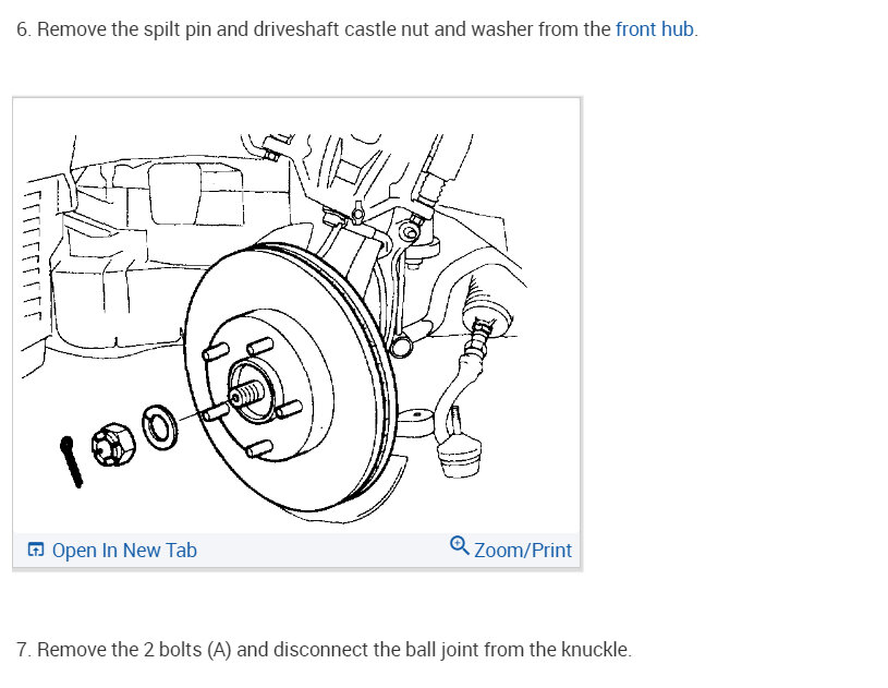

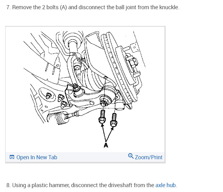

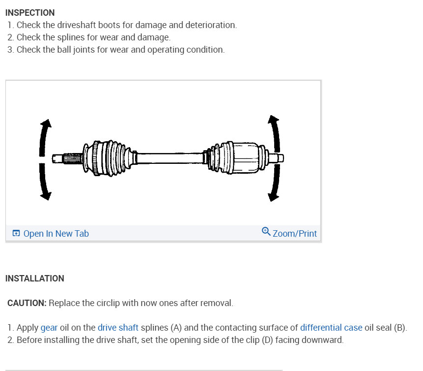

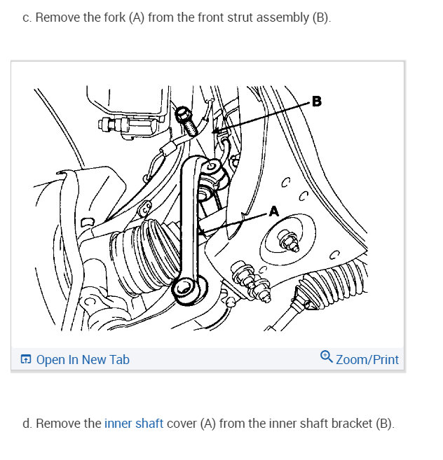

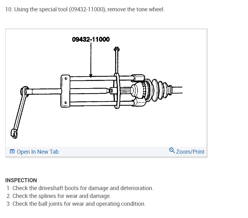

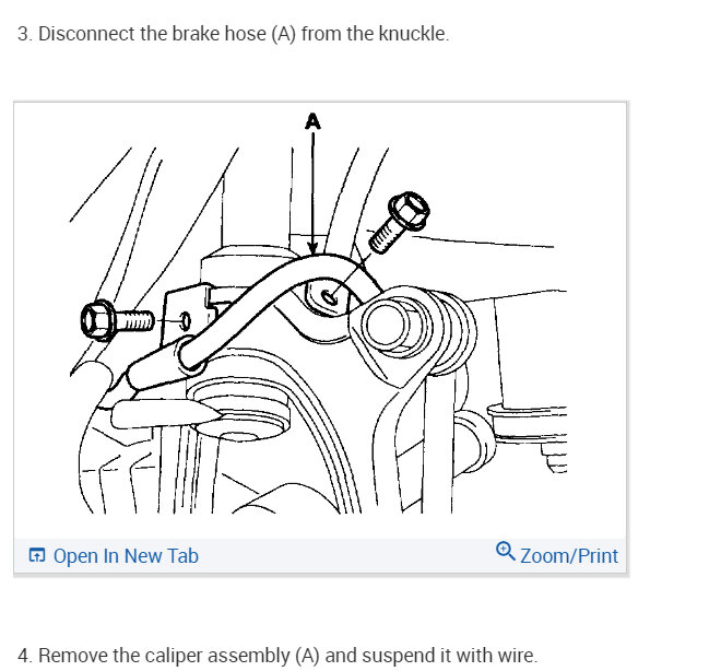

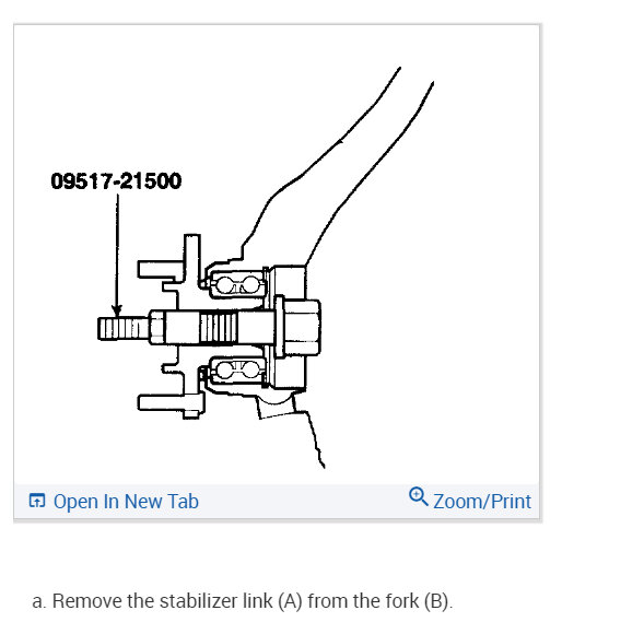

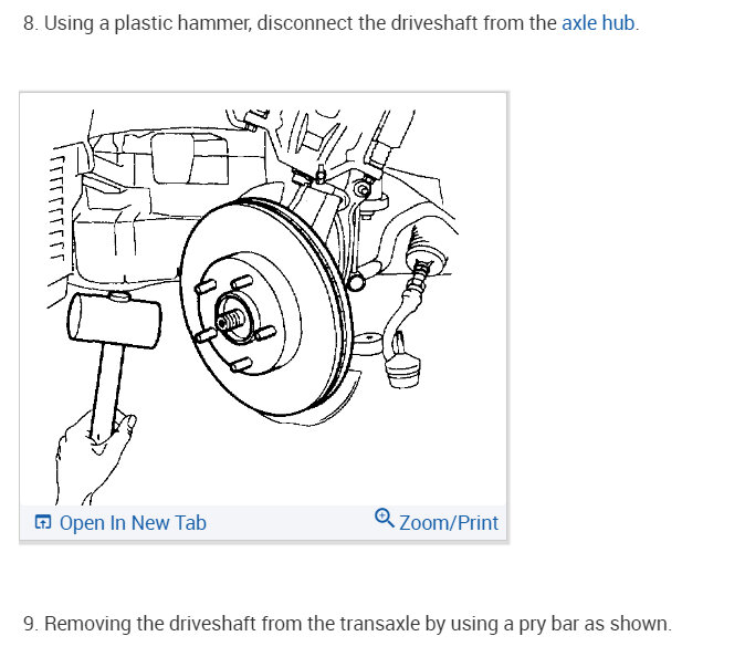

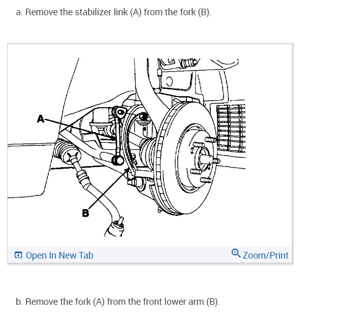

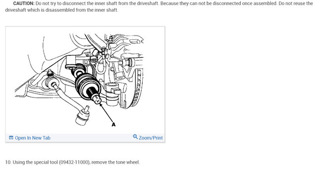

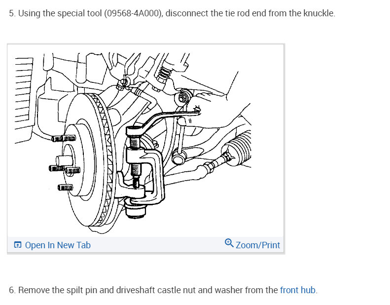

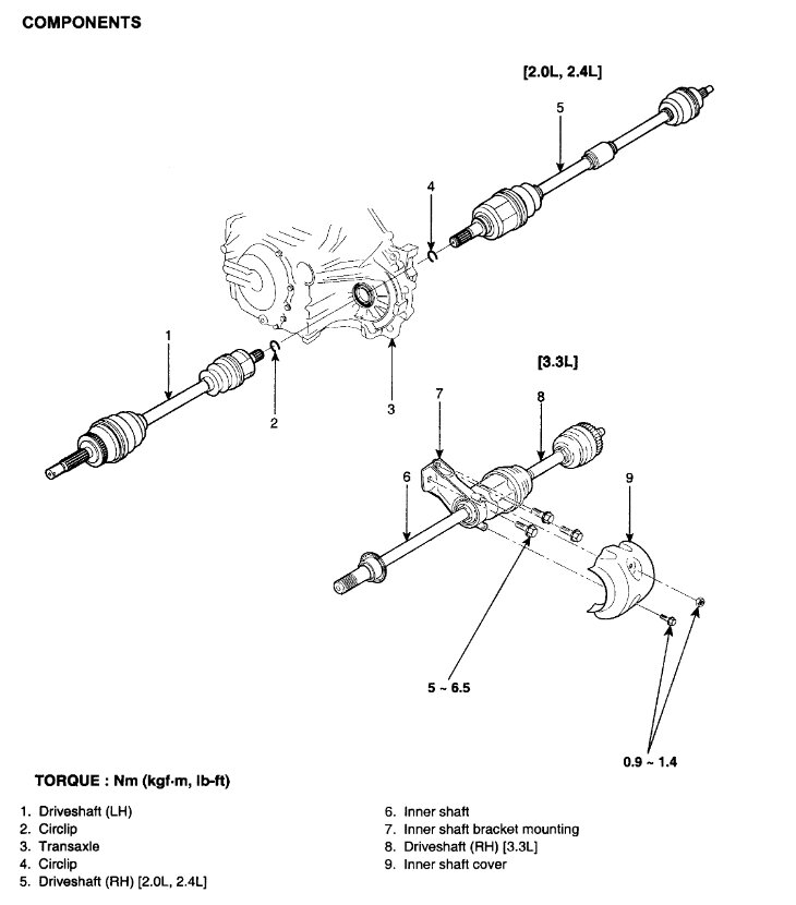

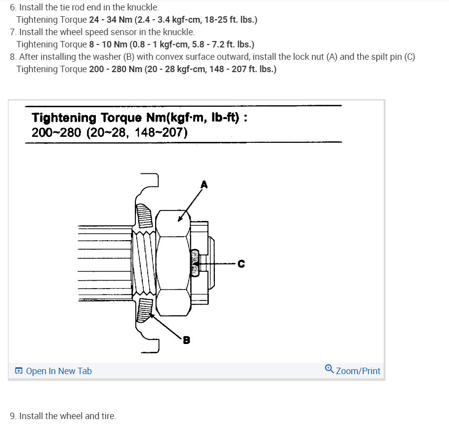

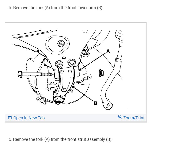

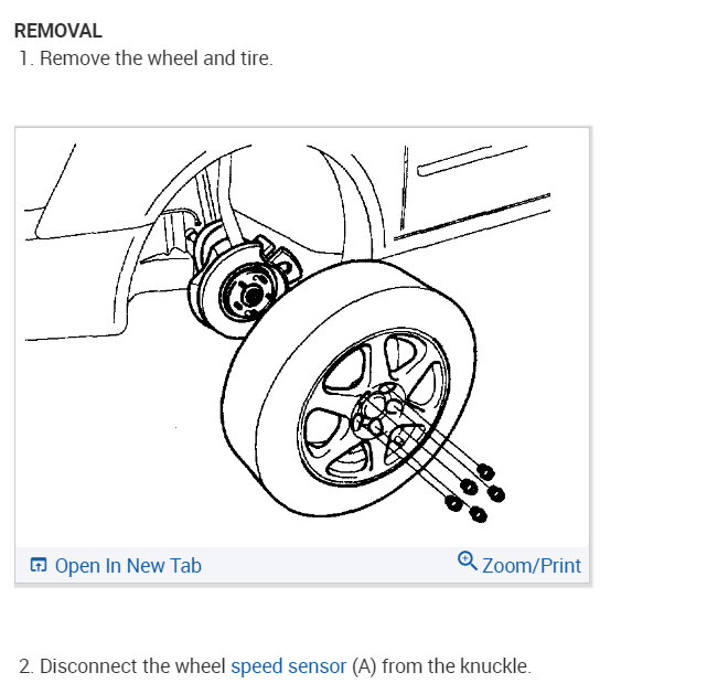

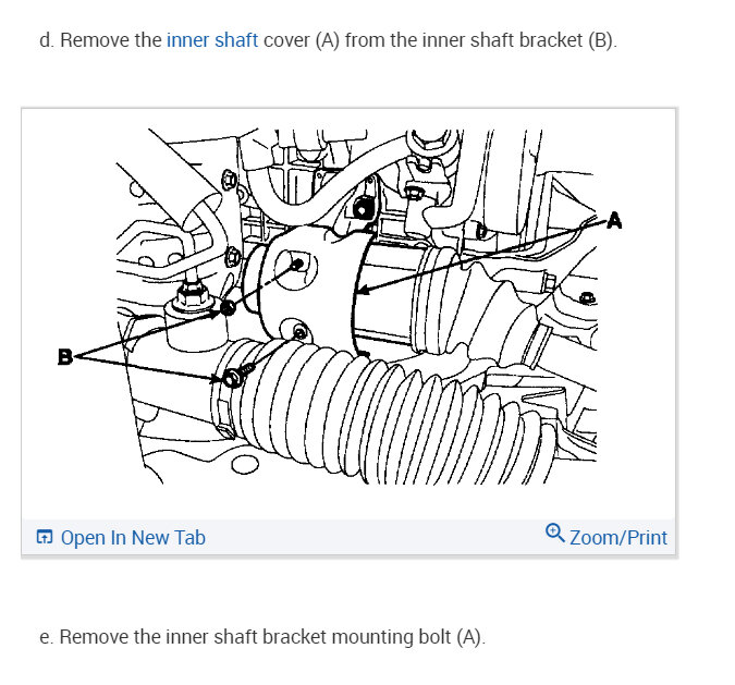

If the engine is running okay it sounds like the CV axles need to be replaced. here is a generic guide to help you step by step with instructions in the diagrams below to show you how on your car:
https://www.2carpros.com/articles/replace-cv-axle
