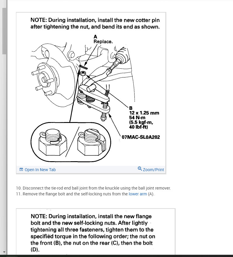

Normally this is a CV axle or wheel bearing so if you changed these then we need to move onto checking the rest of the front end. The next likely thing would be the tie rod, either inner or outer.
So, you need to lift the front end and wiggle the tire at 3 and 9 o'clock and find out if there is any movement. There should be none and feel tight. If the tire moves when wiggling this way, then you need to replace the tie rods.
https://www.2carpros.com/articles/tie-rod-end-replacement
https://www.2carpros.com/articles/steering-wheel-shakes-when-accelerating-or-braking
Please run through this and let us know what you find. Thanks

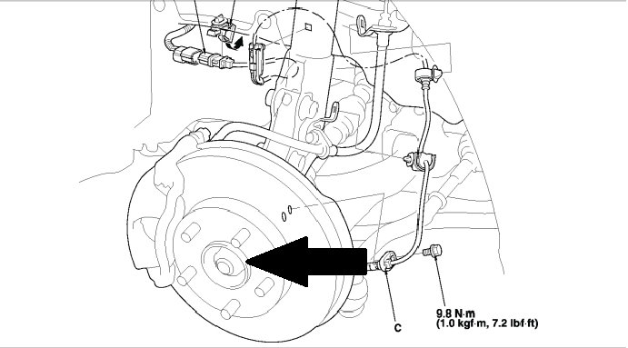

Problem solved it seems the part indicated below was bent from one side causing the rim when fitting not centering properly i filed it all around and it solved the problem.
Thanks for your time.
Jan 4, 2022 at 4:11 PM
Oh wow. Great find. That is the centering hub so that makes total sense now that we know that.
Thanks for the update as I am sure that info will help others in the future.
