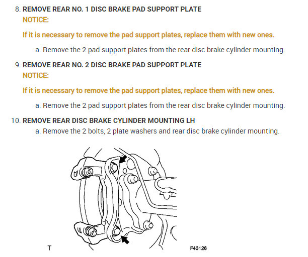

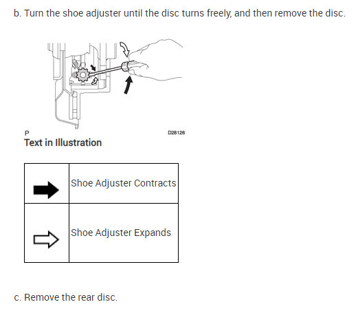

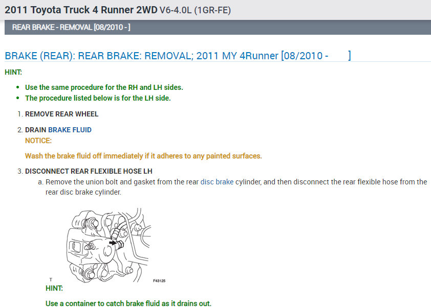

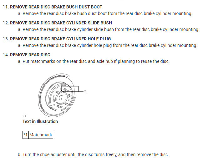

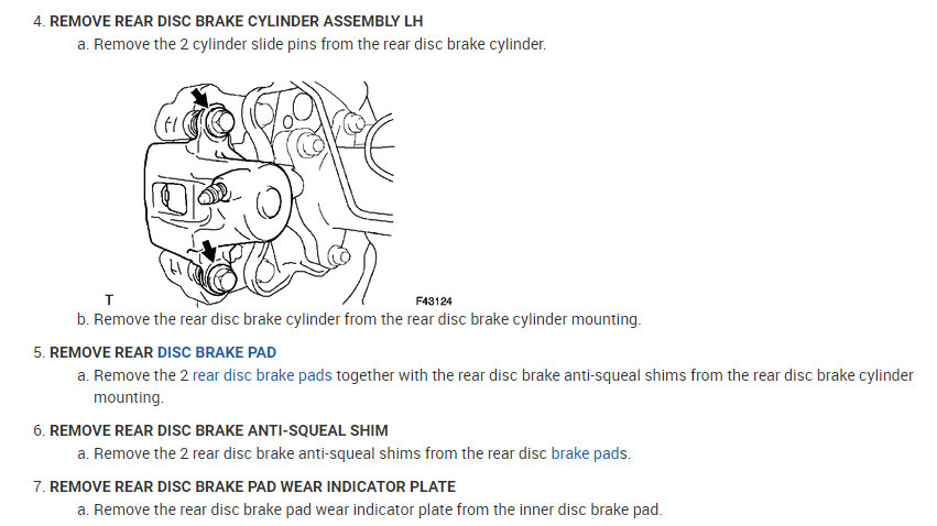

when driving over 40 mph and braking the 4runner grinds from the rear. Its terrifying to me and especially more so when my wife is driving. This cannot be safe can you show me how to do brakes on the back please? thanks

Here is a video to help you step by step with instructions in the diagrams below to show you how on your car.
https://youtu.be/r82BLijWuNQ
Here is a YouTube video from our site on how to compress the rear caliper piston when performing a rear brake job:
https://youtu.be/j8YwfSKEzZo
I've attached picture steps below on how to replace the brake pads on your truck. Hope this helps and thanks for using 2CarPros.

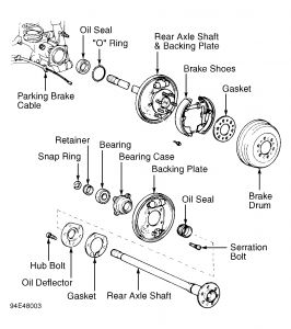

What does it mean when there is oil leaking into your rear brakes?
Apr 12, 2021 at 9:43 AM (Merged)
OBXAUTOMEDIC
  • 3,711 POSTS
You will need to change the Brake Shoes and Axle Seal of course. You can get some Brake Cleaner to clean all other parts in the Drum. However, you will need to remove the axle from the housing in order to replace the seal....
