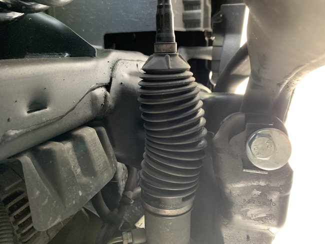

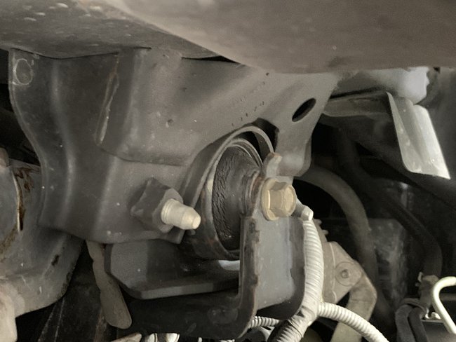

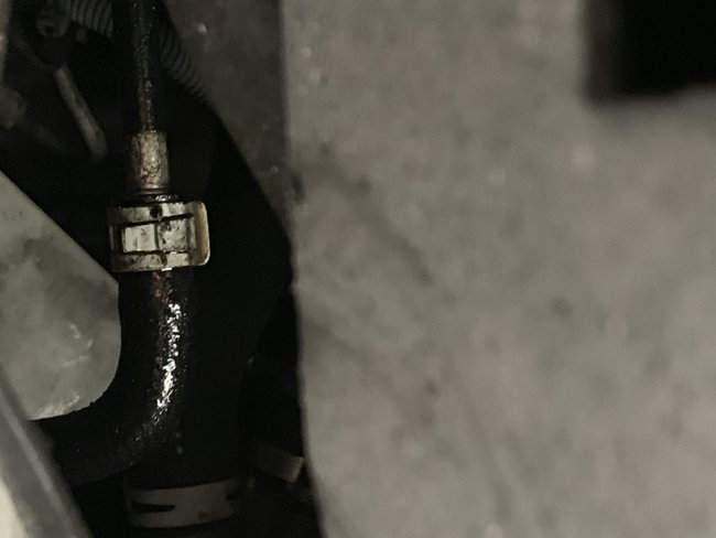

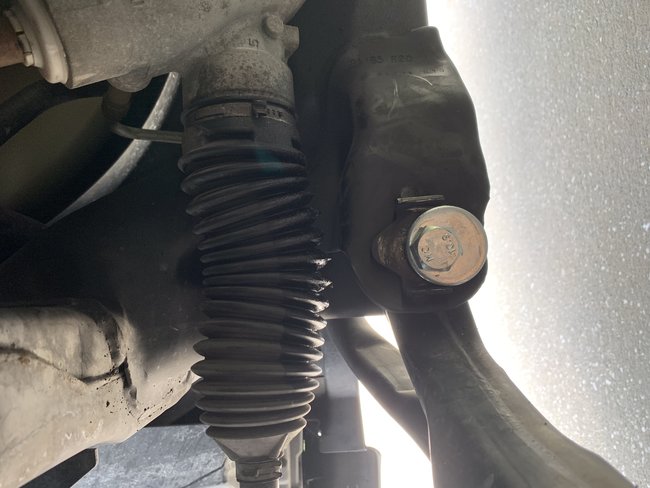

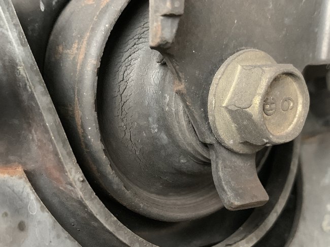

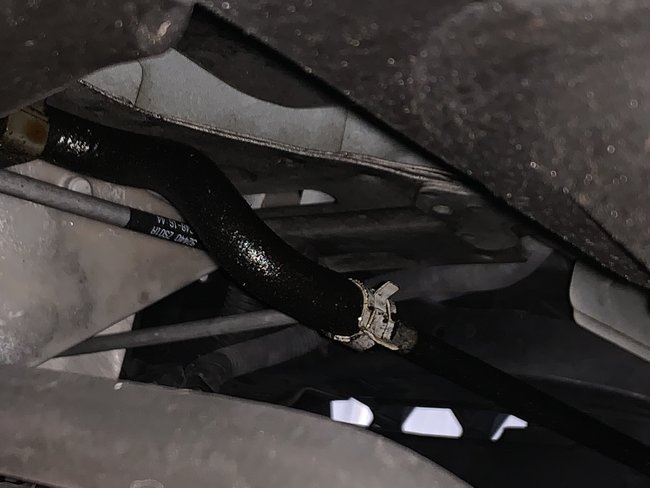

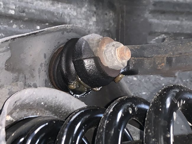

Went to dealer today and showed me that the rack n pinion leaking little , also driver’s side upper ball joint boot crack can see grease , see Attached left and right side boots , leaking power steering hose that goes to coolant, also attached both engine motor mounts. Last picture is the hose again.
Jul 12, 2019 at 1:57 AM
Very good information. Clearly we should fix all of that and retest. I doubt the power steering hose leaking is causing this but obviously a leak is not good. However, the other issues will cause what you are seeing. Please keep me posted on what happens. Great pictures. Thanks for the update. This will surely help others that have this type of problem.
