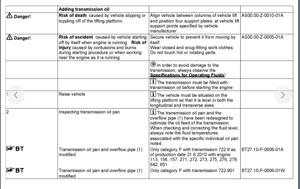

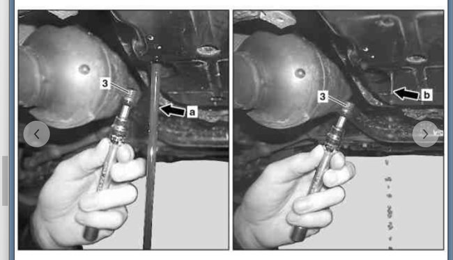

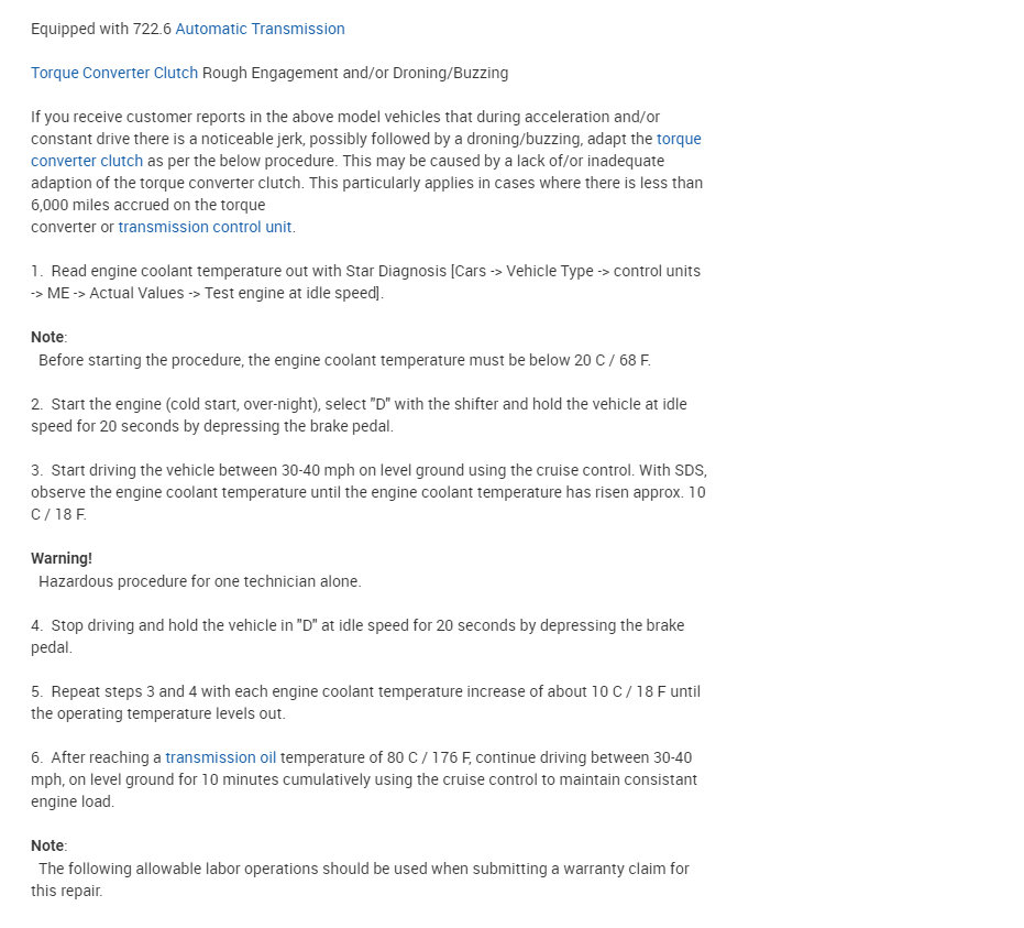

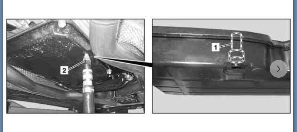

I suspect you have a torque converter issue. If you have a scan tool that can monitor this data, can you monitor the RPM vs the input speed sensor? Basically, you should see the input and RPM be pretty much the same, but I suspect in first gear they will be different which means the converter is not transferring the power properly.
https://www.2carpros.com/articles/engine-surges
Also, I am attaching a TSB that has a similar complaint and it talks about a converter issue as well. However, this is not going to solve your issue. This is talking about how to break in a new torque converter to stop this issue from happening. I am attaching this because it displays how the torque converter can cause these types of issues.
Basically, we can eliminate an engine issue if when this issue starts, you bump it to N and the issue stops. That tells us that we most likely have an issue in the transmission and the likely cause is the converter.
Let me know what you find with this or what questions you have. Thanks
