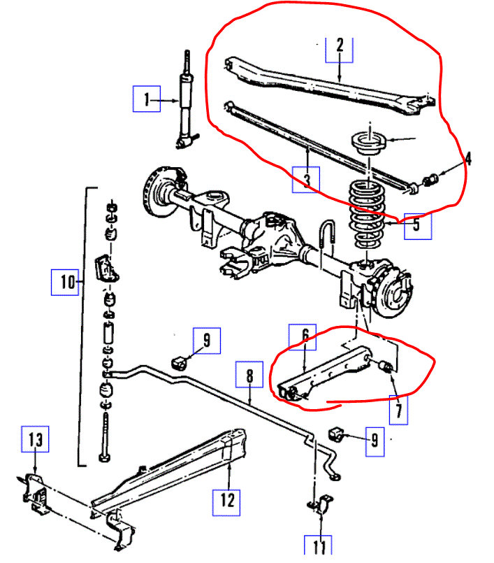

When taking off car shakes from side to side in back and when stopping at a slow roll.

If the rear of the vehicle is shaking from side to side, first, make sure there are no problems with the trailing arms and the lower control arm.
I attached a pic below and circled things I need you to check. Note that lateral control arms. Make sure where they attach there isn't anything broken or rusted.
Let me know what you find. Note, where the strut mounts to the lower control arm. Make sure nothing is loose on the control arm itself.
