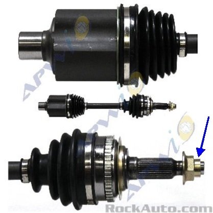

GM also often uses a "torque-to-yield" axle nut. These are a one-time use nut and must be replaced any time they're loosened. You can get new axle nuts at the dealer's parts department, and probably at most auto parts stores. Reusable nuts look like regular nuts, but larger, and have a stamped steel cage with a cotter pin that goes through it. They also use a large washer. Torque-to-yield nuts have a larger-diameter ring cast in that contacts the hub, instead of a separate washer, and they don't use a cotter pin. This photo shows the half shaft and nut for your car model. The torque-to-yield nut is shown, and the blue arrow is pointing to an outer ring that must be dented with a punch to sit in a slot on the shaft. That dent keeps the nut from working loose, similar to what the cotter pin does.
