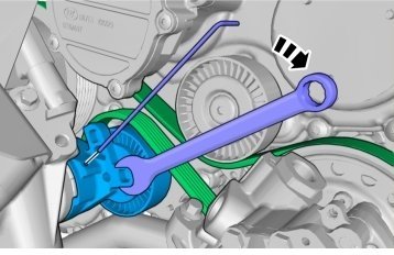

First, there is only one belt on the vehicle, a serpentine belt. It drives all accessories including the alternator and ac compressor. If the alternator wasn't an issue after he replaced it, chances are it should be fine unless he left something loose which could be binding the belt. Next, if the AC compressor clutch has locked up, it will both prevent the engine from turning and make a lot of squealing noise because the belt is trying to turn something it can't. The easiest thing to do in this case is to remove the serpentine belt and see if the car starts normally after doing that. If it does, then it confirms it is one of the belt driven accessories. And yes, I have seen situations where a locked up AC compressor clutch prevented the engine from turning with the starter.

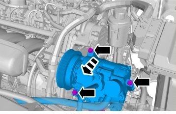

With all of that in mind, first inspect the alternator to confirm it is still mounted properly and tight. If it is, remove the belt and see if you can turn the AC compressor pulley. If you can't, that's the problem.
As far as the battery drain, if the starter can't turn the engine but you keep trying, it will drain the battery quickly because of the added load.

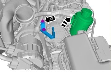

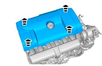

I attached four pictures for you to see. Pictures 1, 2, and 3 show what is required to remove the belt. Picture 4 shows the AC compressor. Before you do this, I would recommend disconnecting the battery.

If the issue is an internally failed compressor and not just the clutch you will likely need a few more parts. That is because the internal parts will usually chew themselves up and the small pieces end up going into the lines and other parts as the system starts to fail. At the very least a full flushing of the system is needed. Usually though you end up replacing most of the system to be sure everything is gone and you don't destroy the new compressor. There are line filters you could install as well to keep the metal out but they are not real common items.
I would probably see if it is the clutch bearing only that has failed (you should be able to rotate the compressor shaft bolt if it is the clutch bearing. If it doesn't move then plan on more work.

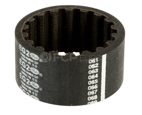

Just to add to it, the alternator does have a separate belt since the read unit is what drives the alternator.It is a very small round belt (See image below). The power steering and A/C compressor are driven by another belt in back of the engine. A seized A/C compressor can cause the engine not to turn over. As stated earlier, remove the A/C belt to see if it turns over normally.
Feb 20, 2019 at 4:35 PM
