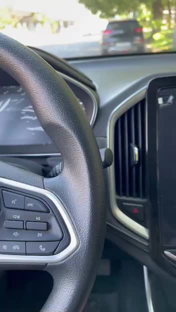

i push start button once holding the break pedal, Car cranks and dashboard turns ON and car Starts well.
Problem is, sometimes at anytime, i push start button holding the break pedal then Car cranks, but Dashboard never turns ON, obviously Engine never starts because car stays off power for few minutes.
Then suddenly after 1-2minutes dashboard turns ON itself, i can hear fuel pump working, lights working, door locks working, so now i can hold break pedal and turn Engine ON.
I tried to take this car to Chevy service 3 times, they return car back to me next day, saying al is fine, never tell me the exact problem, Car runs well for few weeks, then again this problem happens.
Car goes to sleep when push star button clicked, ACC works well because Audio is activated, but ON mode goes to sleep for few minutes and turns on itself. By the way while car sleeps,noticed on dashboard only lock pad red symbol is solid ON, not flashing just solid, actually i never seen it flashing.
