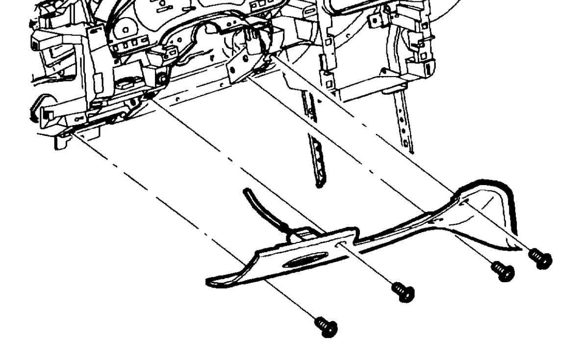

The security light stays on even after trying relearn and car will not start. Now the DRL lights flash repeatedly when trying to start it.

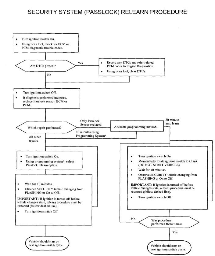

However did you try doing the full relearn three or four times? I have seen it before where it took four times to make it work.
What was the initial issue? Put the key in and the light came on and no start? If yes the common failure is the Passlock sensor itself. Replacing that requires the relearn process only, no scan tool, however the sensor is part of the switch housing and requires much of the steering column be taken apart to change it out. Part is - ACDelco 21060165

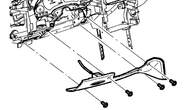

Remove lower steering column trim panel. (image 3) Book says to remove the hood latch cable and set the cover out of the way. If you're careful you can just slide it up out of the way.

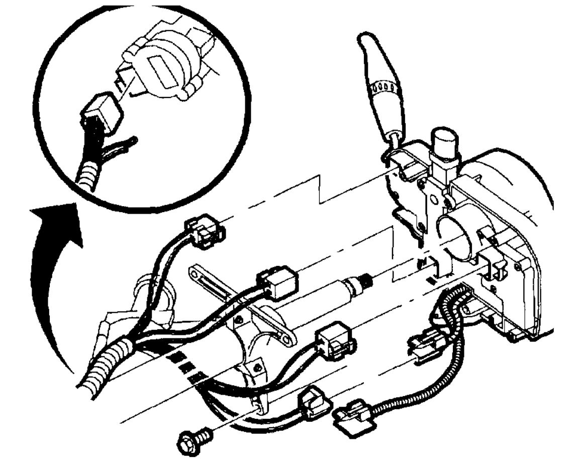

Remove the multi-function switch assembly (image 4) It bolts to the support/ignition module housing.
Disconnect the ignition switch connector as a precaution. In case there is any stray voltage.
On vehicles with automatic transmissions, disconnect park lock cable from ignition module.
Disconnect pass lock sensor connector from ignition module.

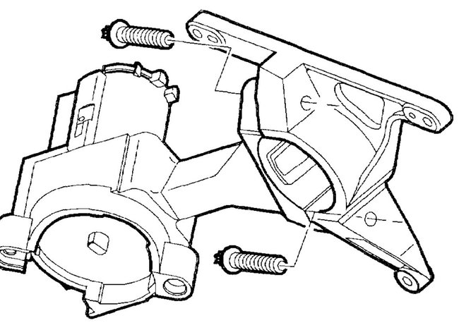

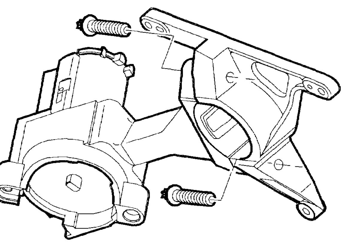

There are two shear bolts that you need to remove, a sharp chisel and hammer are usually all you need to make them loosen. (image 5) Then remove them.
Remove the housing. Reverse the process to install the replacement. Most come with new shear bolts. Just tighten them until the head shears off.
Reconnect everything and then perform the relearn procedure.
