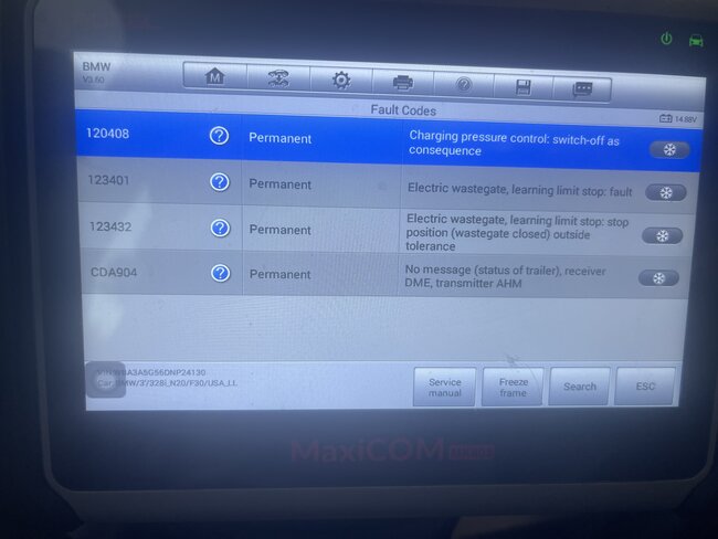

Car drives fine but i get the drivetrain malfunction message keeps popping up, but no effect on how it drives.

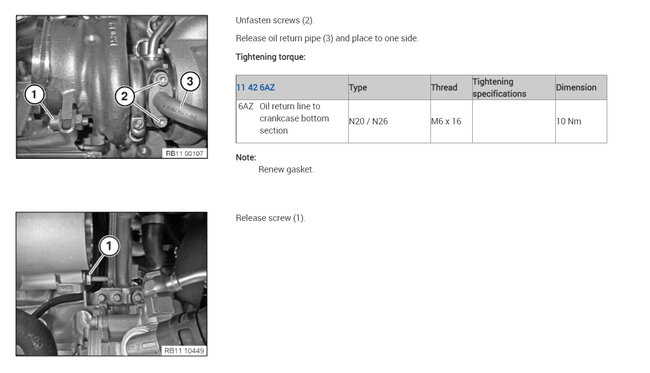

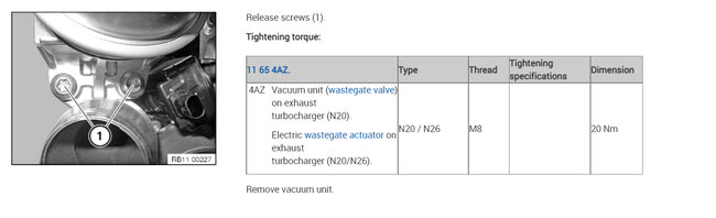

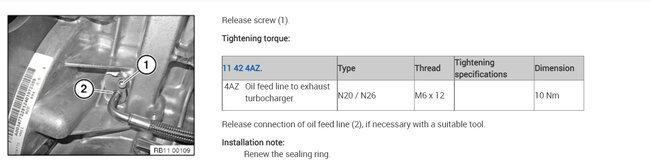

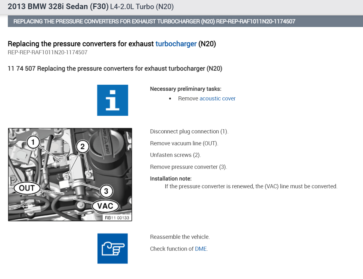

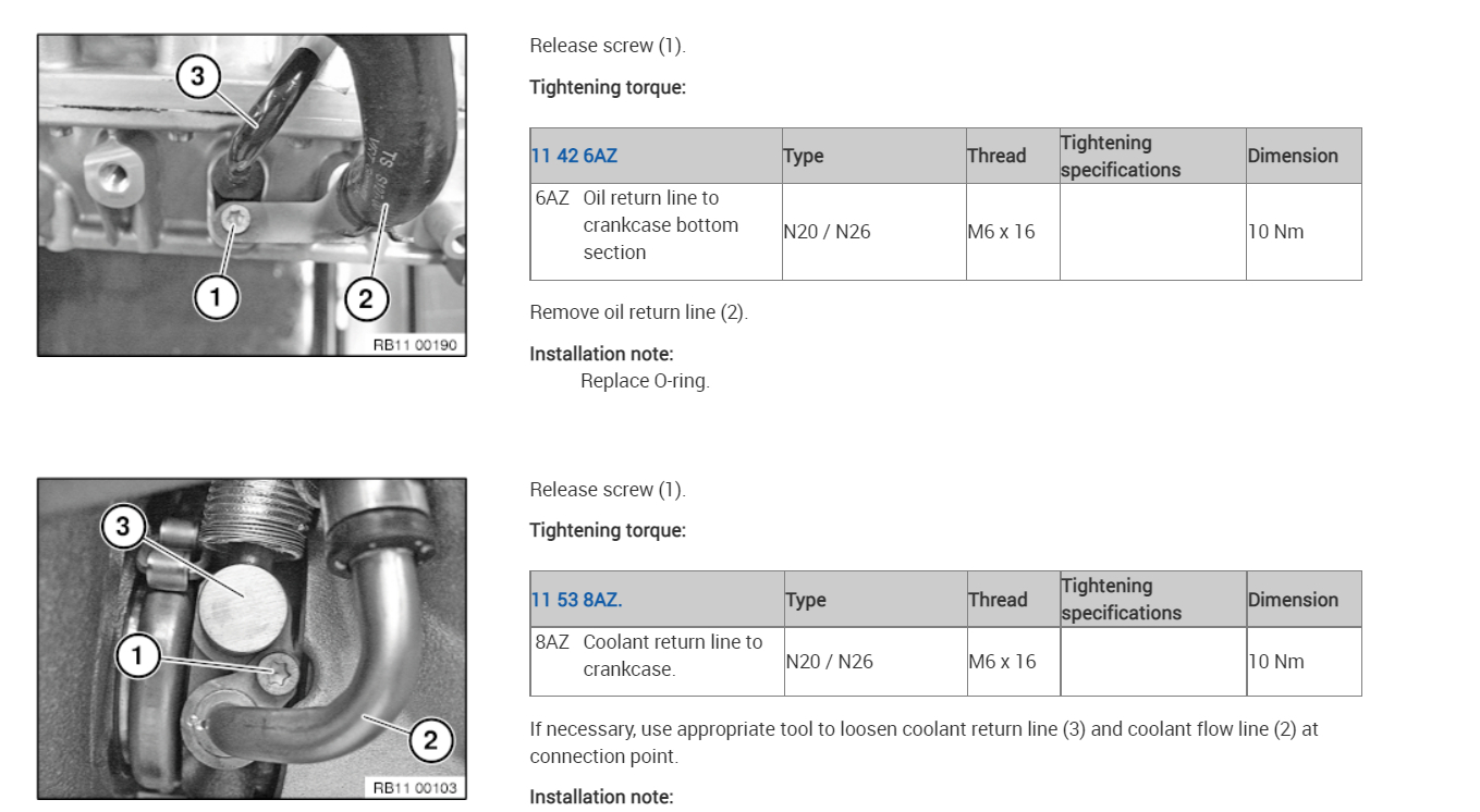

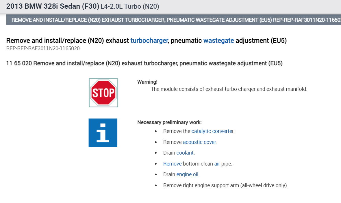

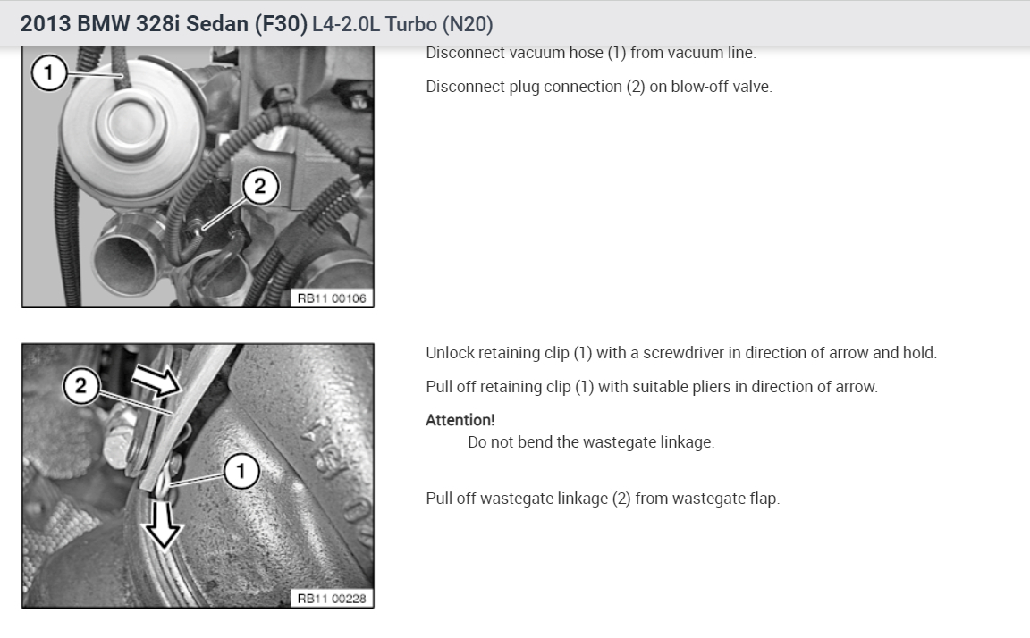

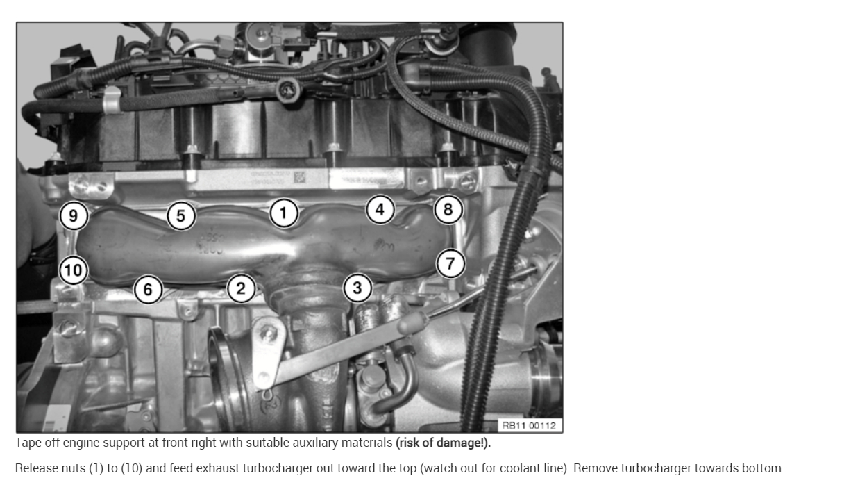

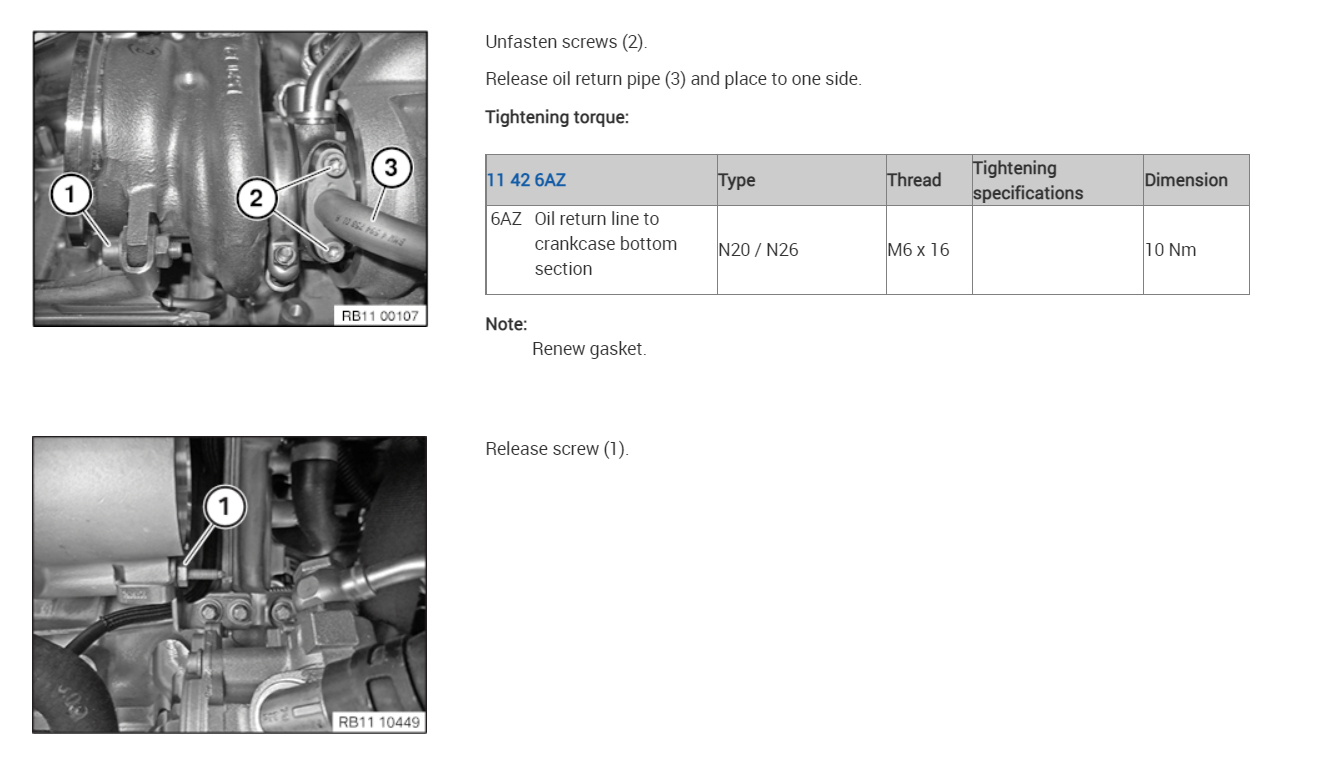

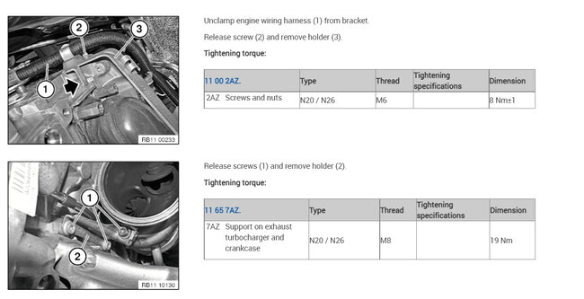

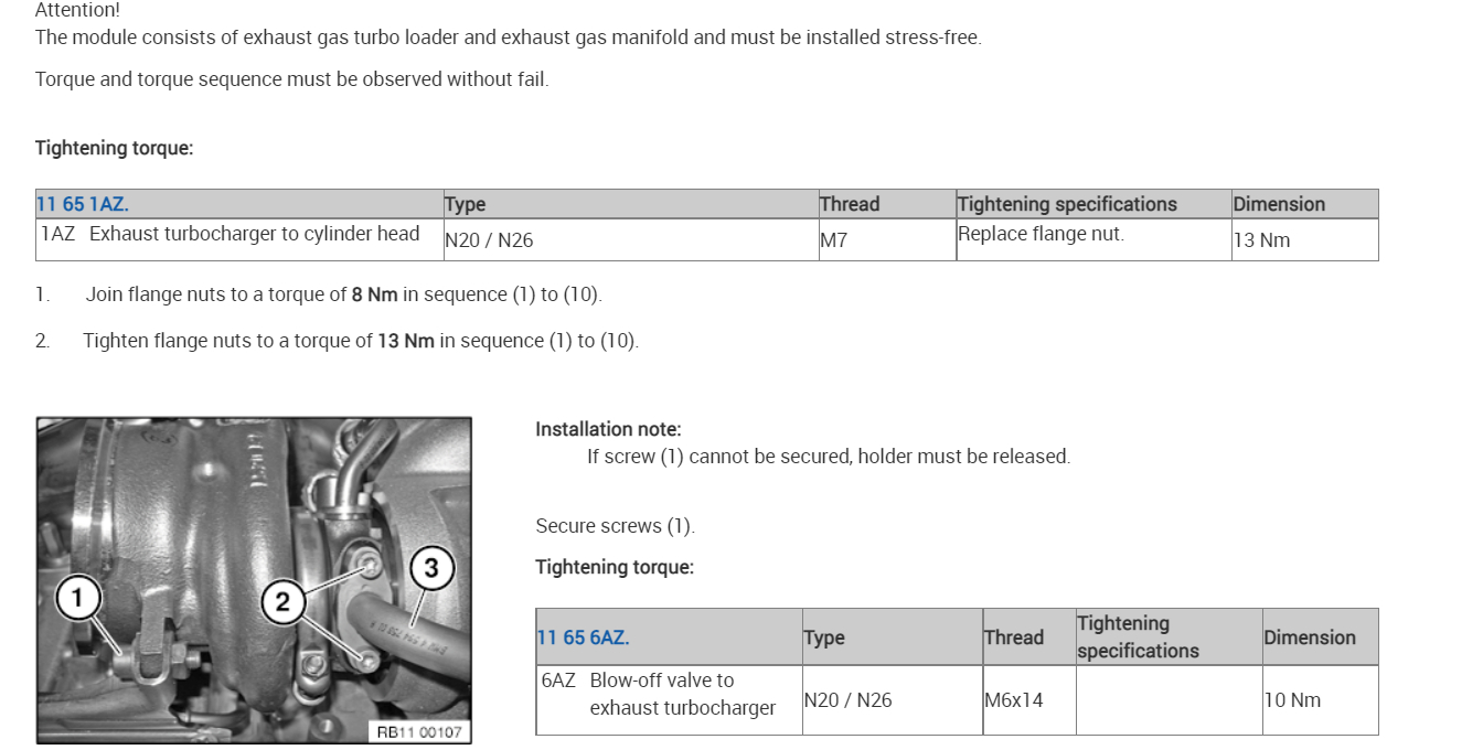

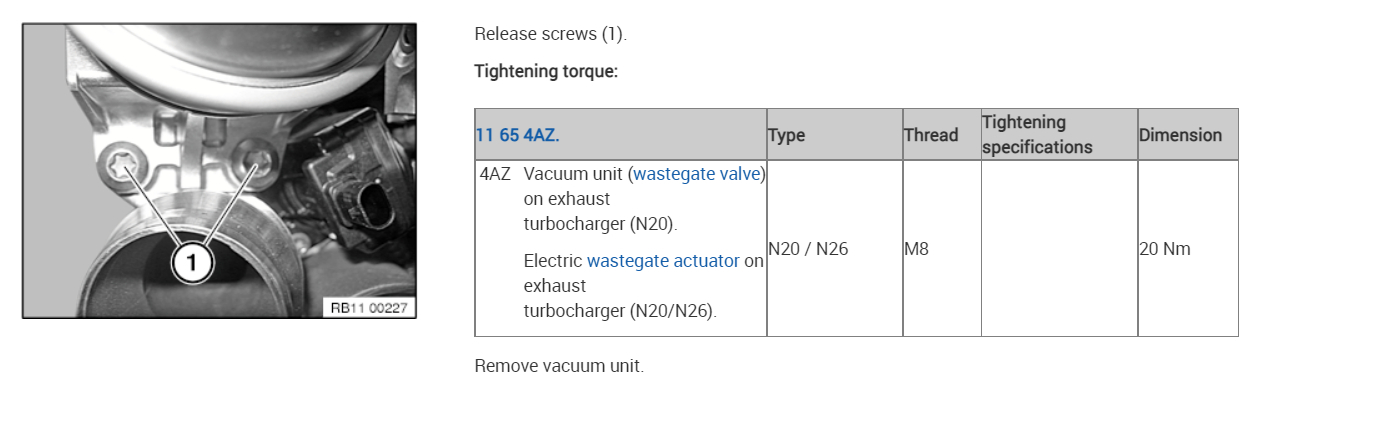

Yep, the wastegate code should affect the engine power but it looks like it is not working. I would check the vacuum lines to the valve and if okay, replace the wastegate. Here are the instructions in the images below. Also check the actuator control solenoid. Check out the images (below). Let us know what happens and please upload pictures or videos of the problem.

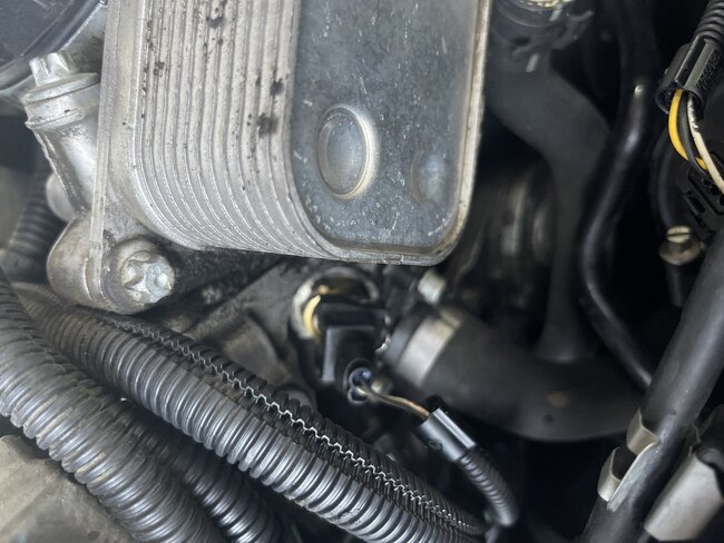

Is this what reads the coolant temperature? Was not there before i changed valve cover.
Oct 29, 2022 at 8:23 AM
  • 55,402 POSTS
Yes, that is the coolant temperature sensor. Did you change out the turbo? They go bad all the time in these cars.

I just adjusted the rod length on the turbo actuator and message went away was too loose.
