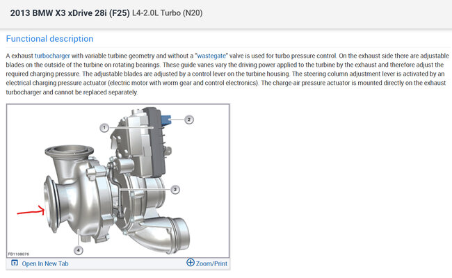

When i start it up no misfire but there is a noise. I scanned it and came back with these codes

I am not aware of an EGR on these cars and there is no way these are ignition coils as it is pointing to all cylinders.

Can you upload a short video of the noise? Does the engine have a mechanical issue? These cars had problems with the turbo at about 100k. If the turbo falls apart it will affect all cylinders as the exhaust leaks into the intake. Is this the noise you hear? I would remove the intake or exhaust side to check the turbo endplay. Check out the images (below). Let us know how it goes.

How would the exhaust leak into the intake? Am not getting that point.

And I am familiar with turbo issues on these. It's not the turbo for sure. I'll see if i can make a video.

Yep, if a turbo falls apart it can allow an intake leak because the main shaft is not sealed anymore, but I can say this is not your problem after checking the videos. The noise it is making seems more like the high-pressure fuel pump or the camshaft lobe that drives it might be bad; Lets remove the pump for inspection.
