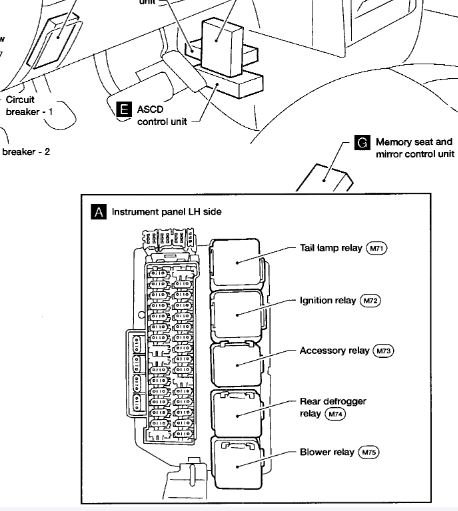

The radio, heater, AC, and wipers do not seem to be working at all. Seems connected somehow.
Thanks
Jan 21, 2019 at 2:18 AM
STEVE W.
  • 15,349 POSTS
Looking at the wiring the common items for those looks to be the accessory relay located in the fuse block in the dash and the ignition switch itself. They both have power feeds for the items you are having a problem with. I would probably start with the relay. It looks like the defroster relay is the same part number so swapping those should be an easy way to test if it's the relay. See image for locations.
When you say the heat A/C doesn't work, do you mean you hear no blower motor or is the controller in the dash out as well?
Jan 21, 2019 at 2:26 PM
MIKETKACH
  • 19 POSTS
Actually what happened today is everything started working. Then the radio and wipers stopped working. Then I turned off the key and when I turned it back on they were back. So it is weird.
Thanks
Jan 22, 2019 at 9:32 AM
STEVE W.
  • 15,349 POSTS
That would indicate it is likely an issue in the ignition switch then. However the only way to be sure would be to catch it in the "bad" condition and do nothing but turn the key on/off and see what it does. Intermittent problems are always a nightmare as you cannot test for the problem that isn't there.

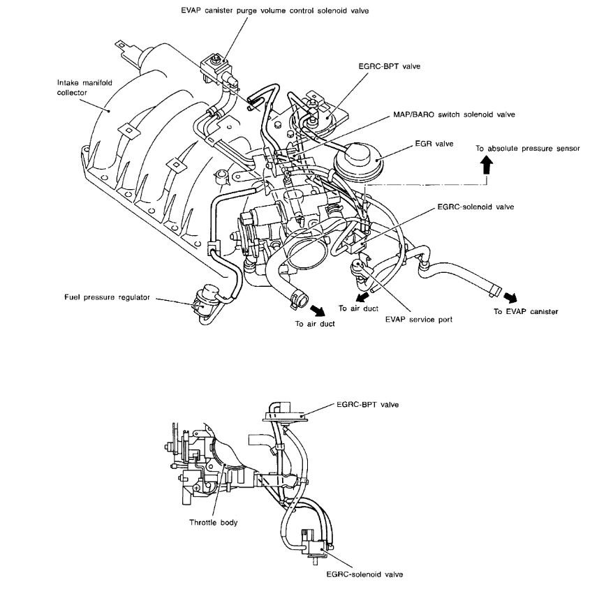

Btw, I'm also removing the intake manifold to replace valve cover gaskets. I have everything off except there's a metal hose coming from I believe the exhaust and into this thing attached to the back of manifold. It attaches to a metal housing that looks like it held on by 1 bolt and a stud that has no bolt but seems like maybe an adjustment screw because it has a square end. Does that sound familiar at all.
Thanks
Jan 23, 2019 at 8:41 AM
STEVE W.
  • 15,349 POSTS
Take a look at the picture and see if anything looks familiar. The description sounds like the EGR / BPT valve. It's a one way valve that keeps the exhaust gasses from entering the system except when the EGR valve is in operation. It keeps the hot gasses from damaging anything by staying in the lines with no place to go.
Jan 23, 2019 at 10:01 AM
MIKETKACH
  • 19 POSTS
Yes it does except mine has a tube on the area below the egr valve. I'm gonna attempt removing it today.

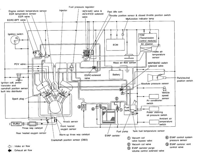

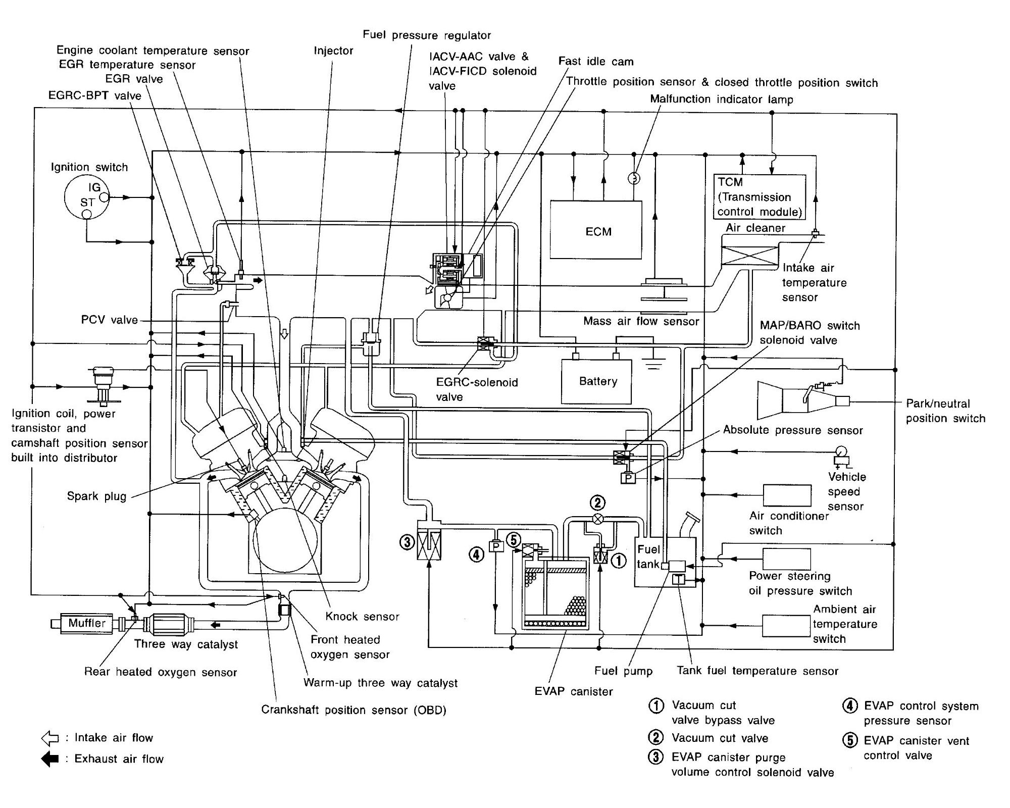

Yeah, I finally got the intake manifold off. It was in fact the valve cover leaking. I've replaced several hoses making them slightly longer which helps in reassembly. Can you send me a hose routing schematic? I am almost positive about where all hoses go but one. Cant seem to find a hose for one location.
Thanks
Jan 27, 2019 at 5:57 AM
STEVE W.
  • 15,349 POSTS
These are the diagrams Nissan has. First is for the Federal emissions second is the California version. Check the data sticker to be sure which yours is.
