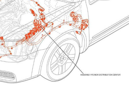

The first thing I would do is check the battery for 12 volts, this guide can show you how,
If the voltage is low and the battery is over 4 years old get a new one and install it, then remove the serpentine belt and spin the alternator to make sure it is not binding or grinding, this is a sign the alternator is bad and needs to be replaced as well. If both of these check out I would scan the car because I have seen the TIPM go out and cause this issue as well. You can get a used one from ebay and swap it out, also check the battery cable ends to make sure they are clean and secure.
Here is the TIPM location in case you need to replace it. Check out the images (below). Please upload an image or a short video in your response, so I can see what's going on.
