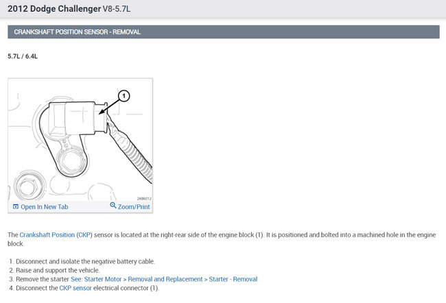

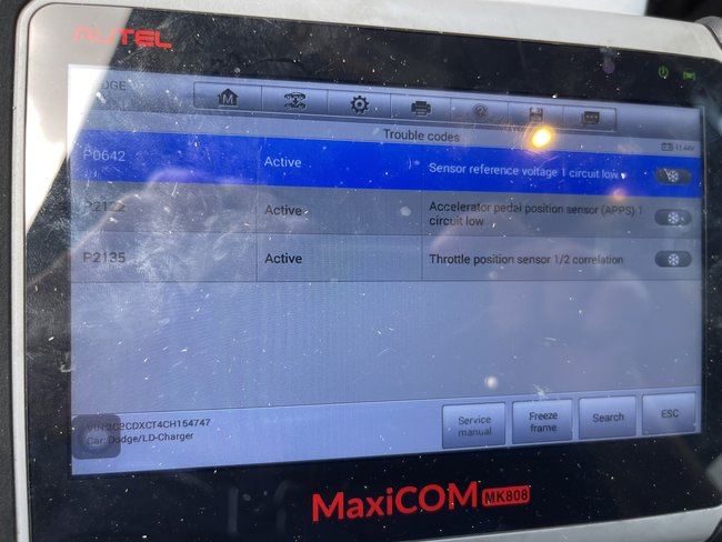

Bought it as is, takes 3-4 long starts before it fires up. Rough idle, no throttle response.
Has these codes:
P335 Crank position sensor
P642 Sensor ref voltage
P0118 Engine temperature sensor
P2122 Throttle sensor
P2135 Throttle sensor a/b volt correlation
Does not smoke, has enough oil and coolant.
I also may have seen the common code on many US built cars for the oil pressure sensor maybe p0520 if am not mistaken, but i saw that first time i saw the car i think.

Okay, lets clear the codes and then turn the key on without starting the engine and then run the codes, this will give us the hard code that we should start at first, it may have a bad PCM with these kinds of codes, I also would do a CAN scan which is easy, you can get a CAN scanner from Amazon for about $30.00.
https://youtu.be/u-4syLc-ifQ
Here is a scanner link:
https://amzn.to/3o41KcZ

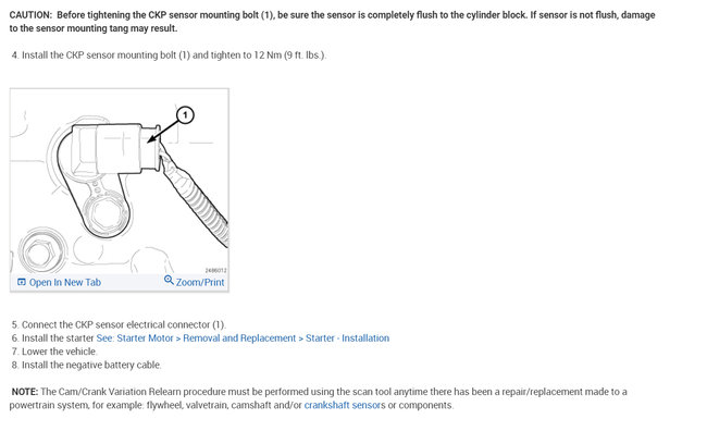

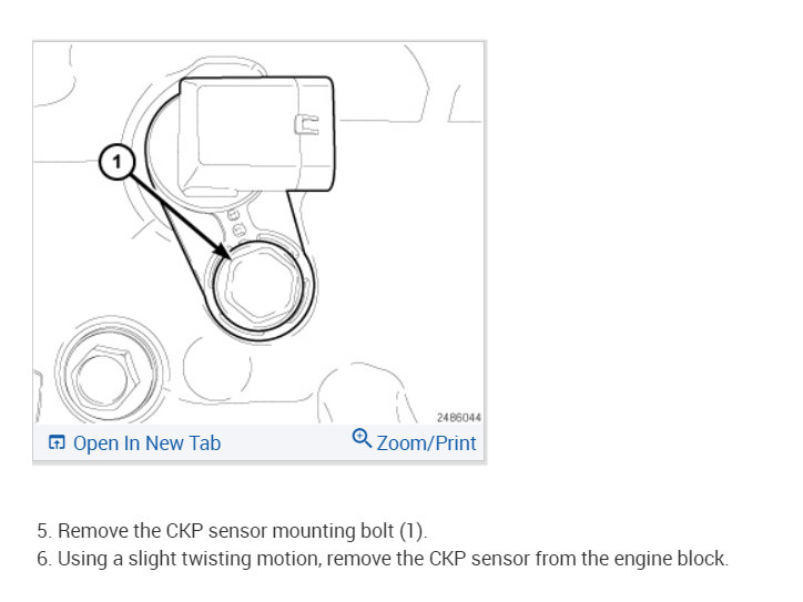

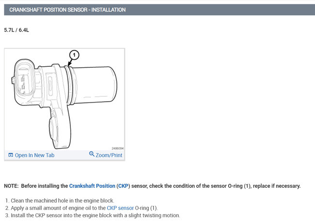

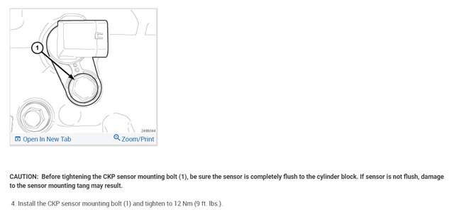

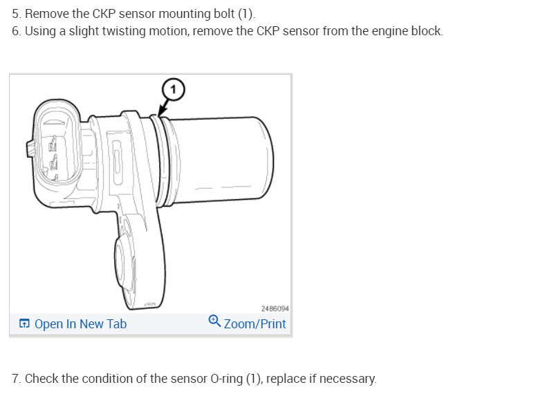

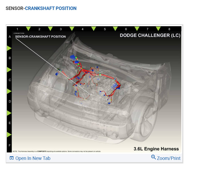

I would service throttle body and replace the crankshaft sensor first.
Here is a guide and the crankshaft sensor location in the diagrams below:

Scanned it, deleted codes and rescanned and got.

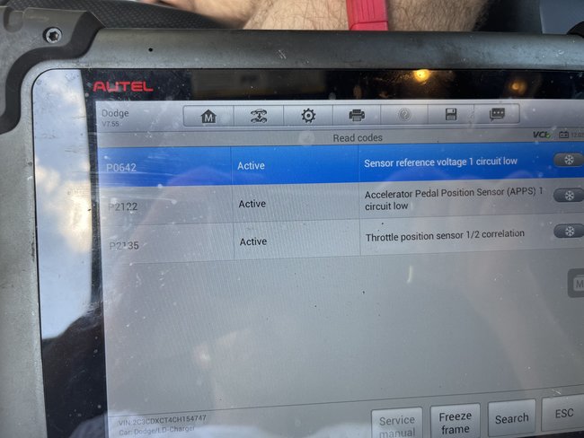

I am replacing the battery as its struggling. I also used my buddy's throttle body and the idle is much better but throttle light still flashing and still have the same three codes.

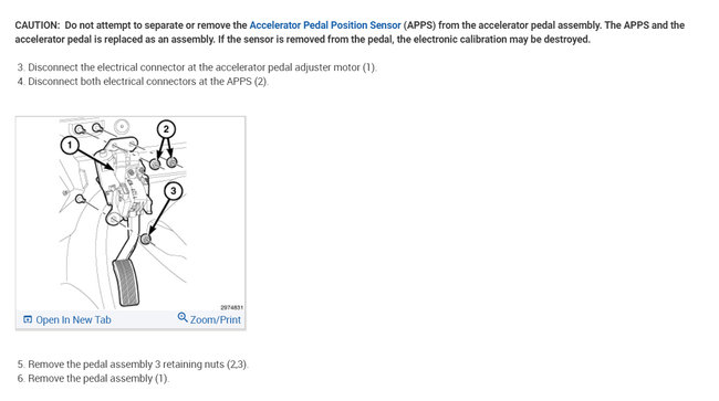

Nice work, I would replace the throttle pedal position sensor which is under the dash by the throttle pedal. Here are the instructions in the diagrams below. It says you cannot separate the pedal from the sensor so it must come as one unit. Check out the diagrams (below). Please let us know what happens.

I replaced it still no response from it. Lots of videos show that CPS can create such symptoms, is it possible it is related to that? Because it's the first code that keeps popping up.

Replaced CPS, all good, unreal what these sensors can do.
