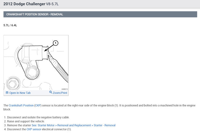

Okay, lets clear the codes and then turn the key on without starting the engine and then run the codes, this will give us the hard code that we should start at first, it may have a bad PCM with these kinds of codes, I also would do a CAN scan which is easy, you can get a CAN scanner from Amazon for about $30.00.
https://youtu.be/u-4syLc-ifQ
Here is a scanner link:
https://amzn.to/3o41KcZ

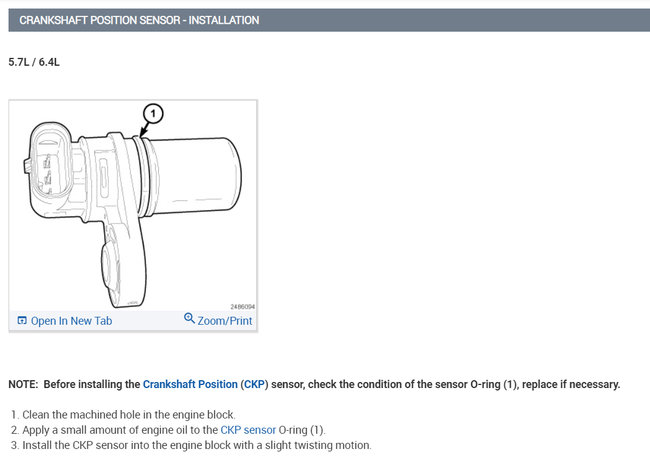

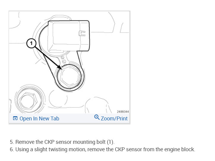

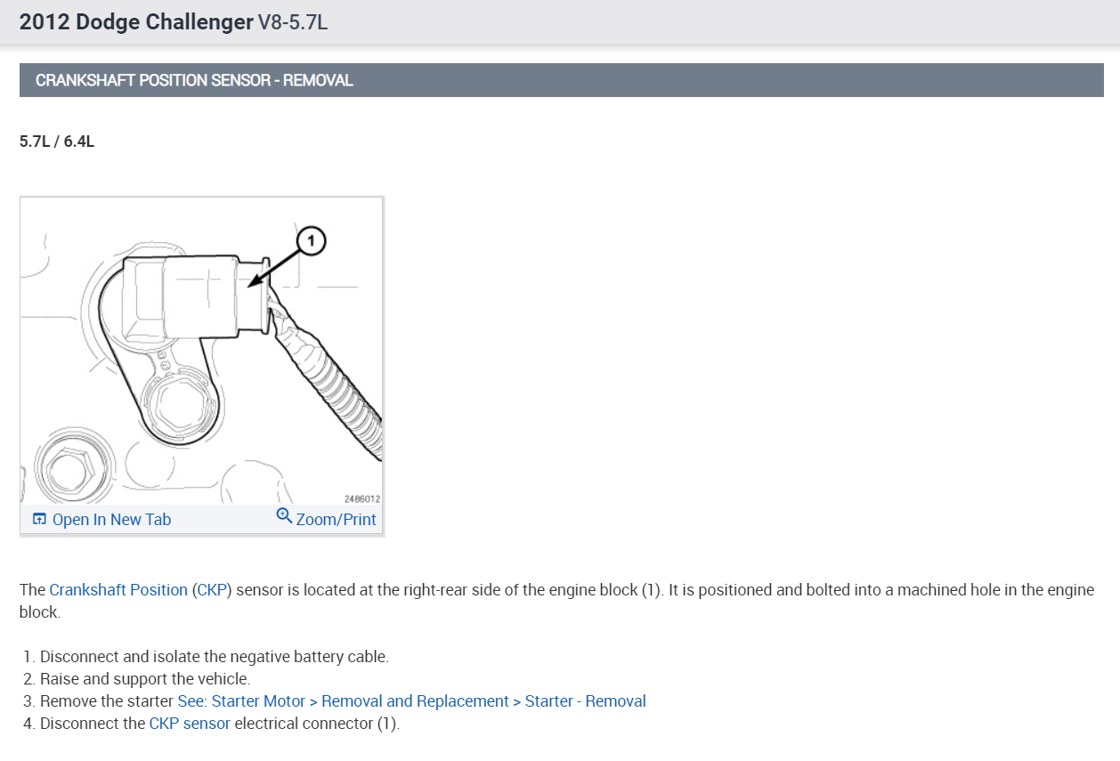

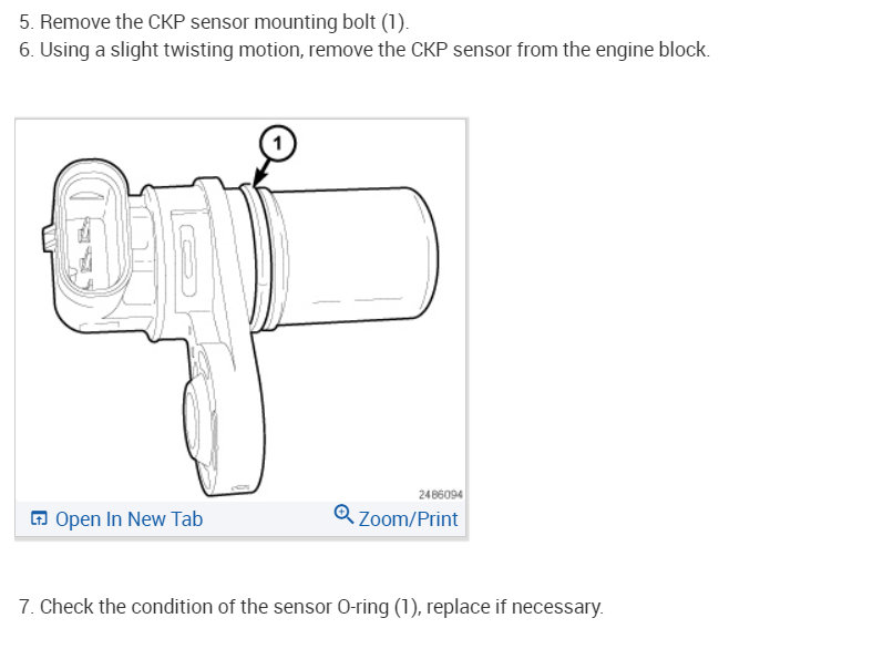

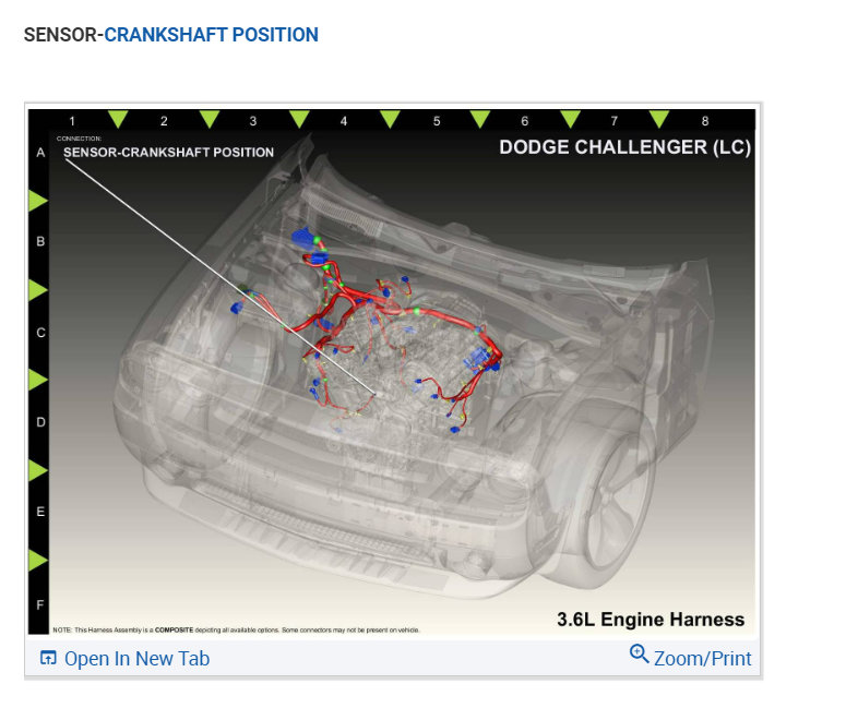

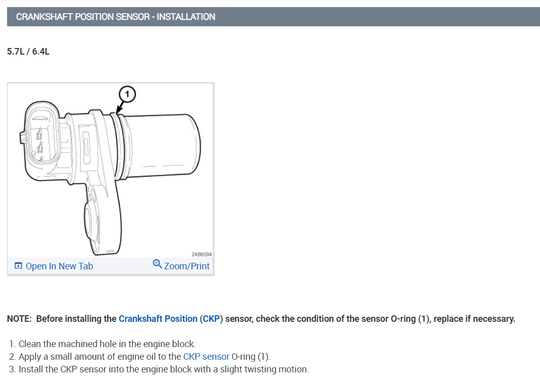

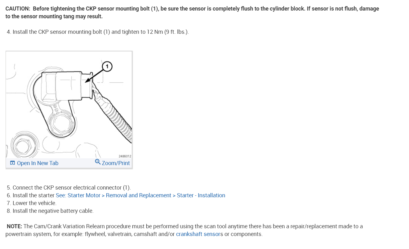

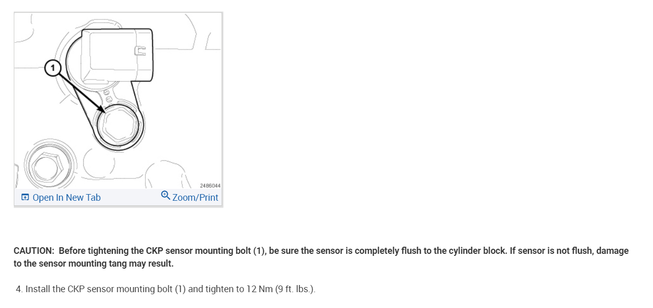

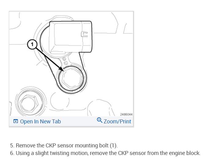

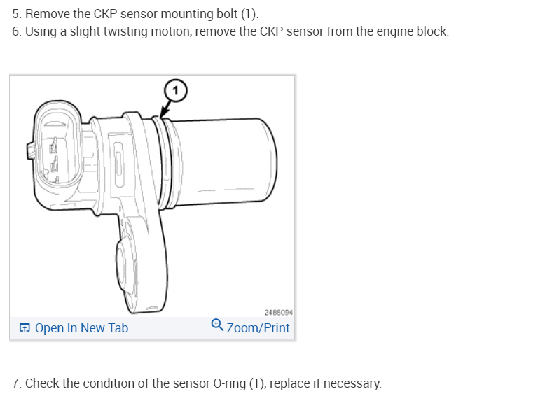

I would service throttle body and replace the crankshaft sensor first.
Here is a guide and the crankshaft sensor location in the diagrams below:

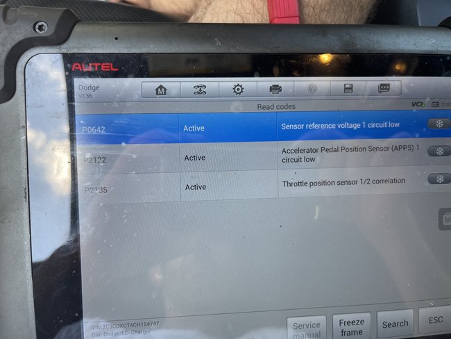

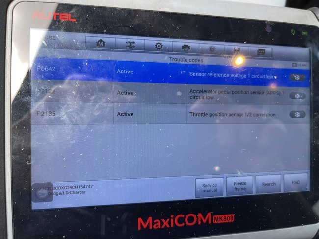

Scanned it, deleted codes and rescanned and got.

I am replacing the battery as its struggling. I also used my buddy's throttle body and the idle is much better but throttle light still flashing and still have the same three codes.

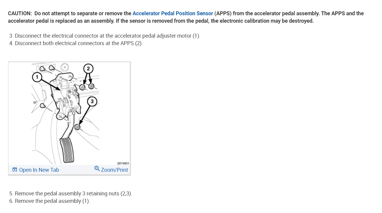

Nice work, I would replace the throttle pedal position sensor which is under the dash by the throttle pedal. Here are the instructions in the diagrams below. It says you cannot separate the pedal from the sensor so it must come as one unit. Check out the diagrams (below). Please let us know what happens.
Jul 28, 2022 at 3:02 AM
BHAMDOC1973
  • 2,007 POSTS
I replaced it still no response from it. Lots of videos show that CPS can create such symptoms, is it possible it is related to that? Because it's the first code that keeps popping up.
Jul 28, 2022 at 3:03 AM
  • 55,402 POSTS
Yep, that was my next suggestion have you replaced it yet?
Jul 29, 2022 at 2:32 AM
BHAMDOC1973
  • 2,007 POSTS
Ordered an OEM one still waiting. Many reported issues with aftermarket.
Jul 29, 2022 at 2:35 AM
  • 55,402 POSTS
Okay, I have seen that too, let me know.
Jul 30, 2022 at 5:39 AM
BHAMDOC1973
  • 2,007 POSTS
Replaced CPS, all good, unreal what these sensors can do.
Aug 1, 2022 at 9:56 AM
BHAMDOC1973
  • 2,007 POSTS
But the sensor had oil on it, is that normal?
Aug 1, 2022 at 12:14 PM
  • 55,402 POSTS
Yes, that is normal, it is amazing how these Sensors computerized car work, we are learning something new all the time.
