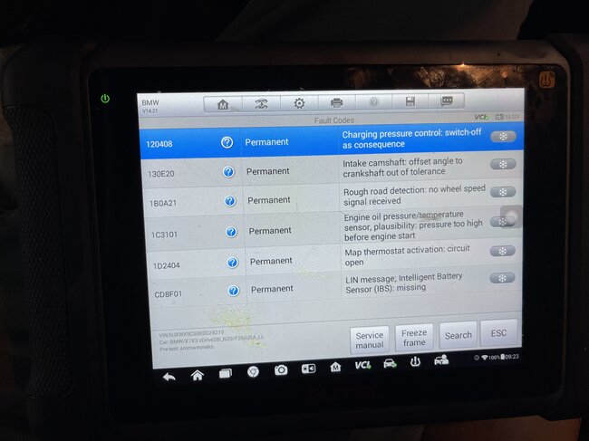

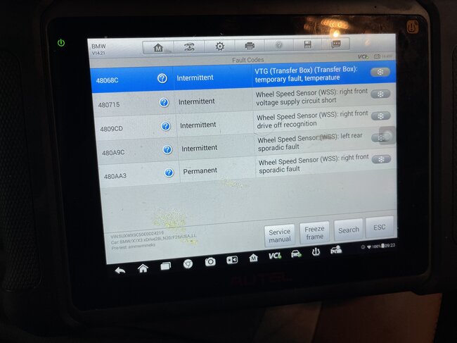

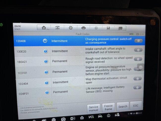

Bought it as is. Throttle has zero response on revving motor. Starts but had many codes. Deleted them and even before starting the cars the 2nd picture on engine module shows the codes. There are abs codes as well but those are maybe for the ABS sensors which is common and i can take care off. Sometimes runs and stalls.

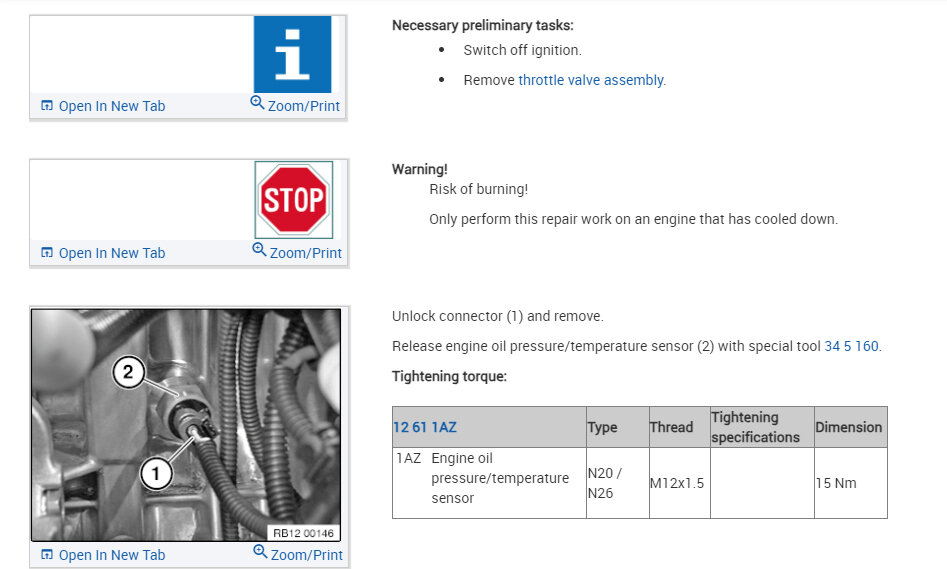

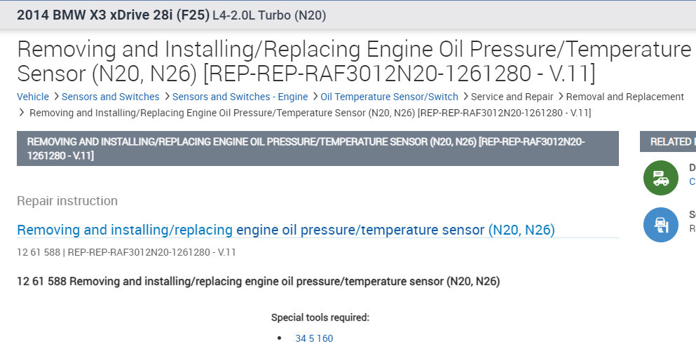

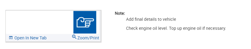

I looked at the codes you have. I suspect the oil pressure (too high before starting) is causing the limp mode issue. The pressure can't be too high with the engine off, so suspect there is a short in the wiring to the pressure/temperature sensor or the sensor itself has shorted internally.
I attached the directions below for replacing the sensor. Before you replace it, confirm the wiring is in good condition. Also, with the key on, confirm there is a 5v power supply to it.
Let me know what you find.

Where is it under the intake?
Sep 14, 2023 at 11:07 PM
  • 110,244 POSTS

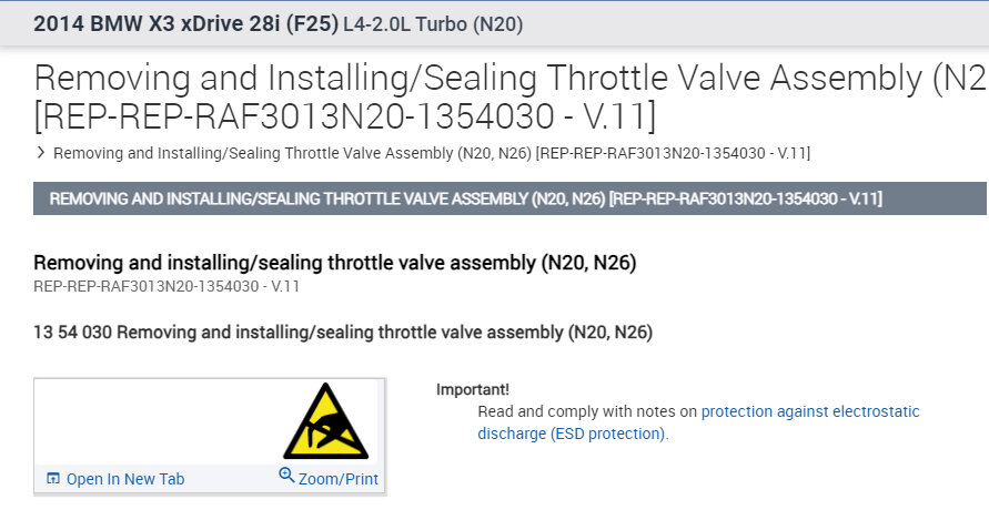

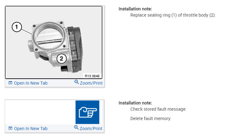

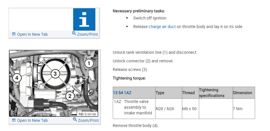

According to the directions, it is under the throttle body. They never like to make things easy.
If you look below, I attached the directions for removing the throttle body.
Let me know if this helps.

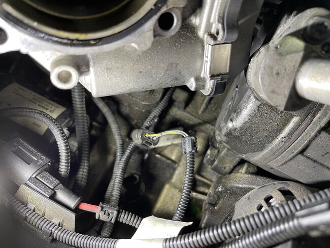

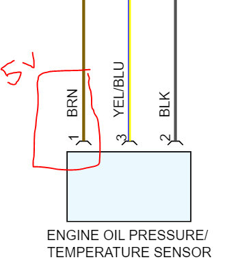

I removed the throttle body and i can see one sensor attached to the block which has 3 wires to it. Is that possibly it? I unplugged it so you can see it. If so, which wire should have a 5v with ignition on and what is the part number, please?
Sep 24, 2023 at 12:08 AM
  • 110,244 POSTS
It should be a brown wire. The other two will be black and one yellow with a blue tracer. See pic below.

Yes, there is a 5v on one with ignition on.
Sep 24, 2023 at 6:17 AM
  • 110,244 POSTS
If you have the power supply, the black wire should provide a ground path. Check to see if there is continuity to ground via that wire.
If you do, suspect the sensor is faulty.
Sep 24, 2023 at 6:48 AM
BHAMDOC1973
  • 2,007 POSTS
Yes has ground.
Sep 24, 2023 at 8:03 AM
  • 110,244 POSTS
If we have power and ground, chances are the sensor itself is faulty and isn't sending a correct signal.
If you have gotten this far, I would replace it before reinstalling the throttle body. Hopefully that is the issue.

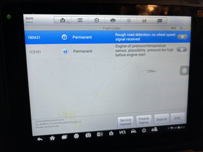

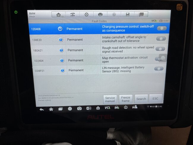

Replaced the sensor and started it after deleting all codes. Still no response or barely any from gas pedal. Have these codes now.
Sep 29, 2023 at 8:46 AM
  • 110,244 POSTS
When you say little to no response from the throttle, can you record it and upload it for me to see and hear? The one code, 120408, is usually caused by something internal. We may need to check the timing chain. Something is causing the intake cam sensor code.
