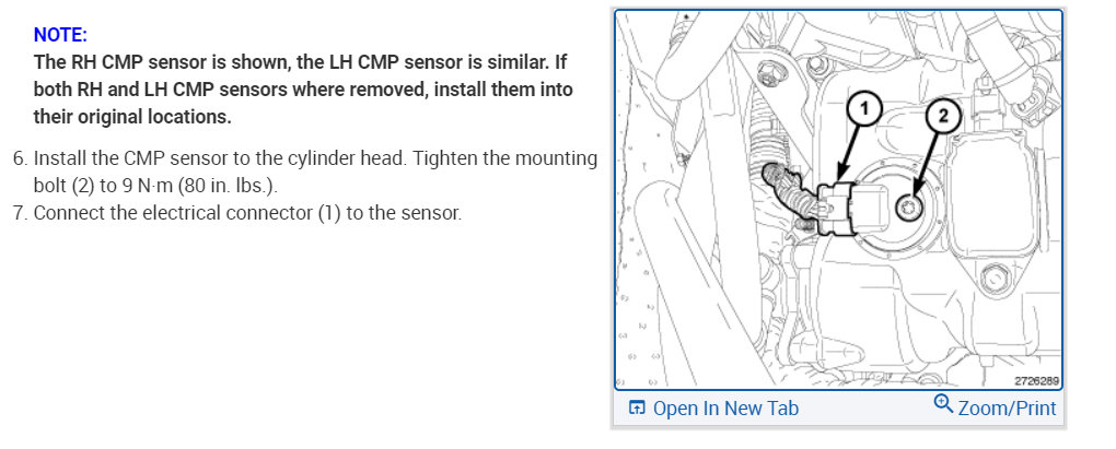

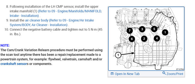

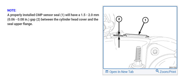

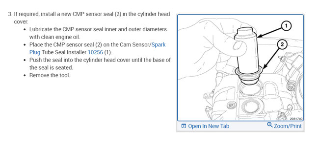

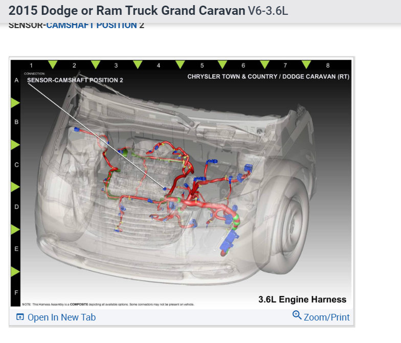

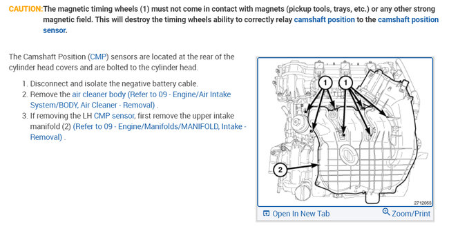

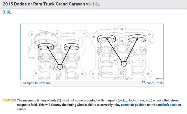

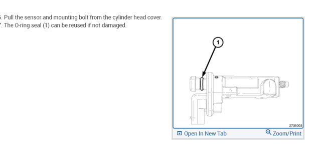

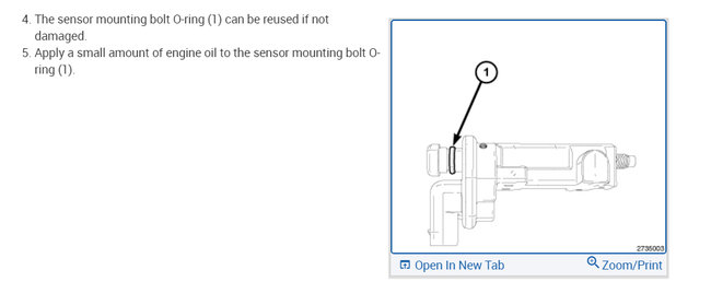

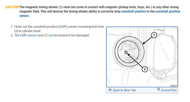

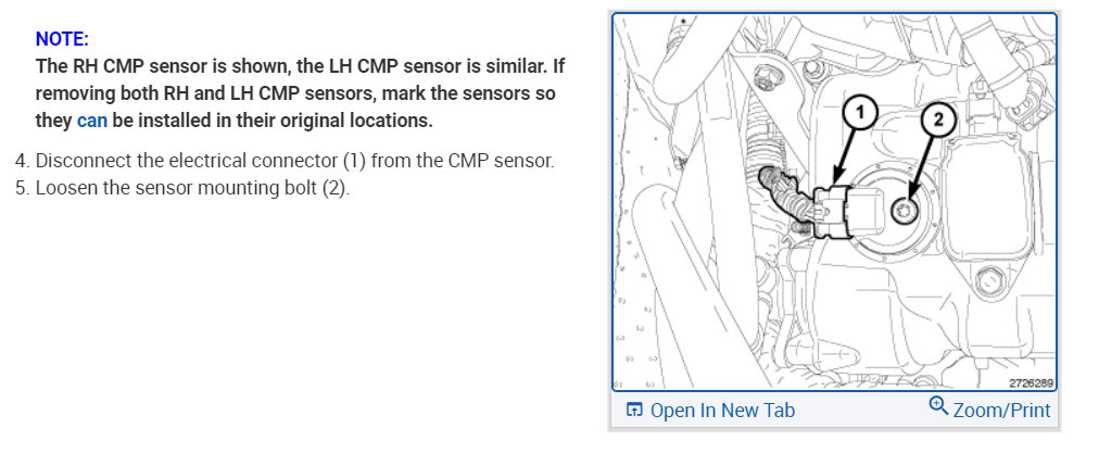

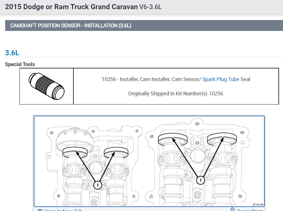

Okay got it, the other codes are for the camshaft sensor, so we should replace that. Also, can you look inside the engine to see if the oil changes have been done? Remove the oil fill cap and use a flashlight to see the rocker valley. Here is the sensor location so you can change it out. Check out the diagrams (below). Please let us know what happens. I would consider the oil pump pick up being clogged as well.

Removed valve covers, 2 rockers were bad, replaced. Replaced the oil filter/cooler assembly, manifold gasket, valve cover gaskets, fresh oil and mounts. Cleaned all camshaft sensors, all good after put together. Thanks
